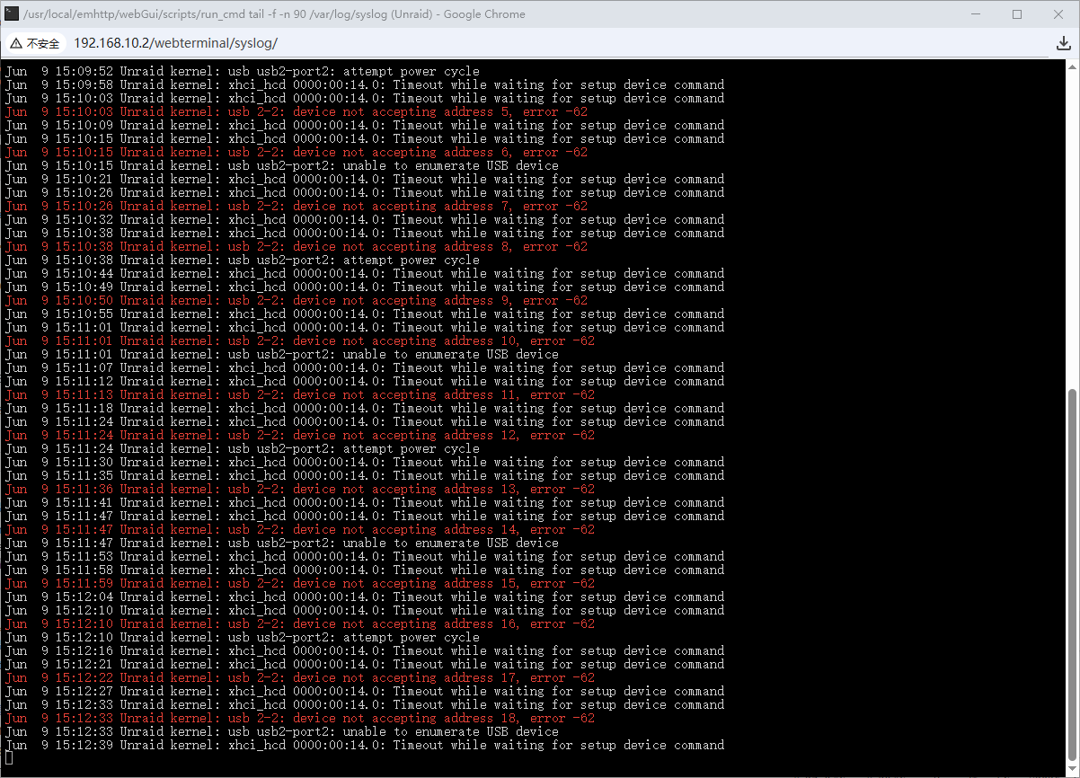

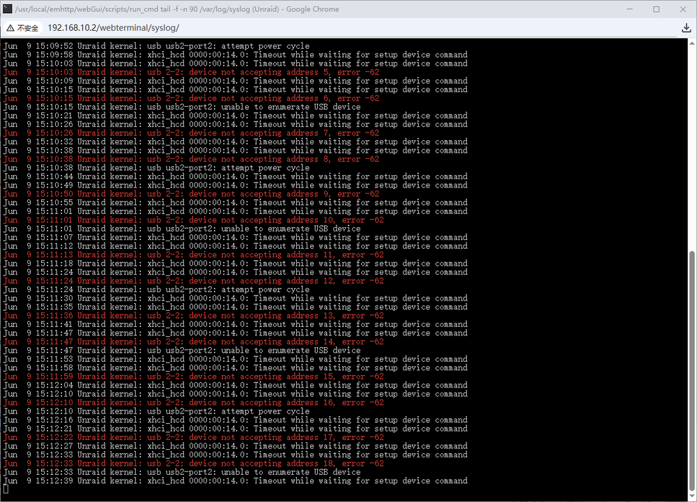

今天又发现unraid的奇葩问题,开机后进去webui卡很久才有响应。
我先回个贴,我暂时的解决方案是,进到bois把usb3.0的第二号通道禁用。已经运行一个多星期,你们试试卸载connect 看看能不能解决这个问题
Help: USB errors in system log, WebUI is very lag
I think I've resolved the issue for now. I disabled USB 3.0 in the motherboard BIOS, restarted into Unraid, and there are no more error messages in the logs. The webUI is also no longer lagging. I tested the motherboard's coin battery as well, and it seems to be working normally. This issue feels quite strange, as I’ve never encountered anything like it before.
Help: USB errors causing WebUI lag – CMOS reset no longer works, BIOS time keeps changing After clearing the CMOS used to fix the issue, but now it no longer helps. I've also noticed that the BIOS time is not matching the actual time. I tried manually correcting it, but as soon as I boot into Unraid and then go back into BIOS, the time is off again. Whenever this issue occurs, the WebUI becomes very sluggish and unresponsive. Additionally, I don't know what device "usb2-2" refers to. I’ve already unplugged all USB devices from the system. Does anyone have any idea what might be causing these USB errors and the time drift? Any help would be greatly appreciated!
Hello, the problem is still occurring. Whenever this USB error log appears, my WebUI becomes very laggy. I restarted and entered BIOS, and found that the system time is indeed different from the actual time. How can I resolve this issue? Also, I don't know what the device "usb2-2" is — could it be the PCI wireless network card on the motherboard? My motherboard model is MSI MAG B760M MORTAR WIFI DDR5.
I checked the timestamps in the logs, and the server time was correct. The same issue occurred again yesterday — the WebUI was very sluggish. This time, I took screenshots of the logs, and the error messages were the same as before. Instead of clearing the CMOS this time, I unplugged the power cord and removed all USB devices. After waiting for about three minutes, I powered it back on, and everything worked fine again. I’ve read some articles suggesting that this might be related to USB power delivery — since my Unraid system isn’t running 24/7, there might still be residual power supplied to the USB ports when it’s shut down. While this hasn’t been an issue before, I’m wondering if it could be related to a kernel update or bug?
如题,今天发现进webui 主界面的docker和vm卡很久才出来,网页一直转圈圈,卡很久才出来,单独点击docker或者vm也是一样,像断了网一样或者延迟很高,第一时间感觉是U盘坏了,因为之前也试过,但回家后立刻换了备用U盘上去,发现一样的情况。然后我不启动序列,就没卡了,排查了很久,没找到问题,我无意间看到卡webui可能跟内存有关系,我果断只用一条去试,还是一样,没办法了,我就试着清除CMOS了,然后启动后我发现 不卡了,非常丝滑。真的很奇葩啊。
