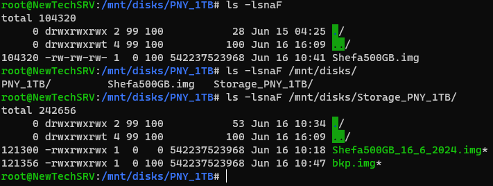

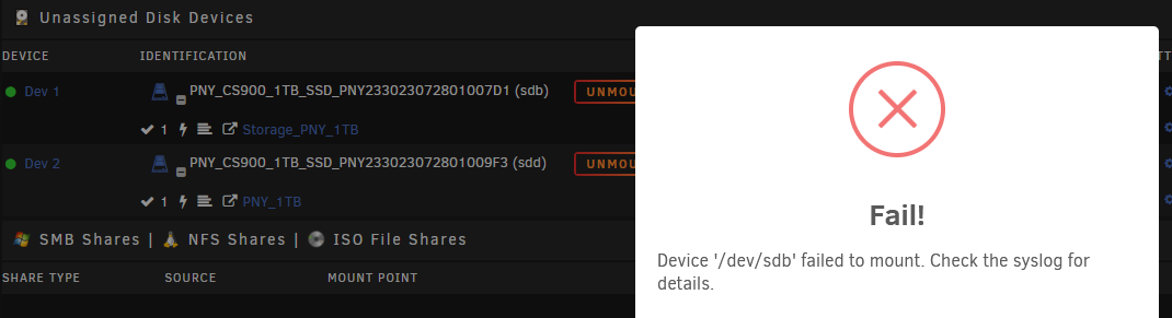

  17. the .img is in the share PNY_1TB, unless i am totally lost? here is df -h root@NewTechSRV:~# df -h Filesystem Size Used Avail Use% Mounted on rootfs 63G 1.1G 62G 2% / tmpfs 32M 1000K 32M 4% /run /dev/sda1 30G 404M 29G 2% /boot overlay 63G 1.1G 62G 2% /lib/firmware overlay 63G 1.1G 62G 2% /lib/modules devtmpfs 8.0M 0 8.0M 0% /dev tmpfs 63G 0 63G 0% /dev/shm cgroup_root 8.0M 0 8.0M 0% /sys/fs/cgroup tmpfs 128M 27M 102M 21% /var/log tmpfs 1.0M 1.0M 0 100% /mnt/disks tmpfs 1.0M 0 1.0M 0% /mnt/remotes tmpfs 1.0M 0 1.0M 0% /mnt/addons tmpfs 1.0M 0 1.0M 0% /mnt/rootshare /dev/md1 932G 466G 466G 51% /mnt/disk1 /dev/md2 932G 80G 852G 9% /mnt/disk2 /dev/nvme0n1p1 932G 266G 665G 29% /mnt/firstvmbtrfs /dev/nvme4n1p1 932G 281G 650G 31% /mnt/secondvmbtrfs shfs 1.9T 546G 1.3T 30% /mnt/user0 shfs 1.9T 546G 1.3T 30% /mnt/user /dev/loop2 20G 11G 9.1G 55% /var/lib/docker /dev/loop3 1.0G 7.3M 902M 1% /etc/libvirt /dev/sdd1 932G 6.7G 925G 1% /mnt/disks/PNY_1TB /dev/sdb1 932G 6.7G 925G 1% /mnt/disks/Storage_PNY_1TB tmpfs 13G 0 13G 0% /run/user/0 root@NewTechSRV:~# Edit: Oh i see what youre saying , that is because i did a cp into /mnt/disks by mistake , i saw it , but didnt fix it or remove it or touched it because i couldnt mount the proper disk that is supposed to be mounted to VM. i did cp /mnt/disks/PNY_1TB/xxx.img /mnt/disks/ which was a mistake.

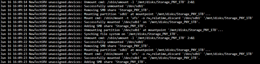

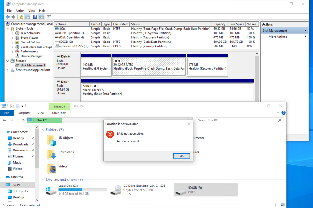

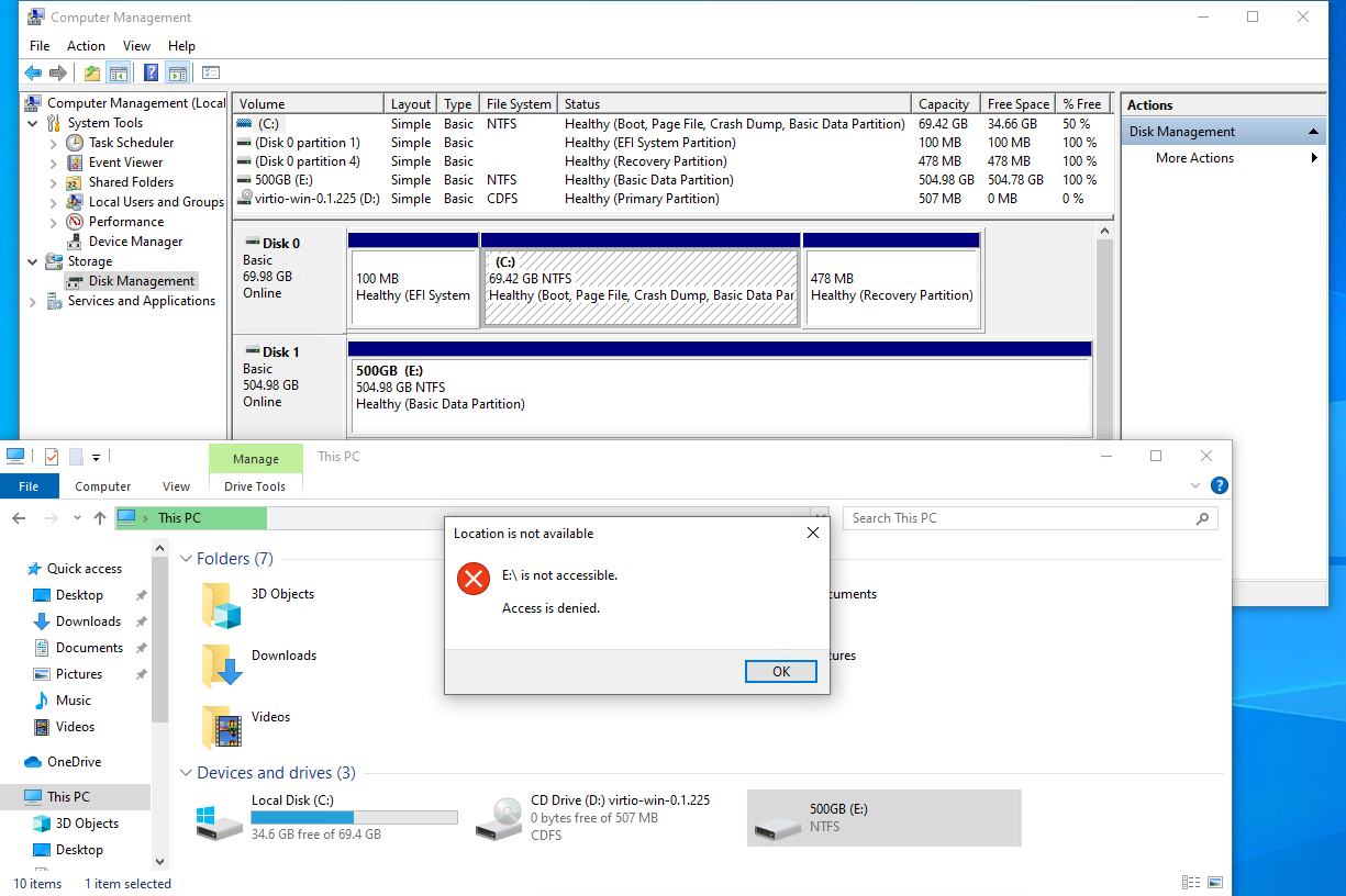

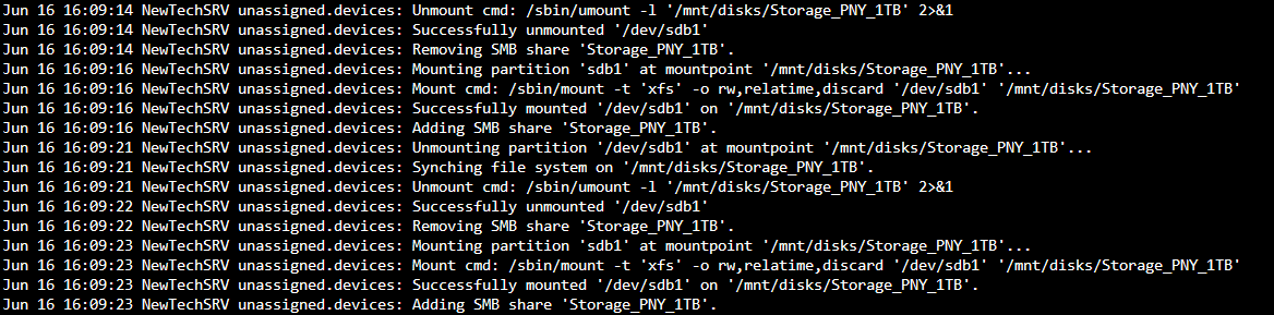

  18. Hello people , i am in dire need for help. Ive used VMs for like 4 years with unraid now , but only recently have i created a disk.img(500GB) on unassigned ssd(1TB) , and attached it to the VM as secondary disk. it all worked fine for months, untill today i got the "Access denied - drive inaccessible" when trying to access the disk from windows(screen1). I did make a backup of the disk , and tried to change owner and all that in windows to get the permissions, but its the same issue. The server did not reboot , the vm i did reboot , but i also tried attaching the disk to the other VM, and its the same issue. all i did over the time is CP /mnt/disks/UDDevice1Share /mnt/disks/UDDevice2Share for backups. but its the same issue with the backups now. Also there is an error when mounting those UD devices , but i assumed its some UI bug , and tested the data and also checked the logs and there was no errors(screen2,screen3) Is there anything i can do to get the data from the disk? Attaching unraid diag , and UD Diag files. Unraid-diagnostics-20240616-1552.zip ud_diagnostics-20240616-155125.zip
