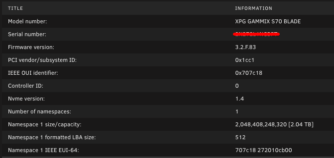

NVME Drive falling out of pool and system event
Hi!, I did use the boot initrd option, which seemed to have helped. nvme_core.default_ps_max_latency_us=0
The unraid server suddenly became inaccessible on March 3 at 9:30pm, with logs indicating kernel errors.
Hi, I seem to have fallen victim to the same ill fate. Woke up this morning to find the server unresponsive. I had to force a reboot for the OS to come back online.
Splash started following NVME Drive falling out of pool and system event
I dont have the drives (I have in RAID1 BTRFS) being dropped by the UnRaid OS, but I do see a lot of these in my dmesg logs. I am also going to try the kernel option to see if it helps. [320250.699810] nvme 0000:03:00.0: VPD access failed. This is likely a firmware bug on this device. Contact the card vendor for a firmware update [320250.829812] nvme 0000:06:00.0: VPD access failed. This is likely a firmware bug on this device. Contact the card vendor for a firmware update
