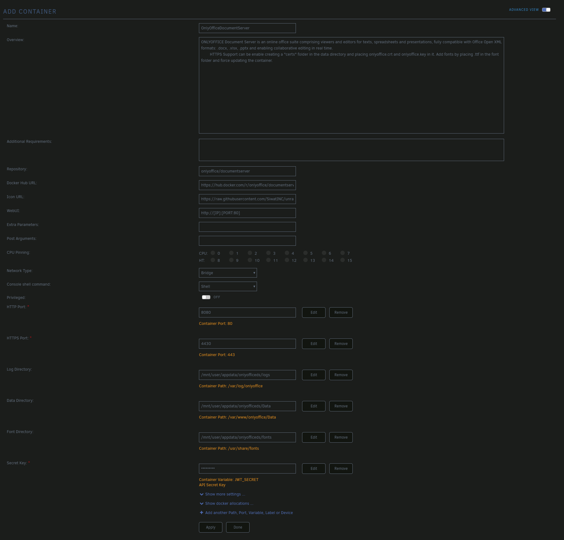

Hi Siwat2545, I can not see the database directory path section anymore in the template. I have uninstalled my pervious version of OnlyOfficeDocumentServer and removed its image as well removed its persistent storage. Installing it again I'm faced with this template: No database directory path as far as I can see. 😞 Adding the data directory path manually as in @Wong recent post seems to fix it: Thanks for keeping your template up to date and alive. Much appreciated for sure mate. 😄

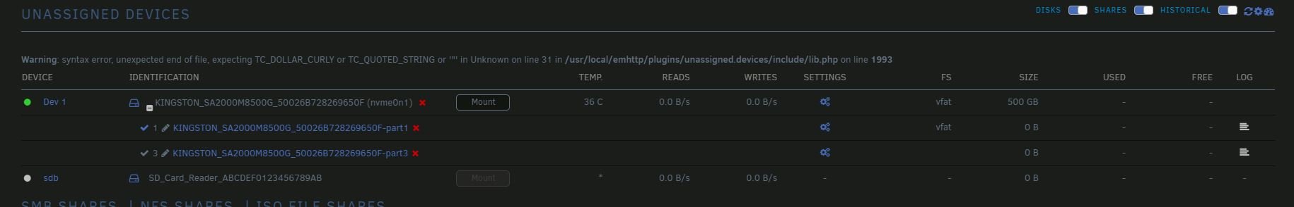

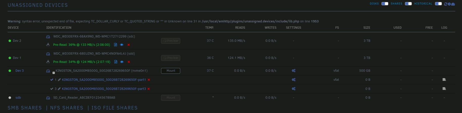

@dlandon Hi mate, I'm sorry to bother u again, but my issue is back with that warning message on the main page. I have uninstalled UD and UD+, then reinstalled them and still have the warning message. serverbrain3-diagnostics-20211230-2109.zip

@dlandon Ok, here are a new diagnostics as well as a new "unassigned.devices.ini". Let me know if this can be considered as closed as I have another possible issue for u if u like. unassigned.devices.ini serverbrain3-diagnostics-20211208-1634.zip

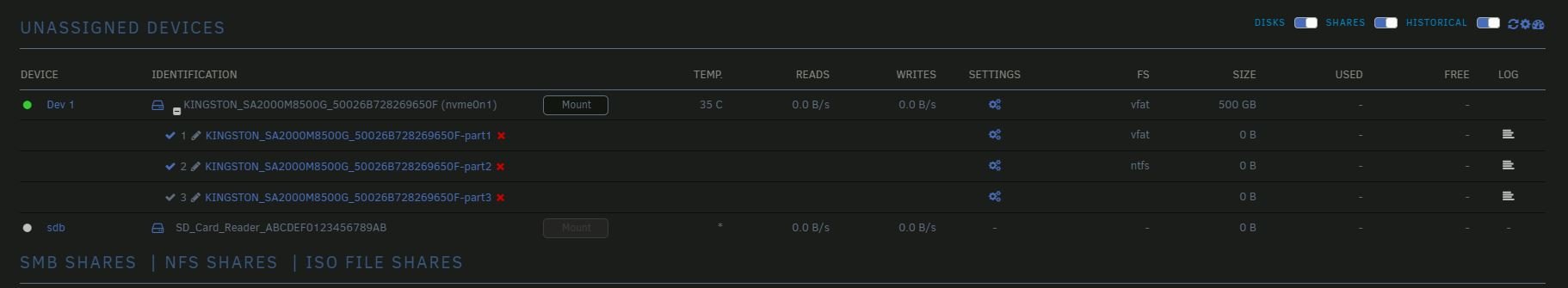

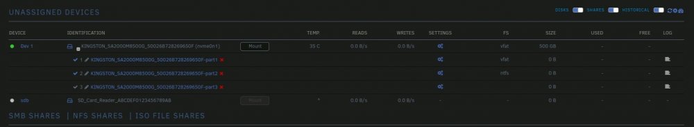

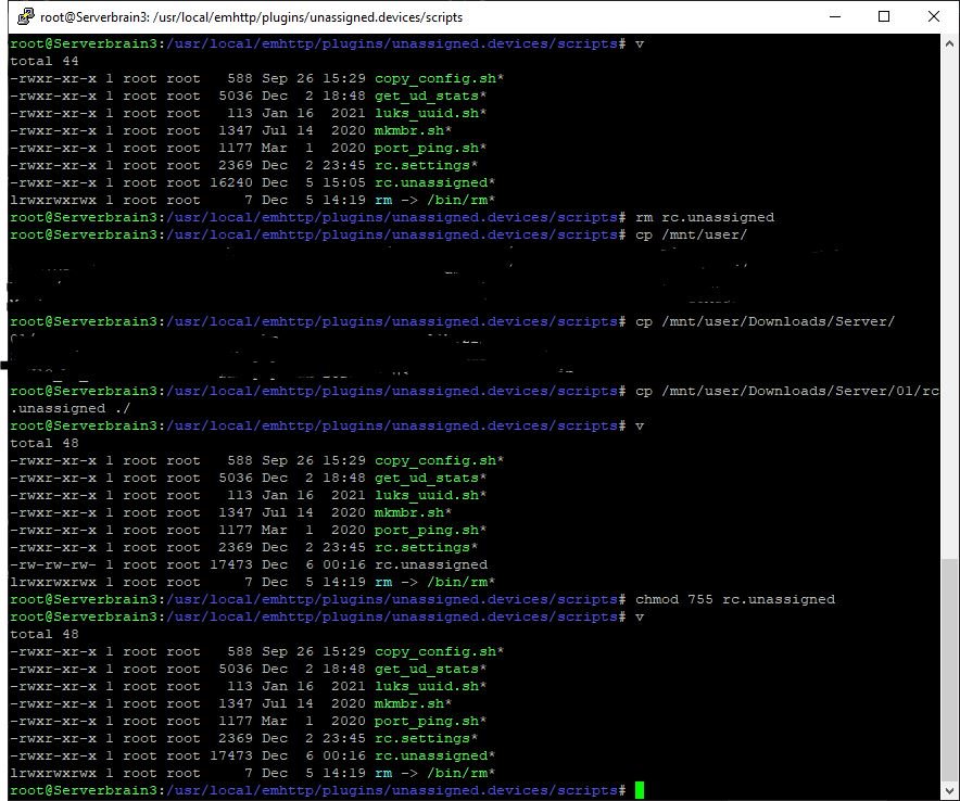

@dlandon Ok, finally the warning is gone from the main page. It disappeared as I refreshed the udev in step two in your instructions above. Running the mount cmd as you asked its still fine. Now all three partitions are also visual. Only 1 and 3 was visual earlier. Well done! :-D

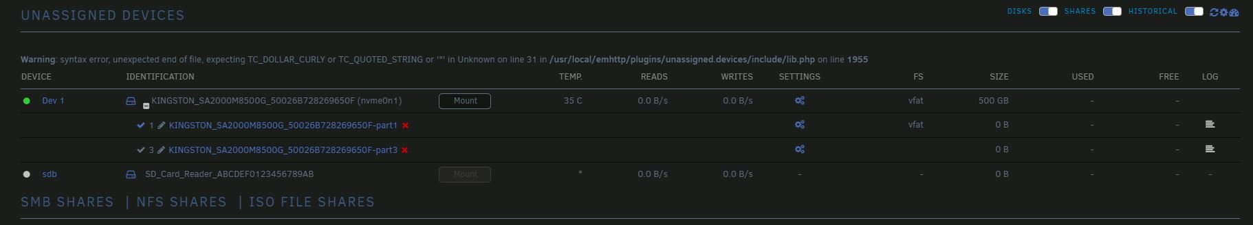

@dlandon Ok, I have updated UD to 2021.12.07. Warning still pressant. I have uninstalled the Pre Clear Disks plugin, rebooted the server. Warning still pressant. Attached is the "unassigned.devices.ini" you requested along with a new diagnostics taken post the actions taken described above as well as a scr dump showing the warning. 🙂 unassigned.devices.ini serverbrain3-diagnostics-20211208-1049.zip
@dlandon I'm pre-clearing two disks at the moment. I like to let that process finish before going a head with removing the pre-clear plugin. Sry 4 that. Will let u know a.s.a.p. when I have tried your suggested action, but it will be in one or two days.
@dlandon Ok, but its visual on the main page. The system has been booted post the latest update of the UD plugin and pre the diagnostics and the screen dump attached here.

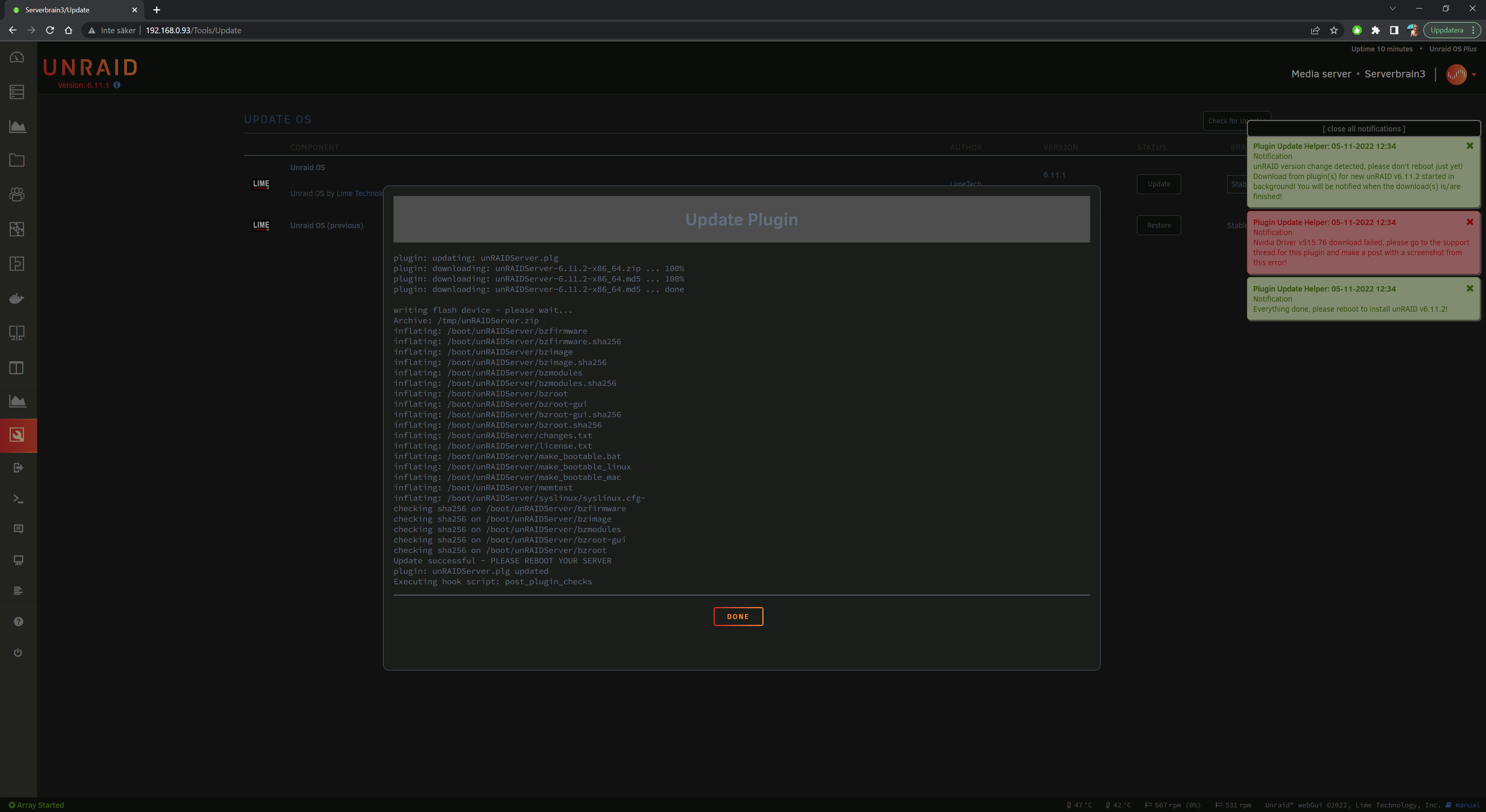

@dlandon I have installed the update and are now running UD 2021.12.06. Still having that warning message though. Diagnostics is attached. serverbrain3-diagnostics-20211207-0756_UD_2021.12.06.zip
@dlandon I'm sure I did as I downloaded it into a blank folder and unziped it there before removing the old file then copied the newly unzipped file to the specified location. I did not reboot though as I though the plugin refreshed itself loading the main page. was that a wrong assumption? I did reload the main page as well navigated away from it then back to it again. All before taking the diagnostics. I need to hit the sack as I need to get up and go to work in the morning (in 5 hours)... talk to u tomorrow...
