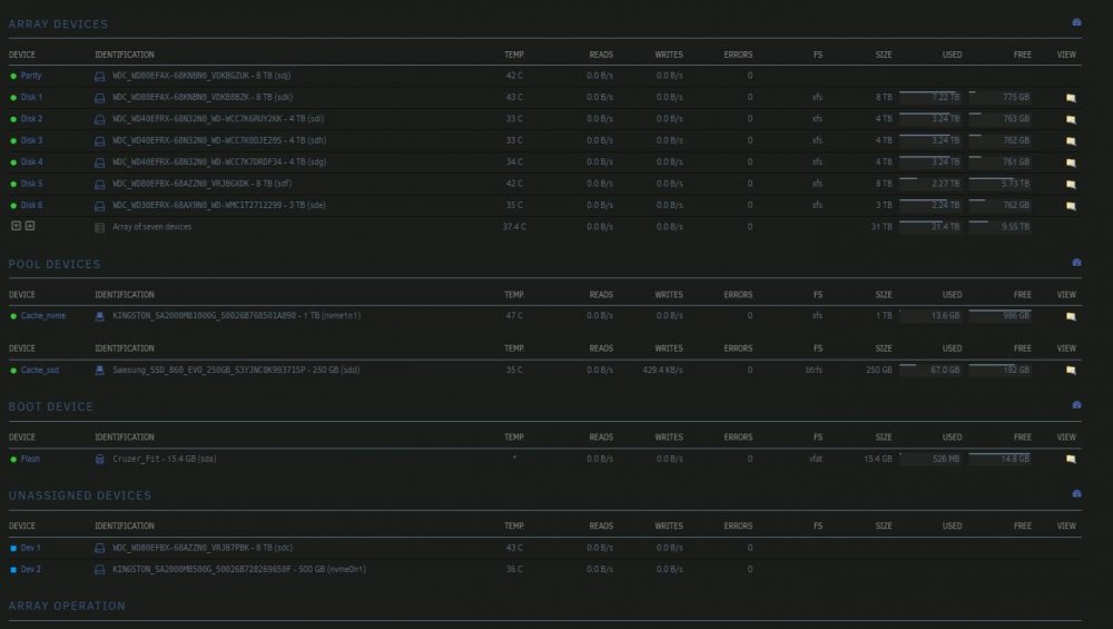

@dlandon Hi mate, I'm sorry to bother u again, but my issue is back with that warning message on the main page. I have uninstalled UD and UD+, then reinstalled them and still have the warning message. serverbrain3-diagnostics-20211230-2109.zip

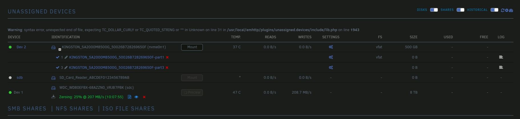

@dlandon WELL DONE!!! 😄 Ok, on to the next one then... I did do some rearranging in my array and as I replaced old disks with new ones then zeroed the old ones to then be re-added to the array. Yes, that might seem a bit odd but lets not go into "why". When I added the old disks as unassigned devices to delete the partition on each disk to then pre clear them, prior to re-attaching them to the array, I got an "failure" message in a popup on the main page stating that deleting the partition had failed. But id didn't irl. This behaviour was consistent for each of the two disks when I deleted the old xfs partitions. Unfortunately I have no screen dump from these two messages nor any other documentation on the issue. As I have now reached the maximum of 12 attached storage devices for my PRO license I'm going to have a hard time to test anything at this point. But I thought I let u know at least.

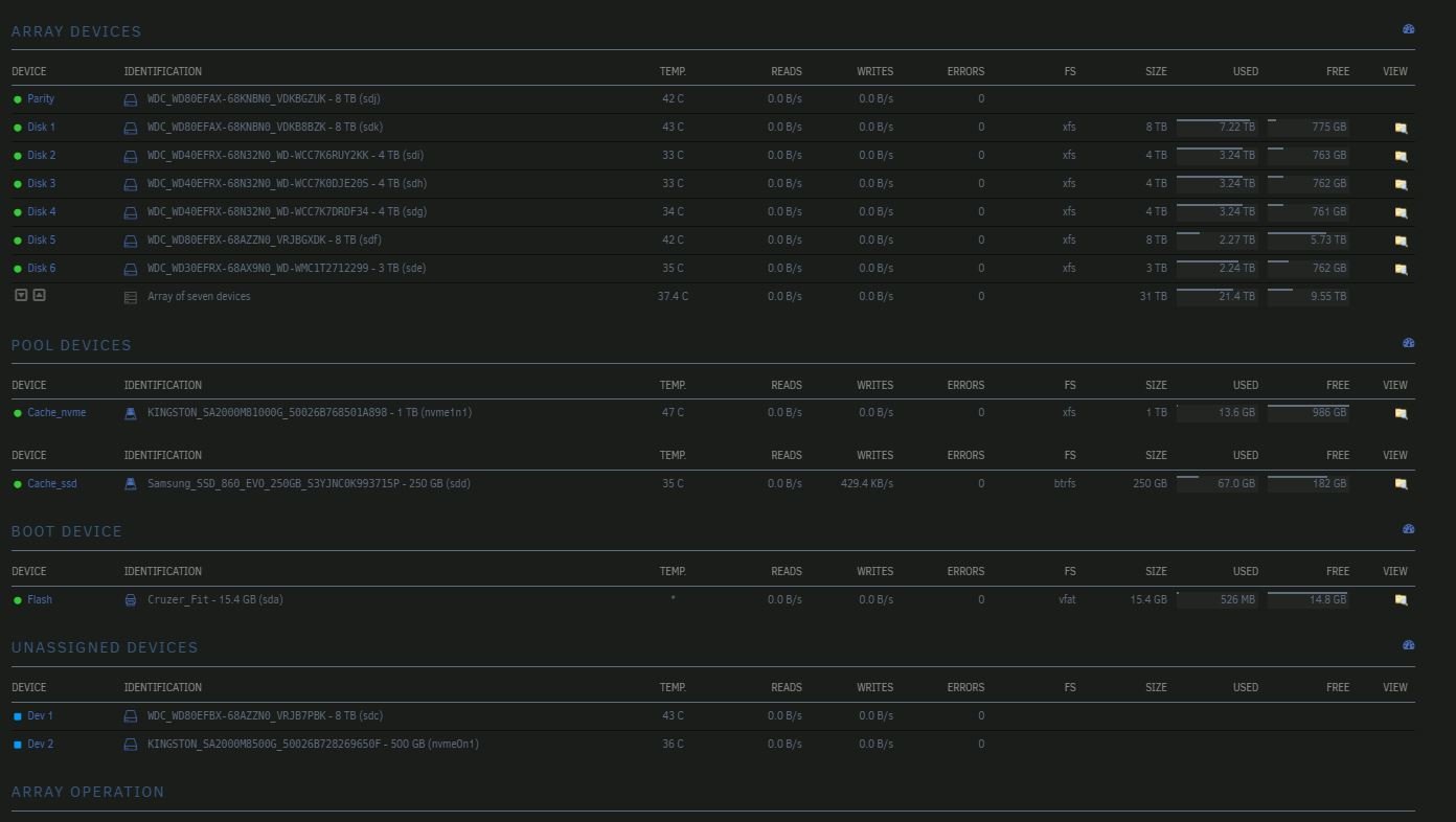

@dlandon Ok, finally the warning is gone from the main page. It disappeared as I refreshed the udev in step two in your instructions above. Running the mount cmd as you asked its still fine. Now all three partitions are also visual. Only 1 and 3 was visual earlier. Well done! :-D

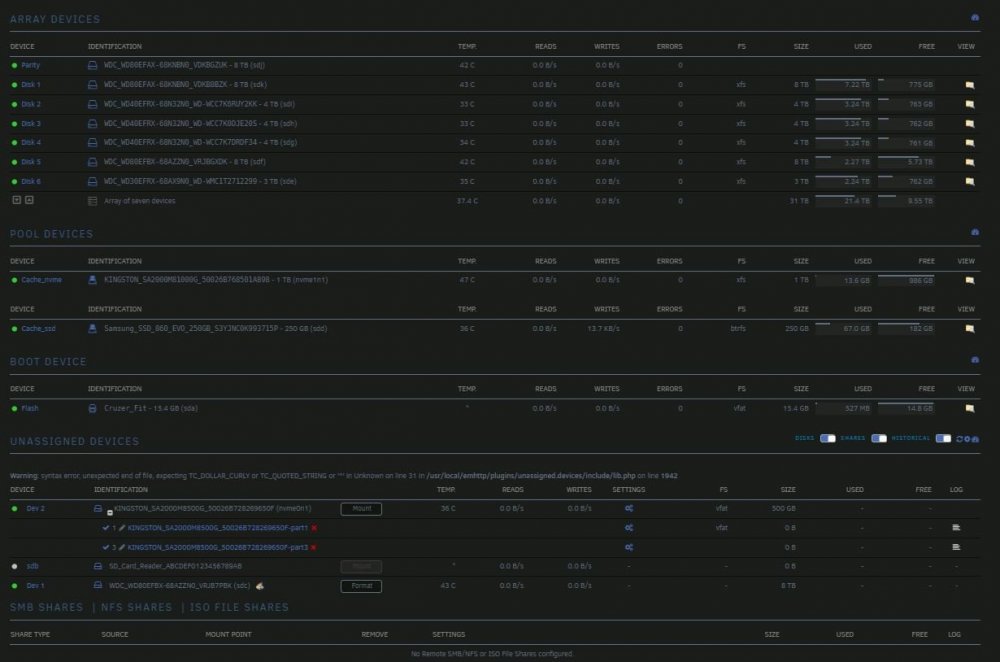

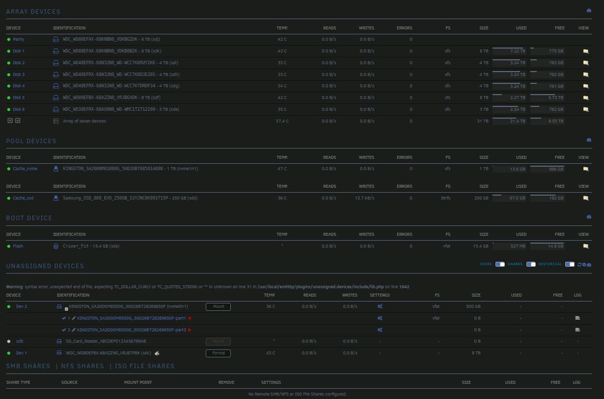

@dlandon Ok, I have updated UD to 2021.12.07. Warning still pressant. I have uninstalled the Pre Clear Disks plugin, rebooted the server. Warning still pressant. Attached is the "unassigned.devices.ini" you requested along with a new diagnostics taken post the actions taken described above as well as a scr dump showing the warning. 🙂 unassigned.devices.ini serverbrain3-diagnostics-20211208-1049.zip

@dlandon Ok, but its visual on the main page. The system has been booted post the latest update of the UD plugin and pre the diagnostics and the screen dump attached here.

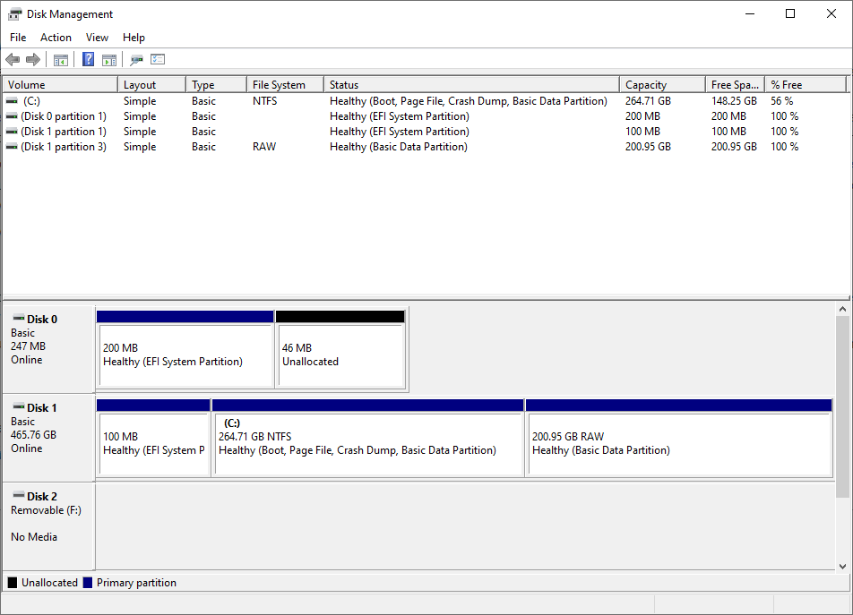

Just some more info regarding the disk u see in my diagnostics. The KINGSTON_SA2000M8500G..." disk I pass through to a WIN10 VM as its primary disk. I also pass through the SD-card reader to that VM. As the VM is running these two items are not available to unraid. But when the VM is not running these items are available to unraid. This is very convenient as I do not need e.g. two SD-card readers; one for the WIN10 VM and one for unraid. They can chare the same reader just not at the samt time though. the Same goes for the disk. Attached is a screendump from the WIN10 VM disk management view. The partition 2 is a EFI (Extensible Firmware Interface) system partition and the partition 1 is the main operation system partition for the win10 machine. The partition 3 is just empty as u describe. Dono if this helps at all.

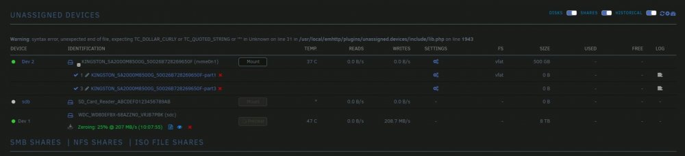

@dlandon Morning. I did the new update u pushed after our troubleshooting session yesterday. This morning I see that I have that warning message still, see attached image. I also see that I had it last night as well after updating the lib.php manually. I was quite tired last night so I must have missed it. Now running UD 2021.12.03. I do see my unassigned devices though.
Ok, that kind of fixed it. but it took a few seconds after loaded the main page for the disk to show up under UD but they do show up eventually so u r on the right track. When refreshing the page its just like it was before the issue started. Great work!! I need to hit the sack as its quite late over here. I really appreciating the work u do! Keep up the good work and if u like me to test some more please do not hesitate to let me know. :-)
