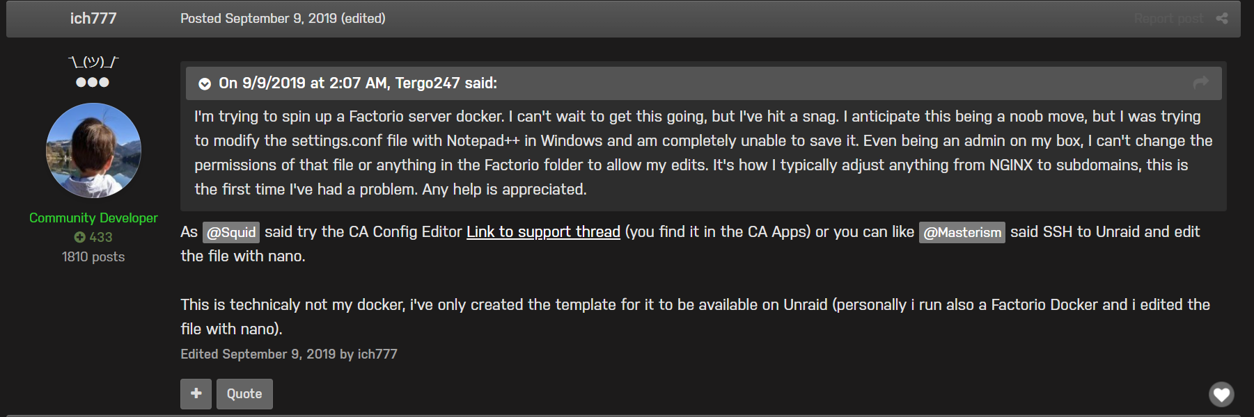

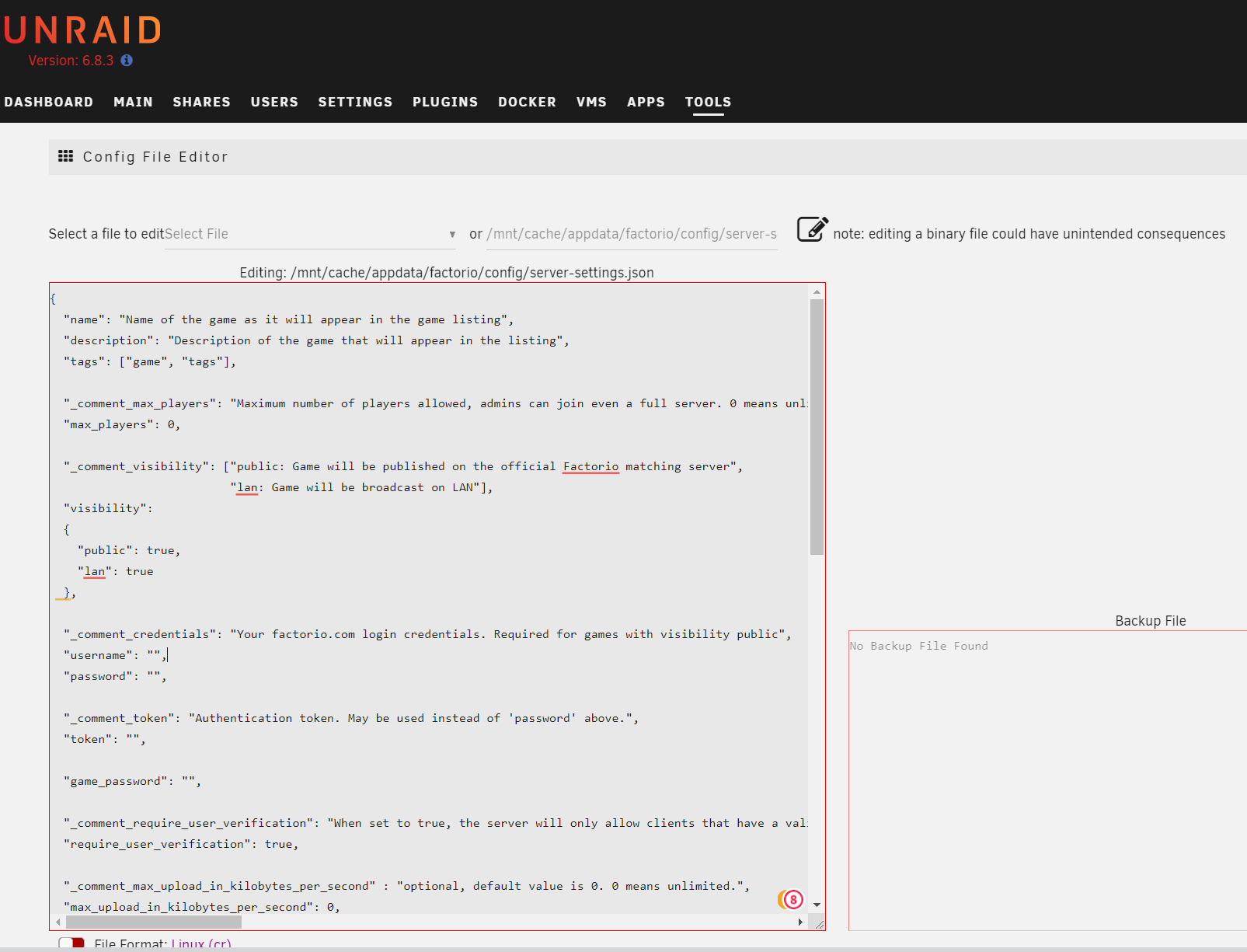

thanks for your quick answer, then it was good that I haven't changed anything. if I start factorio in Steam and then go to multiplayer, I can connect to the IP 192.168.1.27:34197 then a game is started with a new card, without an error message on Steam, but I cannot invite anyone to this card. If I go to multiplayer in Stem and then host a new game, that works too, but I can't invite anyone here either. My server cannot be found in the Steam list of servers and also not in the LAN list of available servers. Please excuse my ignorance, I'm a complete newbie to Unraid + Docker + Linux and the command line. Therefore, a very big THANK YOU for any help this is the log file ### Complement: as requested by you, I looked at this post from you: it says as far as I understand that I should edit the "settings.conf" file with the "CAConfig Editor". did I understand that correctly ???? If so, what should I enter or change where where can I find this file that I should edit is the date on the screen section the right one ???? if so, what do I have to enter or change Thank you again very much for any help from you Log for_ Factorio_2020_11_17.html

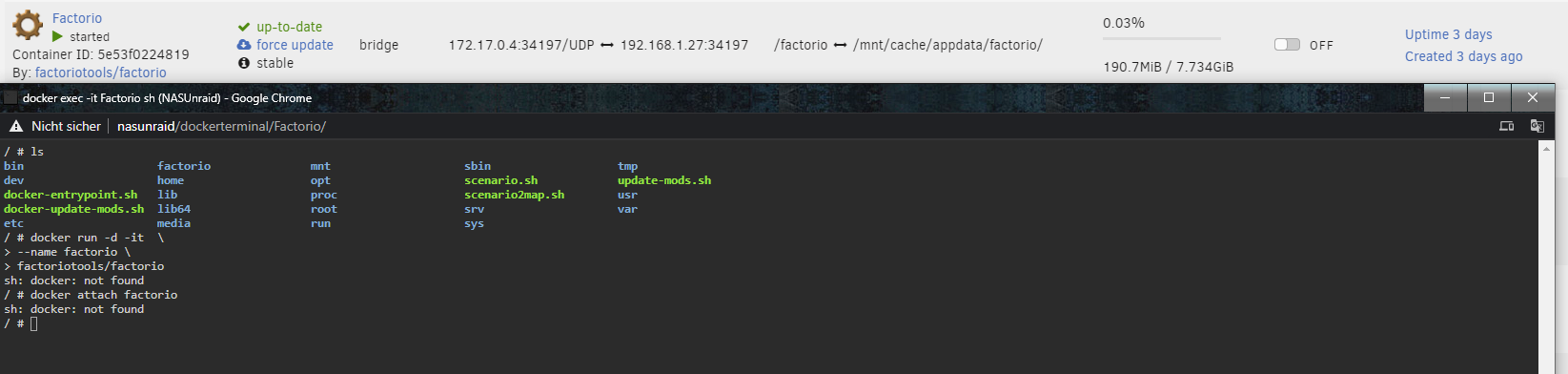

I have installed the "factorio docker" and it is running, but what happens next on the page: https://hub.docker.com/r/factoriotools/factorio/ it says that I should execute some commands in the console ==> none of them works, mostly I get the message "sh: docker: not found " Please help how do I get the factorio server to run in my own LAN. So that I can see him in the STEAM too.
