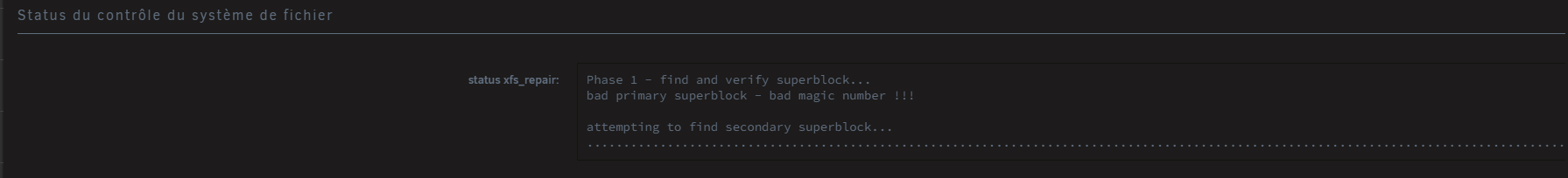

  2. the result after one hour: Ps array started in maintenance mode. root@NorthernLight:~# dd if=/dev/nvme0n1 bs=16M status=progress 2>/dev/null | hexdump -C | grep 'XFSB' 29c790a0 7a 37 61 59 59 0a 32 4e 63 4b 51 4e 58 46 53 42 |z7aYY.2NcKQNXFSB| 1b19e62a0 b4 8b 68 58 46 53 42 ad f9 8e 19 0c a3 95 03 e4 |..hXFSB.........| 2af5c4fd0 3d 00 58 46 53 42 00 62 63 61 63 68 65 00 5f 42 |=.XFSB.bcache._B| 335775a50 54 15 1d f5 97 98 0b 58 46 53 42 ca f9 55 38 12 |T......XFSB..U8.| 3f1125fa0 3d 00 58 46 53 42 00 62 63 61 63 68 65 00 5f 42 |=.XFSB.bcache._B|
  3. @JorgeB file system is XFS not ZFS ZFS was not implemented when i create my unraid server 5-6 years ago

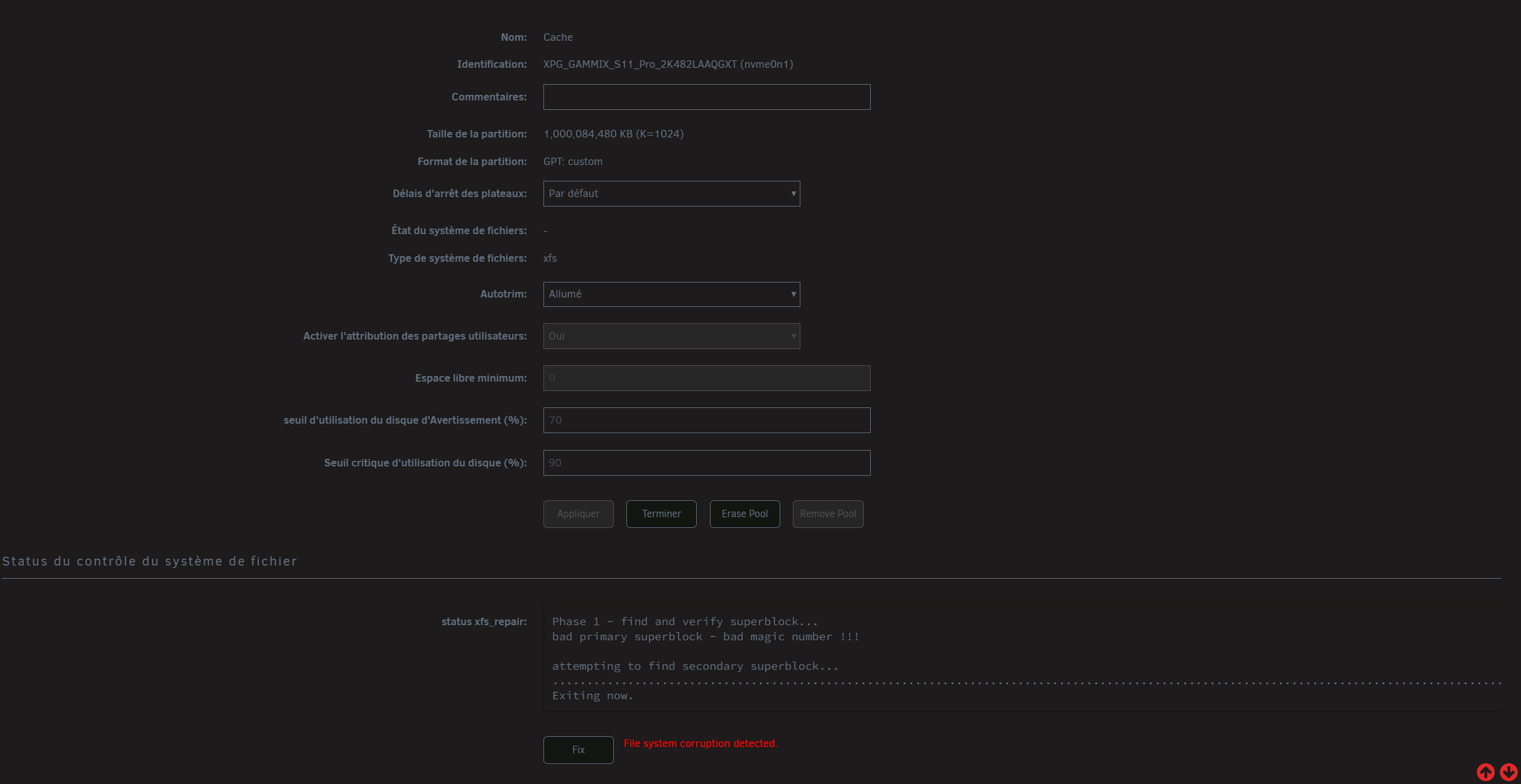

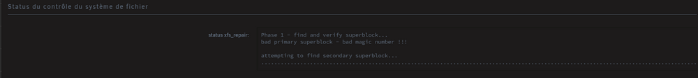

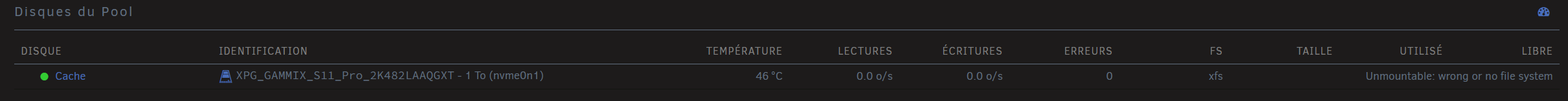

  4. I don't know why the disk have windows partition. i want recover data of all my docker and then replace the disk (it run until 5 years age and it used above 60%. the disk should be partitionned in XFS file system!
  5. Since a certain time I have a problem with my NVME drives on my unraid server. I have two disks: 1 m.2 pcie use as a cache and 1 U2 in passthrough for a VM for some time now the U2 NVME has been disappearing from the system causing the loss of the VM, only solution to have the disk again ->restart At restart drive id change nvme0n1 become nvme1n1 and nvme1n1 become nvme0n1. So the VM try to start on cache nvme drive. During the last restart, the cache disk became "unmountable", therefore no more VMs, no more Docker. I therefore started the array in maintenance mode and tried to perform a repair -> failure. Since the cache disk is 'unmountable', it also starts to disappear. Do you have any ideas? root@NorthernLight:~# fdisk -l /dev/nvme0n1 Disk /dev/nvme0n1: 953.87 GiB, 1024209543168 bytes, 2000409264 sectors Disk model: XPG GAMMIX S11 Pro Units: sectors of 1 * 512 = 512 bytes Sector size (logical/physical): 512 bytes / 512 bytes I/O size (minimum/optimal): 512 bytes / 512 bytes Disklabel type: gpt Disk identifier: 2266E47C-110D-48A5-AF14-500A2BBBCBB0 Device Start End Sectors Size Type /dev/nvme0n1p1 2048 206847 204800 100M EFI System /dev/nvme0n1p2 206848 239615 32768 16M Microsoft reserved /dev/nvme0n1p3 239616 2000408575 2000168960 953.8G Microsoft basic data northernlight-diagnostics-20260128-1520.zip Thanks for helping me.
  6. Bonjour à tous et à toutes. Depuis qlq temps j'ai un pb avec mes disque NVME sur mon serveur unraid. J'ai deux disques: 1 m.2 pcie qui sert de cache t un U2 en passthroug pour une VM depuis quelque temps le NVME U2 disparait du système occasionnant la perte de la VM seul solution pour ravoir le disque ->redémarrer Lors du dernier redémarrage le disque de cache est devenu "unmountable" par conséquent plus de VM plus de Docker. J'ai donc démarrer l'array en mode maintenance et essayer de procéder à une réparation -> échec. Depuis que le disque de cache est "unmountable" celui ci se met également à disparaitre. Auriez vous des idées?
