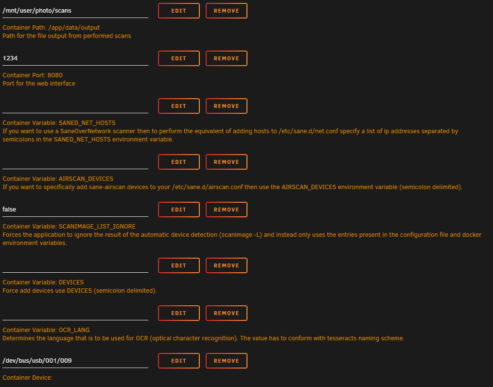

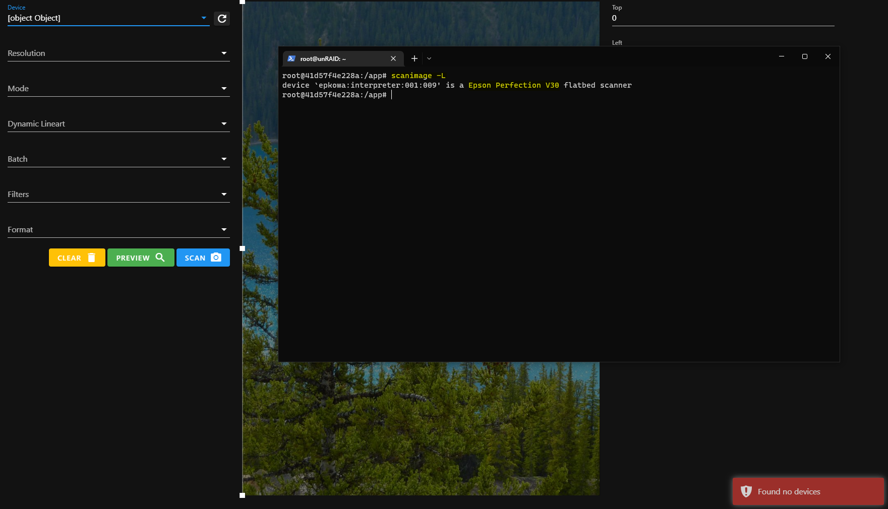

  18. Making similar experiences. My scanner is not supported out of the box, but after driver installation scanimage -L works as well. Unfortunately the scanner is not found in the web interface either. Is there anything that needs to be adjusted in the Docker variables? # Installation Epson Drivers inside Docker (temporarily) docker exec -it scanservjs bash cp /app/config/iscan-gt-f720-bundle-2.30.4.x64.deb.tar.gz /tmp/ cd /tmp/ tar -xvf iscan-gt-f720-bundle-2.30.4.x64.deb.tar.gz cd /app/config/iscan-gt-f720-bundle-2.30.4.x64.deb/ ./install.sh ... scanimage -L Created directory: /var/lib/snmp/cert_indexes device `epkowa:interpreter:001:009' is a Epson Perfection V30 flatbed scanner

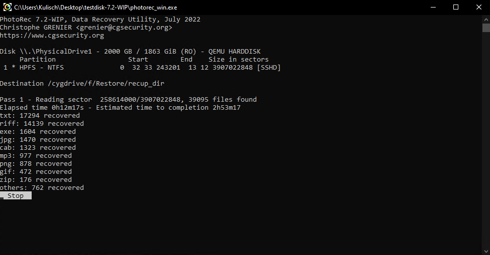

  22. unraid-diagnostics-20220919-1331.zip Like mentioned before,... The VM or Unraid crashed if I use /mnt/user/domains If I use /mnt/cache/domains everything works like a charm. I guess the same problem appears if im using docker containers. Using, docker-mailserver, postgres, nextcloud is no problem... using Swag gives me a crash after an amount of time... So im guessing there are problem in /mnt/user/ directory. How can I fix this? Update: Testdisk and Photorec works. Thx for the advise.

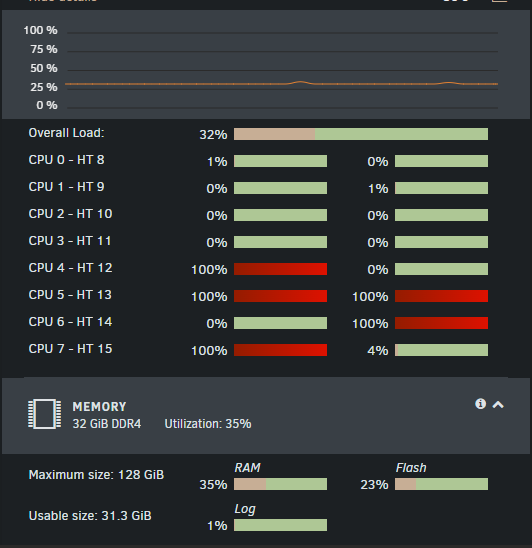

  25. Everytime I use the VM for an hour, happens a kernel panic in unraid. So there is no chance to check anything after that. After disabling Docker and starting the VM the CPU goes on some CPU Threads on 100 %. (Windows 11 fresh install) root@unRAID:~# df -h Filesystem Size Used Avail Use% Mounted on rootfs 16G 2.0G 14G 13% / tmpfs 32M 420K 32M 2% /run /dev/sda1 15G 3.2G 12G 23% /boot overlay 16G 2.0G 14G 13% /lib/firmware overlay 16G 2.0G 14G 13% /lib/modules devtmpfs 8.0M 0 8.0M 0% /dev tmpfs 16G 0 16G 0% /dev/shm cgroup_root 8.0M 0 8.0M 0% /sys/fs/cgroup tmpfs 128M 476K 128M 1% /var/log tmpfs 1.0M 0 1.0M 0% /mnt/disks tmpfs 1.0M 0 1.0M 0% /mnt/remotes tmpfs 1.0M 0 1.0M 0% /mnt/rootshare /dev/md1 2.8T 1.3T 1.5T 48% /mnt/disk1 /dev/sdb1 466G 200G 264G 44% /mnt/cache shfs 2.8T 1.3T 1.5T 48% /mnt/user0 shfs 2.8T 1.3T 1.5T 48% /mnt/user /dev/loop3 50G 4.9M 50G 1% /etc/libvirt Forcing the shutdown doesn't work and after the 2nd try, Unraid crashes. After booting up, started the VM and it crashed after 1 hour again. root@unRAID:~# tail -f /var/log/syslog Sep 7 14:03:20 unRAID avahi-daemon[10293]: New relevant interface vnet0.IPv6 for mDNS. Sep 7 14:03:20 unRAID avahi-daemon[10293]: Registering new address record for fe80::fc54:ff:fe8d:ec92 on vnet0.*. Sep 7 14:03:20 unRAID flash_backup: adding task: /usr/local/emhttp/plugins/dynamix.my.servers/scripts/UpdateFlashBackup update Sep 7 14:05:59 unRAID ntpd[1724]: kernel reports TIME_ERROR: 0x41: Clock Unsynchronized Sep 7 14:06:51 unRAID sshd[15169]: Connection from 10.0.10.117 port 1579 on 10.0.10.10 port 22 rdomain "" Sep 7 14:06:51 unRAID sshd[15169]: Postponed keyboard-interactive for root from 10.0.10.117 port 1579 ssh2 [preauth] Sep 7 14:06:56 unRAID sshd[15169]: Postponed keyboard-interactive/pam for root from 10.0.10.117 port 1579 ssh2 [preauth] Sep 7 14:06:56 unRAID sshd[15169]: Accepted keyboard-interactive/pam for root from 10.0.10.117 port 1579 ssh2 Sep 7 14:06:56 unRAID sshd[15169]: pam_unix(sshd:session): session opened for user root(uid=0) by (uid=0) Sep 7 14:06:56 unRAID sshd[15169]: Starting session: shell on pts/1 for root from 10.0.10.117 port 1579 id 0 Sep 7 14:07:55 unRAID avahi-daemon[10293]: Interface vnet0.IPv6 no longer relevant for mDNS. Sep 7 14:07:55 unRAID avahi-daemon[10293]: Leaving mDNS multicast group on interface vnet0.IPv6 with address fe80::fc54:ff:fe8d:ec92. Sep 7 14:07:55 unRAID kernel: br0: port 2(vnet0) entered disabled state Sep 7 14:07:55 unRAID kernel: device vnet0 left promiscuous mode Sep 7 14:07:55 unRAID kernel: br0: port 2(vnet0) entered disabled state Sep 7 14:07:55 unRAID avahi-daemon[10293]: Withdrawing address record for fe80::fc54:ff:fe8d:ec92 on vnet0. Sep 7 14:08:21 unRAID kernel: br0: port 2(vnet1) entered blocking state Sep 7 14:08:21 unRAID kernel: br0: port 2(vnet1) entered disabled state Sep 7 14:08:21 unRAID kernel: device vnet1 entered promiscuous mode Sep 7 14:08:21 unRAID kernel: br0: port 2(vnet1) entered blocking state Sep 7 14:08:21 unRAID kernel: br0: port 2(vnet1) entered forwarding state Sep 7 14:08:22 unRAID avahi-daemon[10293]: Joining mDNS multicast group on interface vnet1.IPv6 with address fe80::fc54:ff:fe8d:ec92. Sep 7 14:08:22 unRAID avahi-daemon[10293]: New relevant interface vnet1.IPv6 for mDNS. Sep 7 14:08:22 unRAID avahi-daemon[10293]: Registering new address record for fe80::fc54:ff:fe8d:ec92 on vnet1.*. Sep 7 14:08:39 unRAID nmbd[10250]: [2022/09/07 14:08:39.002205, 0] ../../source3/nmbd/nmbd_become_lmb.c:398(become_local_master_stage2) Sep 7 14:08:39 unRAID nmbd[10250]: ***** Sep 7 14:08:39 unRAID nmbd[10250]: Sep 7 14:08:39 unRAID nmbd[10250]: Samba name server UNRAID is now a local master browser for workgroup WORKGROUP on subnet 192.168.122.1 Sep 7 14:08:39 unRAID nmbd[10250]: Sep 7 14:08:39 unRAID nmbd[10250]: ***** Sep 7 14:11:00 unRAID root: Fix Common Problems Version 2022.08.29 Sep 7 14:11:07 unRAID root: Fix Common Problems: Warning: NerdPack.plg Not Compatible with Unraid version 6.11.0-rc4 Sep 7 14:11:10 unRAID root: Fix Common Problems: Warning: Syslog mirrored to flash Sep 7 14:11:10 unRAID root: Fix Common Problems: Warning: The plugin usb_manager_usbip_addon.plg is not known to Community Applications and is possibly incompatible with your server Sep 7 14:36:46 unRAID kernel: ------------[ cut here ]------------ Sep 7 14:36:46 unRAID kernel: WARNING: CPU: 3 PID: 57 at kernel/rcu/tree.c:2634 rcu_do_batch+0x3d8/0x46c Sep 7 14:36:46 unRAID kernel: Modules linked in: xt_CHECKSUM xt_conntrack ipt_REJECT nf_reject_ipv4 xt_tcpudp ip6table_mangle ip6table_nat iptable_mangle vhost_net tun vhost vhost_iotlb tap vhci_hcd usbip_host usbip_core xfs md_mod efivarfs iptable_nat xt_MASQUERADE nf_nat nf_conntrack nf_defrag_ipv6 nf_defrag_ipv4 wireguard curve25519_x86_64 libcurve25519_generic libchacha20poly1305 chacha_x86_64 poly1305_x86_64 ip6_udp_tunnel udp_tunnel libchacha ip6table_filter ip6_tables iptable_filter ip_tables x_tables af_packet 8021q garp mrp bridge stp llc bonding tls ipv6 nvidia_drm(PO) nvidia_modeset(PO) nvidia(PO) drm_kms_helper drm btusb sr_mod btrtl cdrom btbcm kvm_amd kvm crct10dif_pclmul crc32_pclmul crc32c_intel wmi_bmof ghash_clmulni_intel aesni_intel crypto_simd btintel cryptd i2c_piix4 backlight rapl bluetooth ccp k10temp i2c_core igc syscopyarea sysfillrect ahci sysimgblt fb_sys_fops joydev libahci ecdh_generic ecc wmi button unix Sep 7 14:36:46 unRAID kernel: CPU: 3 PID: 57 Comm: rcuop/6 Tainted: P O 5.19.3-Unraid #1 Sep 7 14:36:46 unRAID kernel: Hardware name: To Be Filled By O.E.M. To Be Filled By O.E.M./B550 Taichi, BIOS P1.80 02/22/2021 Sep 7 14:36:46 unRAID kernel: RIP: 0010:rcu_do_batch+0x3d8/0x46c Sep 7 14:36:46 unRAID kernel: Code: 00 00 00 75 49 48 85 d2 74 44 31 c0 48 89 83 f0 00 00 00 48 8b 05 71 c6 fe 00 48 89 83 00 01 00 00 48 8b 43 78 48 85 c0 74 4a <0f> 0b 48 8b 3c 24 e8 91 54 00 00 48 85 c0 74 02 0f 0b 48 8b 3c 24 Sep 7 14:36:46 unRAID kernel: RSP: 0018:ffffc9000039be60 EFLAGS: 00010086 Sep 7 14:36:46 unRAID kernel: RAX: ffff888101494000 RBX: ffff888122390d70 RCX: 0000000000000000 Sep 7 14:36:46 unRAID kernel: RDX: 0000000100000000 RSI: ffffffffffffffed RDI: ffff88881e9acdb8 Sep 7 14:36:46 unRAID kernel: RBP: 0000000000000000 R08: 0000000000000000 R09: ffff88881e8ec070 Sep 7 14:36:46 unRAID kernel: R10: 0000000000000000 R11: ffff888100400058 R12: 0000000000000246 Sep 7 14:36:46 unRAID kernel: R13: 0000000000000013 R14: 000000000000000a R15: ffff888100a76e40 Sep 7 14:36:46 unRAID kernel: FS: 0000000000000000(0000) GS:ffff88881e8c0000(0000) knlGS:0000000000000000 Sep 7 14:36:46 unRAID kernel: CS: 0010 DS: 0000 ES: 0000 CR0: 0000000080050033 Sep 7 14:36:46 unRAID kernel: CR2: 0000000000462cb8 CR3: 000000019f590000 CR4: 0000000000350ee0 Sep 7 14:36:46 unRAID kernel: Call Trace: Sep 7 14:36:46 unRAID kernel: <TASK> Sep 7 14:36:46 unRAID kernel: ? preempt_latency_start+0x2b/0x46 Sep 7 14:36:46 unRAID kernel: rcu_nocb_cb_kthread+0x10f/0x28c Sep 7 14:36:46 unRAID kernel: ? rcu_cpu_kthread+0x10a/0x10a Sep 7 14:36:46 unRAID kernel: kthread+0xe7/0xef Sep 7 14:36:46 unRAID kernel: ? kthread_complete_and_exit+0x1b/0x1b Sep 7 14:36:46 unRAID kernel: ret_from_fork+0x22/0x30 Sep 7 14:36:46 unRAID kernel: </TASK> Sep 7 14:36:46 unRAID kernel: ---[ end trace 0000000000000000 ]--- Sep 7 14:36:46 unRAID kernel: ------------[ cut here ]------------ Sep 7 14:36:46 unRAID kernel: WARNING: CPU: 3 PID: 57 at kernel/rcu/tree.c:2637 rcu_do_batch+0x3e8/0x46c Sep 7 14:36:46 unRAID kernel: Modules linked in: xt_CHECKSUM xt_conntrack ipt_REJECT nf_reject_ipv4 xt_tcpudp ip6table_mangle ip6table_nat iptable_mangle vhost_net tun vhost vhost_iotlb tap vhci_hcd usbip_host usbip_core xfs md_mod efivarfs iptable_nat xt_MASQUERADE nf_nat nf_conntrack nf_defrag_ipv6 nf_defrag_ipv4 wireguard curve25519_x86_64 libcurve25519_generic libchacha20poly1305 chacha_x86_64 poly1305_x86_64 ip6_udp_tunnel udp_tunnel libchacha ip6table_filter ip6_tables iptable_filter ip_tables x_tables af_packet 8021q garp mrp bridge stp llc bonding tls ipv6 nvidia_drm(PO) nvidia_modeset(PO) nvidia(PO) drm_kms_helper drm btusb sr_mod btrtl cdrom btbcm kvm_amd kvm crct10dif_pclmul crc32_pclmul crc32c_intel wmi_bmof ghash_clmulni_intel aesni_intel crypto_simd btintel cryptd i2c_piix4 backlight rapl bluetooth ccp k10temp i2c_core igc syscopyarea sysfillrect ahci sysimgblt fb_sys_fops joydev libahci ecdh_generic ecc wmi button unix Sep 7 14:36:46 unRAID kernel: CPU: 3 PID: 57 Comm: rcuop/6 Tainted: P W O 5.19.3-Unraid #1 Sep 7 14:36:46 unRAID kernel: Hardware name: To Be Filled By O.E.M. To Be Filled By O.E.M./B550 Taichi, BIOS P1.80 02/22/2021 Sep 7 14:36:46 unRAID kernel: RIP: 0010:rcu_do_batch+0x3e8/0x46c Sep 7 14:36:46 unRAID kernel: Code: 00 00 00 48 8b 05 71 c6 fe 00 48 89 83 00 01 00 00 48 8b 43 78 48 85 c0 74 4a 0f 0b 48 8b 3c 24 e8 91 54 00 00 48 85 c0 74 02 <0f> 0b 48 8b 3c 24 e8 81 54 00 00 48 85 c0 75 41 0f 0b eb 3d 48 2b Sep 7 14:36:46 unRAID kernel: RSP: 0018:ffffc9000039be60 EFLAGS: 00010002 Sep 7 14:36:46 unRAID kernel: RAX: 0000000000000023 RBX: ffff888122390d70 RCX: 0000000000000000 Sep 7 14:36:46 unRAID kernel: RDX: 0000000000000000 RSI: ffffffffffffffed RDI: ffff88881e9acdb8 Sep 7 14:36:46 unRAID kernel: RBP: 0000000000000000 R08: 0000000000000000 R09: ffff88881e8ec070 Sep 7 14:36:46 unRAID kernel: R10: 0000000000000000 R11: ffff888100400058 R12: 0000000000000246 Sep 7 14:36:46 unRAID kernel: R13: 0000000000000013 R14: 000000000000000a R15: ffff888100a76e40 Sep 7 14:36:46 unRAID kernel: FS: 0000000000000000(0000) GS:ffff88881e8c0000(0000) knlGS:0000000000000000 Sep 7 14:36:46 unRAID kernel: CS: 0010 DS: 0000 ES: 0000 CR0: 0000000080050033 Sep 7 14:36:46 unRAID kernel: CR2: 0000000000462cb8 CR3: 000000019f590000 CR4: 0000000000350ee0 Sep 7 14:36:46 unRAID kernel: Call Trace: Sep 7 14:36:46 unRAID kernel: <TASK> Sep 7 14:36:46 unRAID kernel: ? preempt_latency_start+0x2b/0x46 Sep 7 14:36:46 unRAID kernel: rcu_nocb_cb_kthread+0x10f/0x28c Sep 7 14:36:46 unRAID kernel: ? rcu_cpu_kthread+0x10a/0x10a Sep 7 14:36:46 unRAID kernel: kthread+0xe7/0xef Sep 7 14:36:46 unRAID kernel: ? kthread_complete_and_exit+0x1b/0x1b Sep 7 14:36:46 unRAID kernel: ret_from_fork+0x22/0x30 Sep 7 14:36:46 unRAID kernel: </TASK> Sep 7 14:36:46 unRAID kernel: ---[ end trace 0000000000000000 ]--- Sep 7 14:36:46 unRAID kernel: BUG: scheduling while atomic: rcuop/6/57/0x00000002 Sep 7 14:36:46 unRAID kernel: Modules linked in: xt_CHECKSUM xt_conntrack ipt_REJECT nf_reject_ipv4 xt_tcpudp ip6table_mangle ip6table_nat iptable_mangle vhost_net tun vhost vhost_iotlb tap vhci_hcd usbip_host usbip_core xfs md_mod efivarfs iptable_nat xt_MASQUERADE nf_nat nf_conntrack nf_defrag_ipv6 nf_defrag_ipv4 wireguard curve25519_x86_64 libcurve25519_generic libchacha20poly1305 chacha_x86_64 poly1305_x86_64 ip6_udp_tunnel udp_tunnel libchacha ip6table_filter ip6_tables iptable_filter ip_tables x_tables af_packet 8021q garp mrp bridge stp llc bonding tls ipv6 nvidia_drm(PO) nvidia_modeset(PO) nvidia(PO) drm_kms_helper drm btusb sr_mod btrtl cdrom btbcm kvm_amd kvm crct10dif_pclmul crc32_pclmul crc32c_intel wmi_bmof ghash_clmulni_intel aesni_intel crypto_simd btintel cryptd i2c_piix4 backlight rapl bluetooth ccp k10temp i2c_core igc syscopyarea sysfillrect ahci sysimgblt fb_sys_fops joydev libahci ecdh_generic ecc wmi button unix Sep 7 14:36:46 unRAID kernel: Preemption disabled at: Sep 7 14:36:46 unRAID kernel: [<ffffffff810cf30d>] rcu_do_batch+0x2e6/0x46c Sep 7 14:36:46 unRAID kernel: CPU: 3 PID: 57 Comm: rcuop/6 Tainted: P W O 5.19.3-Unraid #1 Sep 7 14:36:46 unRAID kernel: Hardware name: To Be Filled By O.E.M. To Be Filled By O.E.M./B550 Taichi, BIOS P1.80 02/22/2021 Sep 7 14:36:46 unRAID kernel: Call Trace: Sep 7 14:36:46 unRAID kernel: <TASK> Sep 7 14:36:46 unRAID kernel: dump_stack_lvl+0x44/0x5c Sep 7 14:36:46 unRAID kernel: ? rcu_do_batch+0x2e6/0x46c Sep 7 14:36:46 unRAID kernel: __schedule_bug+0xa3/0xb6 Sep 7 14:36:46 unRAID kernel: __schedule+0x59/0x5f6 Sep 7 14:36:46 unRAID kernel: ? preempt_latency_start+0x2b/0x46 Sep 7 14:36:46 unRAID kernel: schedule+0x8e/0xc3 Sep 7 14:36:46 unRAID kernel: rcu_nocb_cb_kthread+0x90/0x28c Sep 7 14:36:46 unRAID kernel: ? rcu_cpu_kthread+0x10a/0x10a Sep 7 14:36:46 unRAID kernel: kthread+0xe7/0xef Sep 7 14:36:46 unRAID kernel: ? kthread_complete_and_exit+0x1b/0x1b Sep 7 14:36:46 unRAID kernel: ret_from_fork+0x22/0x30 Sep 7 14:36:46 unRAID kernel: </TASK> Sep 7 15:08:57 unRAID kernel: BUG: kernel NULL pointer dereference, address: 000000000000009c Sep 7 15:08:57 unRAID kernel: #PF: supervisor read access in kernel mode Sep 7 15:08:57 unRAID kernel: #PF: error_code(0x0000) - not-present page Sep 7 15:08:57 unRAID kernel: PGD 0 P4D 0 Sep 7 15:08:57 unRAID kernel: Oops: 0000 [#1] PREEMPT SMP NOPTI Sep 7 15:08:57 unRAID kernel: CPU: 6 PID: 0 Comm: swapper/6 Tainted: P W O 5.19.3-Unraid #1 Sep 7 15:08:57 unRAID kernel: Hardware name: To Be Filled By O.E.M. To Be Filled By O.E.M./B550 Taichi, BIOS P1.80 02/22/2021 Sep 7 15:08:57 unRAID kernel: RIP: 0010:update_cfs_rq_load_avg+0x22/0x189 Sep 7 15:08:57 unRAID kernel: Code: 43 80 5b e9 c2 b3 96 00 41 57 41 56 41 55 41 54 55 48 89 fd 53 48 89 f3 41 51 44 8b a6 c4 00 00 00 45 85 e4 0f 84 49 01 00 00 <8b> 86 9c 00 00 00 48 8d be c0 00 00 00 48 89 3c 24 44 8d a8 7e b6 Sep 7 15:08:57 unRAID kernel: RSP: 0018:ffffc90000187e90 EFLAGS: 00010006 Sep 7 15:08:57 unRAID kernel: RAX: ffff8881022c4f0f RBX: ffff88881e9abfc0 RCX: ffff88881e9aca28 Sep 7 15:08:57 unRAID kernel: RDX: ffff88881e9aca28 RSI: 0000000000000000 RDI: ffff88881e9abfc0 Sep 7 15:08:57 unRAID kernel: RBP: ffff8881022c4ec0 R08: 0000000000000000 R09: ffff88881e99f0e0 Sep 7 15:08:57 unRAID kernel: R10: 0000000000000003 R11: 0000000000000000 R12: ffff888100906e40 Sep 7 15:08:57 unRAID kernel: R13: 0000000000000000 R14: 0000000000000000 R15: ffffc90000187ed8 Sep 7 15:08:57 unRAID kernel: FS: 0000000000000000(0000) GS:ffff88881e980000(0000) knlGS:0000000000000000 Sep 7 15:08:57 unRAID kernel: CS: 0010 DS: 0000 ES: 0000 CR0: 0000000080050033 Sep 7 15:08:57 unRAID kernel: CR2: 000000000000009c CR3: 00000004b0bb8000 CR4: 0000000000350ee0 Sep 7 15:08:57 unRAID kernel: Call Trace: Sep 7 15:08:57 unRAID kernel: <TASK> Sep 7 15:08:57 unRAID kernel: ? __schedule+0x1ba/0x5f6 Sep 7 15:08:57 unRAID kernel: ? schedule_idle+0x27/0x34 Sep 7 15:08:57 unRAID kernel: ? cpu_startup_entry+0x1d/0x1f Sep 7 15:08:57 unRAID kernel: ? start_secondary+0xeb/0xeb Sep 7 15:08:57 unRAID kernel: ? secondary_startup_64_no_verify+0xce/0xdb Sep 7 15:08:57 unRAID kernel: </TASK> Sep 7 15:08:57 unRAID kernel: Modules linked in: xt_CHECKSUM xt_conntrack ipt_REJECT nf_reject_ipv4 xt_tcpudp ip6table_mangle ip6table_nat iptable_mangle vhost_net tun vhost vhost_iotlb tap vhci_hcd usbip_host usbip_core xfs md_mod efivarfs iptable_nat xt_MASQUERADE nf_nat nf_conntrack nf_defrag_ipv6 nf_defrag_ipv4 wireguard curve25519_x86_64 libcurve25519_generic libchacha20poly1305 chacha_x86_64 poly1305_x86_64 ip6_udp_tunnel udp_tunnel libchacha ip6table_filter ip6_tables iptable_filter ip_tables x_tables af_packet 8021q garp mrp bridge stp llc bonding tls ipv6 nvidia_drm(PO) nvidia_modeset(PO) nvidia(PO) drm_kms_helper drm btusb sr_mod btrtl cdrom btbcm kvm_amd kvm crct10dif_pclmul crc32_pclmul crc32c_intel wmi_bmof ghash_clmulni_intel aesni_intel crypto_simd btintel cryptd i2c_piix4 backlight rapl bluetooth ccp k10temp i2c_core igc syscopyarea sysfillrect ahci sysimgblt fb_sys_fops joydev libahci ecdh_generic ecc wmi button unix Sep 7 15:08:57 unRAID kernel: CR2: 000000000000009c Sep 7 15:08:57 unRAID kernel: ---[ end trace 0000000000000000 ]--- Sep 7 15:08:57 unRAID kernel: xhci_hcd 0000:01:00.0: xHCI host not responding to stop endpoint command Sep 7 15:08:57 unRAID kernel: xhci_hcd 0000:01:00.0: xHCI host controller not responding, assume dead Sep 7 15:08:57 unRAID kernel: xhci_hcd 0000:01:00.0: HC died; cleaning up Sep 7 15:08:57 unRAID kernel: usb 1-3: USB disconnect, device number 2 Sep 7 15:08:57 unRAID kernel: usb 1-5: USB disconnect, device number 3 Sep 7 15:08:57 unRAID kernel: sd 0:0:0:0: [sda] tag#0 UNKNOWN(0x2003) Result: hostbyte=0x07 driverbyte=DRIVER_OK cmd_age=0s Sep 7 15:08:57 unRAID kernel: sd 0:0:0:0: [sda] tag#0 CDB: opcode=0x2a 2a 00 01 3d 9c 92 00 00 01 00 Sep 7 15:08:57 unRAID kernel: I/O error, dev sda, sector 20814994 op 0x1:(WRITE) flags 0x800 phys_seg 1 prio class 0 Sep 7 15:08:58 unRAID kernel: sd 0:0:0:0: [sda] tag#0 UNKNOWN(0x2003) Result: hostbyte=0x07 driverbyte=DRIVER_OK cmd_age=0s Sep 7 15:08:58 unRAID kernel: sd 0:0:0:0: [sda] tag#0 CDB: opcode=0x2a 2a 00 00 00 08 01 00 00 01 00 Sep 7 15:08:58 unRAID kernel: I/O error, dev sda, sector 2049 op 0x1:(WRITE) flags 0x0 phys_seg 1 prio class 0 Sep 7 15:08:58 unRAID kernel: Buffer I/O error on dev sda1, logical block 1, lost async page write Sep 7 15:08:58 unRAID kernel: sd 0:0:0:0: [sda] tag#0 UNKNOWN(0x2003) Result: hostbyte=0x07 driverbyte=DRIVER_OK cmd_age=0s Sep 7 15:08:58 unRAID kernel: sd 0:0:0:0: [sda] tag#0 CDB: opcode=0x2a 2a 00 00 00 2f c4 00 00 01 00 Sep 7 15:08:58 unRAID kernel: I/O error, dev sda, sector 12228 op 0x1:(WRITE) flags 0x100000 phys_seg 1 prio class 0 Sep 7 15:08:58 unRAID kernel: Buffer I/O error on dev sda1, logical block 10180, lost async page write Sep 7 15:08:58 unRAID kernel: sd 0:0:0:0: [sda] tag#0 UNKNOWN(0x2003) Result: hostbyte=0x07 driverbyte=DRIVER_OK cmd_age=0s Sep 7 15:08:58 unRAID kernel: sd 0:0:0:0: [sda] tag#0 CDB: opcode=0x2a 2a 00 01 3d 9c a2 00 00 01 00 Sep 7 15:08:58 unRAID kernel: I/O error, dev sda, sector 20815010 op 0x1:(WRITE) flags 0x800 phys_seg 1 prio class 0 Sep 7 15:08:58 unRAID kernel: sd 0:0:0:0: [sda] tag#0 UNKNOWN(0x2003) Result: hostbyte=0x07 driverbyte=DRIVER_OK cmd_age=0s Sep 7 15:08:58 unRAID kernel: sd 0:0:0:0: [sda] tag#0 CDB: opcode=0x2a 2a 00 01 3d 9c c2 00 00 01 00 Sep 7 15:08:58 unRAID kernel: I/O error, dev sda, sector 20815042 op 0x1:(WRITE) flags 0x800 phys_seg 1 prio class 0 Sep 7 15:08:58 unRAID kernel: sd 0:0:0:0: [sda] tag#0 UNKNOWN(0x2003) Result: hostbyte=0x07 driverbyte=DRIVER_OK cmd_age=0s Sep 7 15:08:58 unRAID kernel: sd 0:0:0:0: [sda] tag#0 CDB: opcode=0x2a 2a 00 00 00 69 04 00 00 02 00 Sep 7 15:08:58 unRAID kernel: I/O error, dev sda, sector 26884 op 0x1:(WRITE) flags 0x100000 phys_seg 2 prio class 0 Sep 7 15:08:58 unRAID kernel: Buffer I/O error on dev sda1, logical block 24836, lost async page write Sep 7 15:08:58 unRAID kernel: Buffer I/O error on dev sda1, logical block 24837, lost async page write Sep 7 15:08:58 unRAID kernel: sd 0:0:0:0: [sda] tag#0 UNKNOWN(0x2003) Result: hostbyte=0x07 driverbyte=DRIVER_OK cmd_age=0s Sep 7 15:08:58 unRAID kernel: sd 0:0:0:0: [sda] tag#0 CDB: opcode=0x2a 2a 00 00 00 7a a2 00 00 01 00 Sep 7 15:08:58 unRAID kernel: I/O error, dev sda, sector 31394 op 0x1:(WRITE) flags 0x0 phys_seg 1 prio class 0 Sep 7 15:08:58 unRAID kernel: Buffer I/O error on dev sda1, logical block 29346, lost async page write Sep 7 15:08:58 unRAID kernel: sd 0:0:0:0: [sda] tag#0 UNKNOWN(0x2003) Result: hostbyte=0x07 driverbyte=DRIVER_OK cmd_age=0s Sep 7 15:08:58 unRAID kernel: sd 0:0:0:0: [sda] tag#0 CDB: opcode=0x2a 2a 00 00 00 85 b5 00 00 02 00 Sep 7 15:08:58 unRAID kernel: I/O error, dev sda, sector 34229 op 0x1:(WRITE) flags 0x0 phys_seg 2 prio class 0 Sep 7 15:08:58 unRAID kernel: Buffer I/O error on dev sda1, logical block 32181, lost async page write Sep 7 15:08:58 unRAID kernel: Buffer I/O error on dev sda1, logical block 32182, lost async page write Sep 7 15:08:58 unRAID kernel: sd 0:0:0:0: [sda] tag#0 UNKNOWN(0x2003) Result: hostbyte=0x07 driverbyte=DRIVER_OK cmd_age=0s Sep 7 15:08:58 unRAID kernel: sd 0:0:0:0: [sda] tag#0 CDB: opcode=0x2a 2a 00 00 00 2f c3 00 00 02 00 Sep 7 15:08:58 unRAID kernel: I/O error, dev sda, sector 12227 op 0x1:(WRITE) flags 0x0 phys_seg 2 prio class 0 Sep 7 15:08:58 unRAID kernel: Buffer I/O error on dev sda1, logical block 10179, lost async page write Sep 7 15:08:58 unRAID kernel: Buffer I/O error on dev sda1, logical block 10180, lost async page write Sep 7 15:08:58 unRAID kernel: sd 0:0:0:0: [sda] tag#0 UNKNOWN(0x2003) Result: hostbyte=0x07 driverbyte=DRIVER_OK cmd_age=0s Sep 7 15:08:58 unRAID kernel: sd 0:0:0:0: [sda] tag#0 CDB: opcode=0x28 28 00 00 00 85 b5 00 00 01 00 Sep 7 15:08:58 unRAID kernel: I/O error, dev sda, sector 34229 op 0x0:(READ) flags 0x0 phys_seg 1 prio class 0 Sep 7 15:08:58 unRAID kernel: FAT-fs (sda1): Directory bread(block 32181) failed Sep 7 15:08:58 unRAID kernel: FAT-fs (sda1): Directory bread(block 32182) failed Sep 7 15:08:58 unRAID kernel: FAT-fs (sda1): Directory bread(block 32181) failed Sep 7 15:08:58 unRAID kernel: FAT-fs (sda1): Directory bread(block 32182) failed Sep 7 15:08:58 unRAID kernel: FAT-fs (sda1): Directory bread(block 32181) failed I am thinking of creating a backup and reinstalling Unraid on the stick... Is there anything to consider before I do this? For example, the layout of the hard drives or saving the docker templates? syslog unraid-diagnostics-20220907-1336.zip
