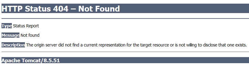

  6. I'm having some problems with my reverse proxy for a particular container (Linuxserver's Airsonic). I recently updated my containers (both Airsonic and Swag). Everything was working perfectly fine before the update. Now I get the following error : I am using the default subdomain.conf file provided with Swag (airsonic.subdomain.conf) Just to make sure, I tried deleting the config file and using the new one that gets automatically downloaded. The results stays the same. I can still access the Airsonic docker using the local address. Also, all of my other containers using Swag reverse proxy still work perfectly fine, so it seems isolated for Airsonic. The log of Swag does not bring up any error and airsonic subdomain is shown in there. Any ideas?
