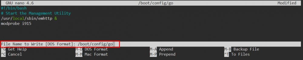

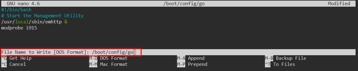

To anyone who is having trouble with the modified go file saving the changes after a system restart, you may be making the same stupid mistake as me. When you edit your go file via the terminal with "nano /boot/config/go", you then add the line "modprobe i915", and the you press CTRL+X to save, followed by Y to accept. According to the first post of this thread, "And you should be golden!" If you are new to all this, like me, you have probably just closed the window afterwards thinking all was good. After many unsuccessful attempts, I finally noticed that after following these steps, a line of text appears in the bottom of the command window the terminal : At this point, you just need to press Enter and the file will be saved. And then you can close the window... This must seem pretty basic for most of you, but hey...you gotta start somewhere
***GUIDE*** Plex Hardware Acceleration using Intel Quick Sync
I am also having this issue. I also tried "sudo nano /boot/config/go", but it doesn't save either. Have you figured this out?
