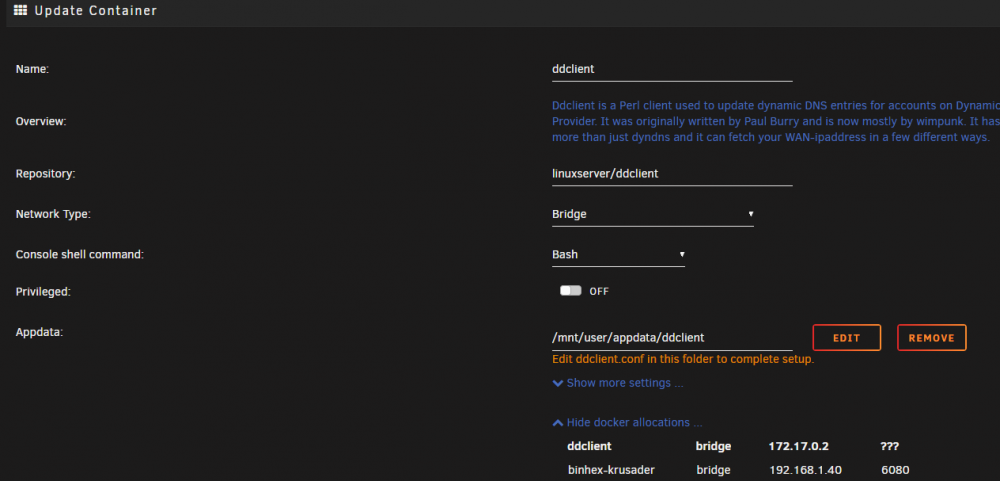

Loving the container, I've had it up and running for awhile now, but today I noticed that something has broken.  I'm not sure exactly when it happened but I do know that I updated a domain this past weekend and ddclient updated its ip so it was working as late as Sunday.  However my log is now filled with:
ErrorWarningSystemArrayLogin
readline() on closed filehandle FD at /usr/bin/ddclient line 1130.
stat() on closed filehandle FD at /usr/bin/ddclient line 1117.
Use of uninitialized value $mode in bitwise and (&) at /usr/bin/ddclient line 1118.
WARNING: file /ddclient.conf: Cannot open file '/ddclient.conf'. (Permission denied)
I'm not sure how the permission on the config file was changed and I'm really unsure of how to fix it, as linux command line is not something I have a lot of experience with..  Thanks!
Please post your docker run command and also the output of the command docker exec -it ddclient ls -al /ddclient.conf
