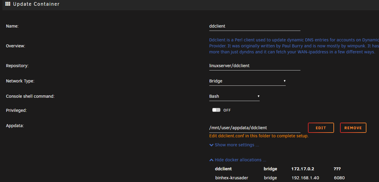

Hi, just curious...I checked for the Network_type this docker uses and it shows:
ddclientbridge172.17.0.2???
ddclient  bridge   172.17.0.2    ???
If I selected bridge why is it using not my actual unraid ip and instead uses 172.11.0.2 (which belongs to
docker0)?
docker0)?
Where do you see this?
Every container get an ip from the docker network when it's using a bridge. If you look at the unraid docker tab you will see the unraid and the docker ip mapping.
If I look at the docker tab you see this:
 And if you select "edit" in the docker ddclient > look at "docker allocation" and you see this:

Oh, yeah. ddclient doesn't need any port mappings, so unraids webui can't extract any info about the ports and therefor doesn't show anything. So nothing to worry about.
Ok. I understand that about ports. But dont understand how it is assigned 172.17.0.2 instead of 192.168.1.40. ddclient network_type=bridge, so it should have this ip 192.168.1.40?
Also, I get this error in ddclient log:
WARNING: cannot connect to dynamicdns.park-your-domain.com:80 socket: IO::Socket::INET: Bad hostname 'dynamicdns.park-your-domain.com'
ddclient updates (as I can confirm in the docker log) the right wan IP, but how can I check it is connecting to namecheap and sends it to namecheap?
Edited by luca2
added error in log:
I already said that every container get an IP like that when using the bridge. That is the internal doker networks IP range.
Did you try to access that URL in your browser? It gives an error.
You can set the IP in namecheap to something else and then see if ddclient updates the IP to the correct one.
Edited by saarg
Hi saarg, first thing thx for your support.
I finally had to spend some time to learn about the basic concepts to setup a domain (host, subdomain, A record, Ddns, Cname,...). I know now the problem was due to a wrong config in my domain at namecheap. Now it is working.
Anyway I managed to implement a script in my router so that my IP is updated even with unraid powered off. In case anyone is interested in it let me know.
