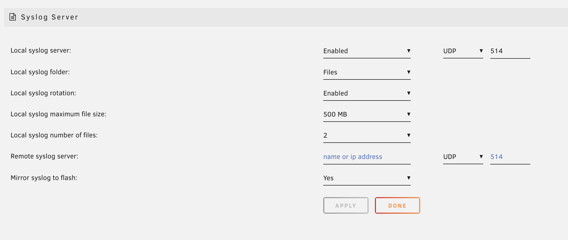

Between 20 minutes and 2 hours unraid stops responding and all VMs/docker images become unresponsive. I start seeing this ``` ping: sendto: Host is down ``` I've changed my Network Settings to: ``` Enable Bonding : No Enable Bridging : No Docker -> Host access to custom networks: Enabled ``` Since I read in the release notes this can help, for 6.12.4, I didn't have any issues in 6.12.3, but rolling back now doesn't appear to resolve the issue. I've switched out my USB stick because I was getting weird boot errors, this doesn't appear to be the issue...During all these hard power down cycles and reboots I also got a SMART Error on my Parity Drive (new drive coming today) although this might of been a false positive. I enable syslog, but i'm not sure I did it right... tower-diagnostics-20230911-1128.zip
