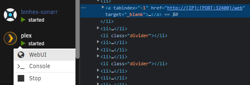

  2. Go to the Plex container, edit settings, switch to advanced view by cliking "basic view" on the top right. Now find the "WebUI" entry and change it to the actual ip and port you use for Plex. Mine is below as an example:
  3. I just tried explicitly specifying in docker edit settings and it works fine now. Not sure what caused it to start this behavior though.

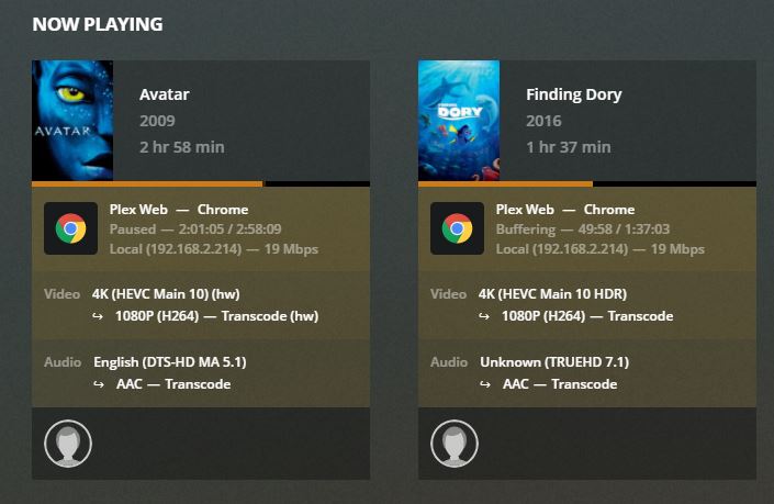

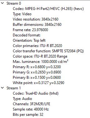

  14. Of course just as I posted that I have somewhat of a positive result.... I tried playing a different "test 4K video", this time avatar instead of finding dory and... ITS WORKING? But not on other 4K files? Finding dory still doesn't work, how/why would it work on some files and not others? Check out the screenshots. Both movies are MKV containers.
