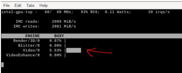

I installed the "intel-gpu-tools" docker app and ran it to see if I could spot any activity. I noticed that when I started a stream that should be a HW transcode, the first second or two showed light activity, then immediately back to 0%.
