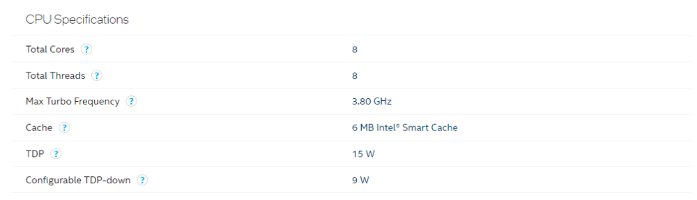

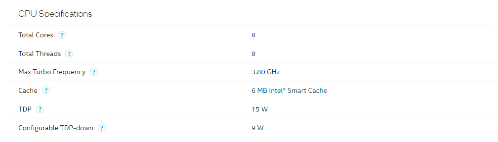

Here is Intels documentation for the chip from Intel ARK The designed TDP is 15 watts with a Max Turbo is Freq of 3.8 You are confusing different things. Max power with TDP. Unfortunately, vendors define TDP differently Intel defines it as: The CPU Package on my setup will level at 15 watts after a brief boost period. So this seems pretty accurate. Don't confuse Max Boost clock speed with power usage. The N100 shows this in Intel ARK So the package power will drop to 6 watts once the boost period is over. which is generally about 30 seconds. Ofcourse this is all assuming that the bios isn't configured to override it. I also found that my unit was set from the factory to actually limit the package power to 10 watts instead of 15 which is default. You also can't forget that the total power of the system is not necessarily reflective of CPU power usage. My unit idles around 10-17 watts. I have hooked up a different power meter and i am seeing larger dips now. But the CPU Package for Video and cpu often is under 1 watt based on the package sensors. The last link in my post above was a new AMD option from CWWK with a Ryzen 7840HS cpu. You may want to look at that.
