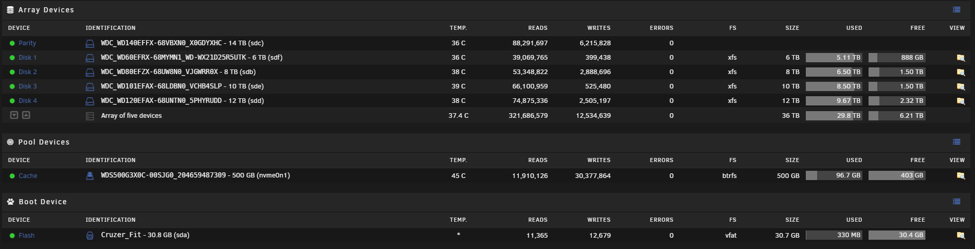

  19. Hi, Toshiba Enterprise hard drives seem to be sold at a much lower price than traditional NAS hard drives like WD RED. Are they suitable for home use in an Unraid system? In terms of reliability, noise, temperatures. Specifically asking about MG08 14TB with helium inside - https://www.newegg.com/toshiba-mg08aca14te-14tb/p/N82E16822149785 My current setup: Wanted to replace the 6TB data HDD (which is more than 5 years old) with 14TB. Thanks
