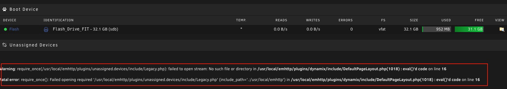

  6. Success! That worked! You sir, are a genius. FYI my folder path was a bit different. I ran the below command and then installed UD again. rm /boot/config/plugins/unassigned.devices/*.tgz

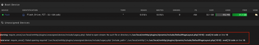

  8. Tried that already. No dice. I've kinda tried all the obvious things. I can confirm the `Legacy.php` file the template is looking for is straight up missing. Not sure how this happened and not sure how to get it back. - Attempted rebooting Unraid multiple times - Attempted reinstalling Unassigned Devices I'll be attempting to boot into safe mode later today to see what happens. Would appreciate anyone's guidance on where to look.
  9. Unassigned Devices UI can no longer load. See the screenshot to observe the php include error I'm seeing? And ideas how to resolve?
