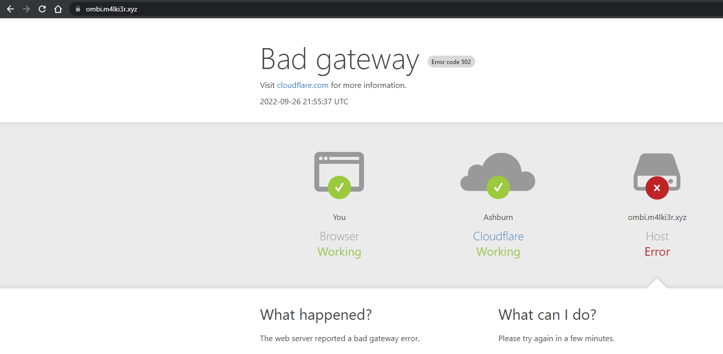

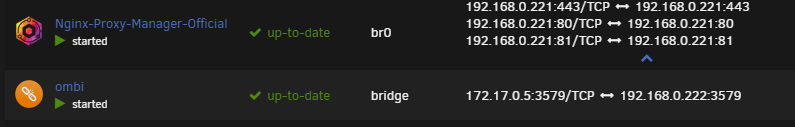

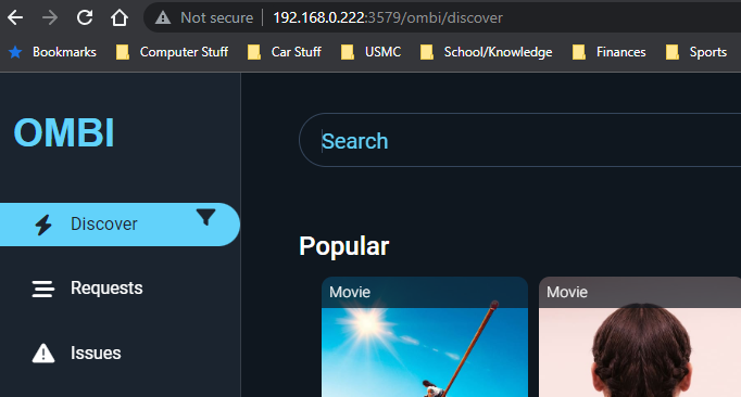

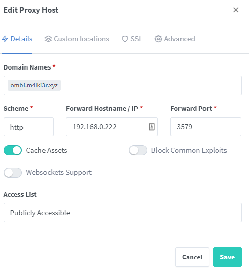

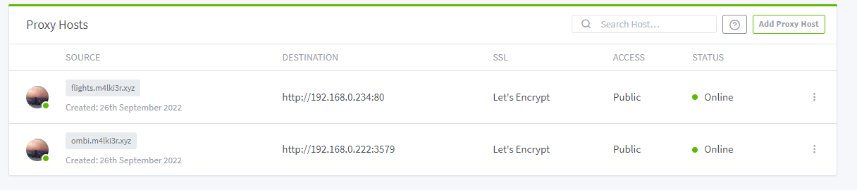

  16. I'm having trouble getting NPM to forward to my Ombi docker container. Both NPM and Ombi are hosted on the same unraid server. I can get NPM to forward to an external raspberry pi, but not to ombi on the same machine. I can access ombi by IP directly but not FQDN. My configs are below. What am I doing wrong here?
