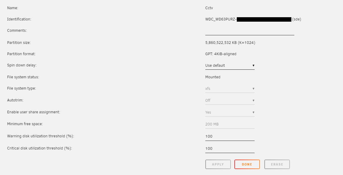

Output of requested command: root@Backup:~# hdparm -I /dev/sde | grep TRIM * Data Set Management TRIM supported (limit 10 blocks) root@Backup:~# The drive configuration, incase it helps:
