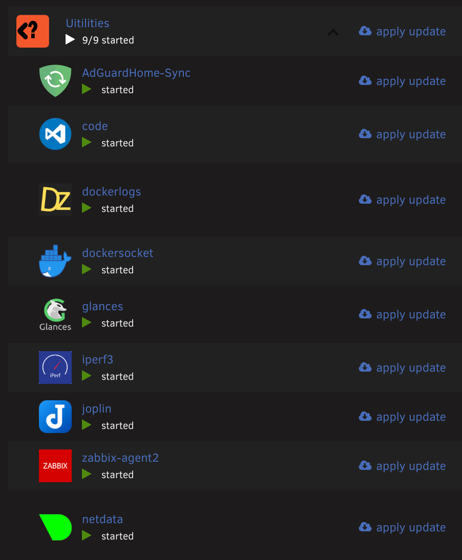

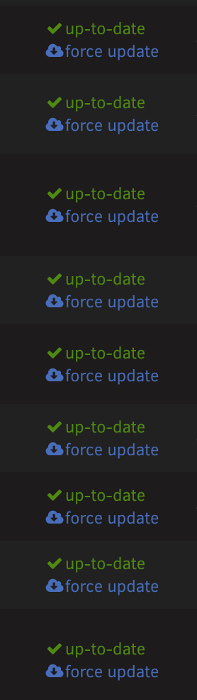

  3. is there any issues with dockers showing updates , even if is just 1 the whole folder shows apply update, and even after update it doesn't go away, i exported a backup and when no folders configured the single docker that needed the update shows fine. I even deleted the docker.img and recreated everything thinking it was corrupted. Refreshing page shows a force update for all of them, even if no advanced view is checked

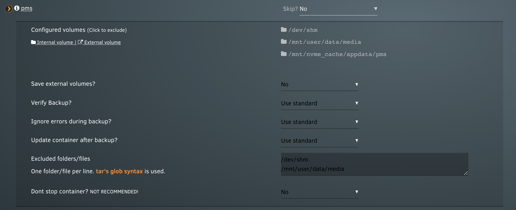

  6. any way to skip all my media from being backed up , I have to manually exclude
