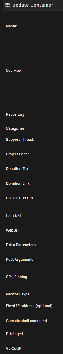

  2. So I turned on Template Authoring in the settings and re-enabled docker. But when I go to edit a container's spec, in advanced mode, I don't see any TemplateURL variables. Below is a snippet of the linuxserver/plex template in advanced mode. "VERSION" is the start of the container's variables.
  3. It is definitely just an annoyance to me as I don't want the ports to show back up as then they could be accessed from outside the reverse proxy. So I will try this method. Thanks!
  4. Running UnRaid 6.8.3. I have docker containers that I don't want accessible outside of a reverse proxy. So I edited the container and removed the PORTs specified. Everything works fine til I go in and "Check for Updates" followed by "Apply Update". Then the PORTs I removed will be readded to the container's spec. I thought this was just checking the docker repository for a new image. Is this doing something more with checking the templates in "Community Applications" or something? Thanks for the help!
