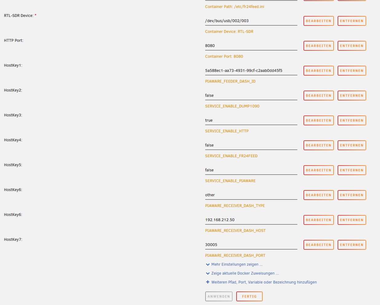

  1. Dear community, I'm too stupid to get this docker to work and my English is too bad to understand what it takes to make it work. I've tried it 4 or 5 times now with no luck. I had used the German "instructions" by @mgutt here: I was able to establish a connection to flightaware at least once, but it broke and it hasn't worked since then. According to the instructions mgutt refers to, install the docker fr24feed-piaware and then register with flightaware: https://flightaware.com/account/join/ and then runs the following command lines in Docker Terminal: docker run -it --rm \ -e "SERVICE_ENABLE_DUMP1090=false" \ -e "SERVICE_ENABLE_HTTP=false" \ -e "SERVICE_ENABLE_FR24FEED=false" \ thomx/fr24feed-piaware /bin/bash In my case, FlightAware automatically recognized my "transmitter" and added it to my account. Not such a nice side effect, another Docker was created under Unraid with some strange name. and I can neither call up the WebUI over 8080 nor over 8754 to set anything there. Another user told me I could store the commands directly as a variable in Docker, then I save myself the input via the terminal and don't get such a strange additional docker. So I'm into the guide: https://hub.docker.com/r/thomx/fr24feed-piaware and used FlightAware's variables and entered them as follows: Since I'm basically not sure whether the way I installed and set it up is correct, I can't rule out that the error is already there. Finally, the instructions are much more complex than what I did. I don't even know what this FEEDER DASH ID is. Is it the unique identifier I entered there or is it just my FlightAware username. When I look at your pictures of your setups, it looks fundamentally different and there are values that do not match those I used for FlightAware. I was able to start Docker with the settings and it is running - although there are a few entries in the log that probably have errors. s6-rc: info: service dump1090: starting s6-rc: info: service s6rc-oneshot-runner: starting s6-rc: info: service dump1090 successfully started s6-rc: info: service netcat: starting s6-rc: info: service netcat successfully started s6-rc: info: service s6rc-oneshot-runner successfully started s6-rc: info: service fix-attrs: starting s6-rc: info: service init-upintheair: starting s6-rc: info: service confd-piaware: starting s6-rc: info: service confd-layers: starting s6-rc: info: service confd-html: starting s6-rc: info: service confd-fr24feed: starting s6-rc: info: service conf-planefinder: starting s6-rc: info: service conf-adsbexchange: starting s6-rc: info: service fix-attrs successfully started s6-rc: info: service legacy-cont-init: starting s6-rc: info: service legacy-cont-init successfully started s6-rc: info: service init-upintheair successfully started s6-rc: info: service conf-planefinder successfully started s6-rc: info: service planefinder: starting s6-rc: info: service conf-adsbexchange successfully started s6-rc: info: service adsbexchange-feed: starting s6-rc: info: service confd-piaware successfully started s6-rc: info: service piaware: starting s6-rc: info: service confd-fr24feed successfully started s6-rc: info: service fr24feed: starting s6-rc: info: service planefinder successfully started s6-rc: info: service planefinder-log: starting s6-rc: info: service adsbexchange-feed successfully started s6-rc: info: service adsbexchange-stats: starting s6-rc: info: service adsbexchange-mlat: starting s6-rc: info: service piaware successfully started s6-rc: info: service fr24feed successfully started s6-rc: info: service adsbexchange-mlat successfully started s6-rc: info: service adsbexchange-stats successfully started s6-rc: info: service planefinder-log successfully started 2022-12-17T15:29:33+01:00 Tower /opt/confd/bin/confd[101]: INFO Backend set to env 2022-12-17T15:29:33+01:00 Tower /opt/confd/bin/confd[92]: INFO Backend set to env 2022-12-17T15:29:33+01:00 Tower /opt/confd/bin/confd[101]: INFO Starting confd 2022-12-17T15:29:33+01:00 Tower /opt/confd/bin/confd[101]: INFO Backend source(s) set to 2022-12-17T15:29:33+01:00 Tower /opt/confd/bin/confd[92]: INFO Starting confd 2022-12-17T15:29:33+01:00 Tower /opt/confd/bin/confd[92]: INFO Backend source(s) set to 2022-12-17T15:29:33+01:00 Tower /opt/confd/bin/confd[92]: INFO Target config /usr/lib/fr24/public_html/layers.js out of sync 2022-12-17T15:29:33+01:00 Tower /opt/confd/bin/confd[92]: INFO Target config /usr/lib/fr24/public_html/layers.js has been updated 2022-12-17T15:29:33+01:00 Tower /opt/confd/bin/confd[101]: INFO /usr/lib/fr24/public_html/config.js has UID 99 should be 0 2022-12-17T15:29:33+01:00 Tower /opt/confd/bin/confd[101]: INFO /usr/lib/fr24/public_html/config.js has GID 100 should be 0 2022-12-17T15:29:33+01:00 Tower /opt/confd/bin/confd[101]: INFO /usr/lib/fr24/public_html/config.js has mode drwxrwxrwx should be -rwxrwxrwx 2022-12-17T15:29:33+01:00 Tower /opt/confd/bin/confd[101]: INFO /usr/lib/fr24/public_html/config.js has md5sum d41d8cd98f00b204e9800998ecf8427e should be 8538a54a6ad0763a4aad43aba067cecd 2022-12-17T15:29:33+01:00 Tower /opt/confd/bin/confd[101]: INFO Target config /usr/lib/fr24/public_html/config.js out of sync 2022-12-17T15:29:33+01:00 Tower /opt/confd/bin/confd[101]: ERROR rename /usr/lib/fr24/public_html/.config.js099368113 /usr/lib/fr24/public_html/config.js: file exists 2022-12-17T15:29:33+01:00 Tower /opt/confd/bin/confd[101]: FATAL rename /usr/lib/fr24/public_html/.config.js099368113 /usr/lib/fr24/public_html/config.js: file exists s6-rc: info: service confd-layers successfully started s6-rc: warning: unable to start service confd-html: command exited 1 This error is displayed to me: 2022-12-17T15:29:33+01:00 Tower /opt/confd/bin/confd[101]: ERROR rename /usr/lib/fr24/public_html/.config.js099368113 /usr/lib/fr24/public_html/ config.js: file exists and as a warning: s6-rc: warning: unable to start service confd-html: command exited 1 But I have no idea what that means or how I should correct it. Needless to say, I still can't access the 8080 or 8754 and with flightaware, no active ads-b "sender" is displayed to me either So to summarize: How can I get the WebUI over 8080 and the admin page over 8754? How do I get the transmitter running and connected to flightaware? What are these errors and above all - how do I have to install and configure it under Unraid so that it works? IS THERE REALLY NONE OF ME THE VIA PN CAN EXPLAIN IN GERMAN translated via google
  2. can someone please help me in german / kann mir jemand bitte auf deutsch helfen Ich hatte hier schon versucht Hilfe zu finden: Es funktioniert nicht und ich weiß nicht wie ich es zum laufen kriege
  3. http://192.168.212.50:8080 (Links Klick Docker - WebUI) und http://192.168.212.50:8754 sind aber trotzdem nicht erreichbar. Und unter FlightAware wird mir auch kein Aktiver ADS-B angezeigt 😔
  4. Ich hab jetzt alles an Werten eingetragen die ich in der Anleitung gesehen habe und hoffe das passt so zu meinem Unraid Setup Wenn ich ganz am Ende auf Anwenden gehe und der Docker die Änderungen übernimmt zeigt er mir das an: root@localhost:# /usr/local/emhttp/plugins/dynamix.docker.manager/scripts/docker create --name='fr24feed-piaware' --net='host' -e TZ="Europe/Berlin" -e HOST_OS="Unraid" -e 'TCP_PORT_8080'='8080' -e 'PIAWARE_FEEDER_DASH_ID'='5a588ec1-aa73-4931-99cf-c2aab0dd45f5' -e 'SERVICE_ENABLE_DUMP1090'='false' -e 'SERVICE_ENABLE_HTTP'='true' -e 'SERVICE_ENABLE_FR24FEED'='false' -e 'SERVICE_ENABLE_PIAWARE'='false' -e 'PIAWARE_RECEIVER_DASH_TYPE'='other' -e 'PIAWARE_RECEIVER_DASH_HOST'='192.168.212.50' -e 'PIAWARE_RECEIVER_DASH_PORT'='30005' -e 'TCP_PORT_8754'='8754' -v '/mnt/user/appdata/fr24feed-piaware/piaware.conf':'/etc/piaware.conf':'rw' -v '/mnt/user/appdata/fr24feed-piaware/config.js':'/usr/lib/fr24/public_html/config.js':'rw' -v '/mnt/user/appdata/fr24feed-piaware/fr24feed.ini':'/etc/fr24feed.ini':'rw' --device='/dev/bus/usb/002/003' 'thomx/fr24feed-piaware' ea2ff766e1b728989156606f075627c36ef0f9630c6d8b72d37d3748e8884e79 Der Befehl wurde erfolgreich ausgeführt! Die Protokolldatei nach Start des Dockers zeigt mir das an: s6-rc: info: service dump1090: starting s6-rc: info: service s6rc-oneshot-runner: starting s6-rc: info: service dump1090 successfully started s6-rc: info: service netcat: starting s6-rc: info: service netcat successfully started s6-rc: info: service s6rc-oneshot-runner successfully started s6-rc: info: service fix-attrs: starting s6-rc: info: service init-upintheair: starting s6-rc: info: service confd-piaware: starting s6-rc: info: service confd-layers: starting s6-rc: info: service confd-html: starting s6-rc: info: service confd-fr24feed: starting s6-rc: info: service conf-planefinder: starting s6-rc: info: service conf-adsbexchange: starting s6-rc: info: service fix-attrs successfully started s6-rc: info: service legacy-cont-init: starting s6-rc: info: service legacy-cont-init successfully started s6-rc: info: service init-upintheair successfully started s6-rc: info: service conf-planefinder successfully started s6-rc: info: service planefinder: starting s6-rc: info: service conf-adsbexchange successfully started s6-rc: info: service adsbexchange-feed: starting s6-rc: info: service confd-piaware successfully started s6-rc: info: service piaware: starting s6-rc: info: service confd-fr24feed successfully started s6-rc: info: service fr24feed: starting s6-rc: info: service planefinder successfully started s6-rc: info: service planefinder-log: starting s6-rc: info: service adsbexchange-feed successfully started s6-rc: info: service adsbexchange-stats: starting s6-rc: info: service adsbexchange-mlat: starting s6-rc: info: service piaware successfully started s6-rc: info: service fr24feed successfully started s6-rc: info: service adsbexchange-mlat successfully started s6-rc: info: service adsbexchange-stats successfully started s6-rc: info: service planefinder-log successfully started 2022-12-17T15:29:33+01:00 Tower /opt/confd/bin/confd[101]: INFO Backend set to env 2022-12-17T15:29:33+01:00 Tower /opt/confd/bin/confd[92]: INFO Backend set to env 2022-12-17T15:29:33+01:00 Tower /opt/confd/bin/confd[101]: INFO Starting confd 2022-12-17T15:29:33+01:00 Tower /opt/confd/bin/confd[101]: INFO Backend source(s) set to 2022-12-17T15:29:33+01:00 Tower /opt/confd/bin/confd[92]: INFO Starting confd 2022-12-17T15:29:33+01:00 Tower /opt/confd/bin/confd[92]: INFO Backend source(s) set to 2022-12-17T15:29:33+01:00 Tower /opt/confd/bin/confd[92]: INFO Target config /usr/lib/fr24/public_html/layers.js out of sync 2022-12-17T15:29:33+01:00 Tower /opt/confd/bin/confd[92]: INFO Target config /usr/lib/fr24/public_html/layers.js has been updated 2022-12-17T15:29:33+01:00 Tower /opt/confd/bin/confd[101]: INFO /usr/lib/fr24/public_html/config.js has UID 99 should be 0 2022-12-17T15:29:33+01:00 Tower /opt/confd/bin/confd[101]: INFO /usr/lib/fr24/public_html/config.js has GID 100 should be 0 2022-12-17T15:29:33+01:00 Tower /opt/confd/bin/confd[101]: INFO /usr/lib/fr24/public_html/config.js has mode drwxrwxrwx should be -rwxrwxrwx 2022-12-17T15:29:33+01:00 Tower /opt/confd/bin/confd[101]: INFO /usr/lib/fr24/public_html/config.js has md5sum d41d8cd98f00b204e9800998ecf8427e should be 8538a54a6ad0763a4aad43aba067cecd 2022-12-17T15:29:33+01:00 Tower /opt/confd/bin/confd[101]: INFO Target config /usr/lib/fr24/public_html/config.js out of sync 2022-12-17T15:29:33+01:00 Tower /opt/confd/bin/confd[101]: ERROR rename /usr/lib/fr24/public_html/.config.js099368113 /usr/lib/fr24/public_html/config.js: file exists 2022-12-17T15:29:33+01:00 Tower /opt/confd/bin/confd[101]: FATAL rename /usr/lib/fr24/public_html/.config.js099368113 /usr/lib/fr24/public_html/config.js: file exists s6-rc: info: service confd-layers successfully started s6-rc: warning: unable to start service confd-html: command exited 1

  7. sooo nachdem ich ein kleines Problem mit Unraid selbst hatte (Danke an mgutt und hawihoney) versuche ich es nochmal von vorne. Bei den Apps installiere ich den Docker fr24feed-piaware und tätige folgende Einstellungen Netzwerktyp: Host (in der Anleitung steht er auf Bridge - da ist aber bei mir der 8080 Port durch NGINX bereits belegt) RTL-SDR Device: /dev/bus/usb/002/003 HTTP Port: 8080 und Admin HTTP steht bereits auf: 8754 Gemäß dieser Anleitung https://hub.docker.com/r/thomx/fr24feed-piaware habe ich einen Account bei flightaware angelegt. Die Befehlszeilen die ich über den Terminal eingeben soll, kann ich auch direkt im Docker bzw in den Einstellungen hinterlegen, wenn ich das @ich777 recht verstanden habe und somit brauche ich nicht die nachfolgende Befehlszeilen im Terminal ausführe - ist das richtig? docker run -it --rm \ -e "SERVICE_ENABLE_DUMP1090=false" \ -e "SERVICE_ENABLE_HTTP=false" \ -e "SERVICE_ENABLE_FR24FEED=false" \ thomx/fr24feed-piaware /bin/bash

  15. Wenn ich den Docker starte, wird mir das Grüne Dreieck unter dem Logo angezeigt. Aktualisiere ich den Browser ist der Docker gestoppt. Im Protokoll steht dann das: s6-rc: info: service dump1090: starting s6-rc: info: service s6rc-oneshot-runner: starting s6-rc: info: service dump1090 successfully started s6-rc: info: service netcat: starting s6-rc: info: service netcat successfully started s6-rc: info: service s6rc-oneshot-runner successfully started s6-rc: info: service fix-attrs: starting s6-rc: info: service init-upintheair: starting s6-rc: info: service confd-piaware: starting s6-rc: info: service confd-layers: starting s6-rc: info: service confd-html: starting s6-rc: info: service confd-fr24feed: starting s6-rc: info: service conf-planefinder: starting s6-rc: info: service conf-adsbexchange: starting s6-rc: info: service confd-fr24feed successfully started s6-rc: info: service fr24feed: starting s6-rc: info: service init-upintheair successfully started s6-rc: info: service confd-layers successfully started s6-rc: info: service conf-planefinder successfully started s6-rc: info: service planefinder: starting s6-rc: info: service conf-adsbexchange successfully started s6-rc: info: service adsbexchange-feed: starting s6-rc: info: service fr24feed successfully started s6-rc: info: service adsbexchange-feed successfully started s6-rc: info: service adsbexchange-stats: starting s6-rc: info: service adsbexchange-mlat: starting s6-rc: info: service adsbexchange-stats successfully started s6-rc: info: service adsbexchange-mlat successfully started [33m[piaware][0m FATAL: PIAWARE_FEEDER_DASH_ID not set! 2022-12-15T15:29:28+01:00 a42bd7eab393 /opt/confd/bin/confd[86]: INFO Backend set to env 2022-12-15T15:29:28+01:00 a42bd7eab393 /opt/confd/bin/confd[86]: INFO Starting confd 2022-12-15T15:29:28+01:00 a42bd7eab393 /opt/confd/bin/confd[86]: INFO Backend source(s) set to s6-rc: info: service fix-attrs successfully started s6-rc: info: service legacy-cont-init: starting s6-rc: info: service planefinder successfully started 2022-12-15T15:29:28+01:00 a42bd7eab393 /opt/confd/bin/confd[86]: INFO /usr/lib/fr24/public_html/config.js has UID 99 should be 0 2022-12-15T15:29:28+01:00 a42bd7eab393 /opt/confd/bin/confd[86]: INFO /usr/lib/fr24/public_html/config.js has GID 100 should be 0 2022-12-15T15:29:28+01:00 a42bd7eab393 /opt/confd/bin/confd[86]: INFO /usr/lib/fr24/public_html/config.js has mode drwxrwxrwx should be -rwxrwxrwx 2022-12-15T15:29:28+01:00 a42bd7eab393 /opt/confd/bin/confd[86]: INFO /usr/lib/fr24/public_html/config.js has md5sum d41d8cd98f00b204e9800998ecf8427e should be 8538a54a6ad0763a4aad43aba067cecd 2022-12-15T15:29:28+01:00 a42bd7eab393 /opt/confd/bin/confd[86]: INFO Target config /usr/lib/fr24/public_html/config.js out of sync [33m[piaware][0m FATAL: PIAWARE_FEEDER_DASH_ID not set! 2022-12-15T15:29:28+01:00 a42bd7eab393 /opt/confd/bin/confd[86]: ERROR rename /usr/lib/fr24/public_html/.config.js280319795 /usr/lib/fr24/public_html/config.js: file exists 2022-12-15T15:29:28+01:00 a42bd7eab393 /opt/confd/bin/confd[86]: FATAL rename /usr/lib/fr24/public_html/.config.js280319795 /usr/lib/fr24/public_html/config.js: file exists s6-rc: info: service planefinder-log: starting s6-rc: warning: unable to start service confd-html: command exited 1 [33m[piaware][0m FATAL: PIAWARE_FEEDER_DASH_ID not set! s6-rc: info: service planefinder-log successfully started [33m[piaware][0m FATAL: PIAWARE_FEEDER_DASH_ID not set! s6-rc: info: service legacy-cont-init successfully started [33m[piaware][0m FATAL: PIAWARE_FEEDER_DASH_ID not set! s6-rc: warning: unable to start service confd-piaware: command exited 1 s6-rc: info: service legacy-cont-init: stopping s6-rc: info: service planefinder-log: stopping s6-rc: info: service netcat: stopping s6-rc: info: service init-upintheair: stopping s6-rc: info: service confd-layers: stopping s6-rc: info: service fr24feed: stopping s6-rc: info: service adsbexchange-stats: stopping s6-rc: info: service adsbexchange-mlat: stopping s6-rc: info: service init-upintheair successfully stopped s6-rc: info: service planefinder-log successfully stopped s6-rc: info: service planefinder: stopping s6-rc: info: service confd-layers successfully stopped s6-rc: info: service netcat successfully stopped s6-rc: info: service adsbexchange-stats successfully stopped s6-rc: info: service legacy-cont-init successfully stopped s6-rc: info: service fix-attrs: stopping s6-rc: info: service adsbexchange-mlat successfully stopped s6-rc: info: service adsbexchange-feed: stopping s6-rc: info: service planefinder successfully stopped s6-rc: info: service conf-planefinder: stopping s6-rc: info: service fix-attrs successfully stopped s6-rc: info: service fr24feed successfully stopped s6-rc: info: service confd-fr24feed: stopping s6-rc: info: service conf-planefinder successfully stopped s6-rc: info: service confd-fr24feed successfully stopped s6-rc: info: service adsbexchange-feed successfully stopped s6-rc: info: service conf-adsbexchange: stopping s6-rc: info: service dump1090: stopping s6-rc: info: service conf-adsbexchange successfully stopped s6-rc: info: service s6rc-oneshot-runner: stopping s6-rc: info: service s6rc-oneshot-runner successfully stopped s6-rc: info: service dump1090 successfully stopped
  16. Also ich hab die Geräteadresse von diesem Eintrag abgeleitet. Dachte das wäre Richtig Ist das so Richtig oder wie muß der Schlüssel aufgebaut sein? Danke dir!!
  17. @ich777 Oh ich glaube da muß ich noch etwas Hilfe in anspruch nehmen 😔 Könntest du mir bitte zeigen wie dein Aufbau von Add another Path,Port etc für deine zusätzlichen Host Key ist. Ich weiß nicht was ich da anlegen muß Bei mir sieht das jetzt noch so aus:
