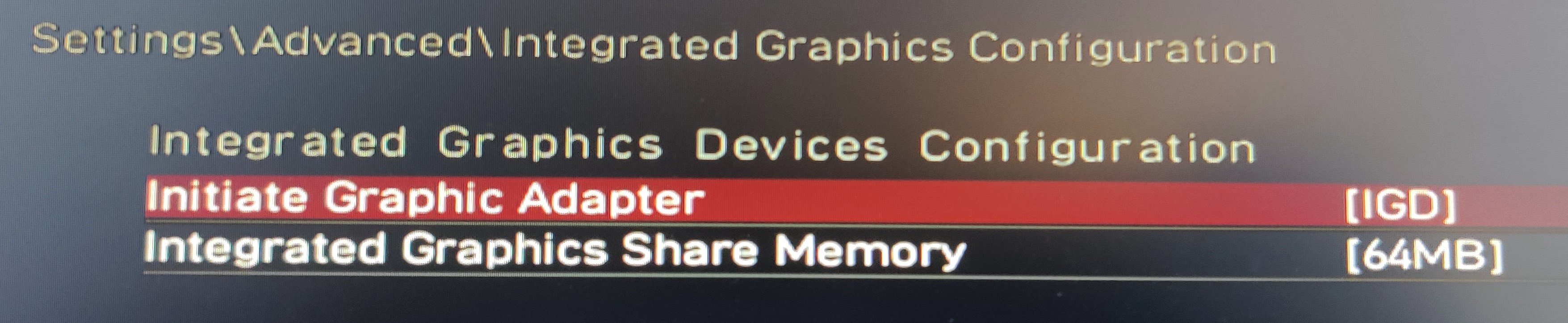

I installed the Intel GPU TOP plugin. ls -la /dev/dri returns "cannot access '/dev/dri': No such file or directory." Diagnostics attached. galaga-diagnostics-20211209-1629.zip EDIT: Attached a picture with confirmation that the iGPU is enabled in the BIOS:

Yes, the iGPU is enabled in the BIOS, set to GPU (and not PEG). I had gone through the thread you linked yesterday, but went through it again today. I did these steps: Removed all text from from i915.conf and removed all gpu-related lines from syslinux.conf uninstalled intel gpu top plugin rebooted reinstalled intel gpu top plugin rebooted - still no /dev/dri folder added "options i915 force_probe=4c8a" to i915.conf rebooted - still no /dev/dri folder added "i915.force_probe=4c8B" to syslinux.conf rebooted - now there was a /dev/dri folder, but ls -la /dev/dri/ gave me the message about no i915 being present (can't remember the exact message) So, this is where I am currently. Any other thoughts? It may be that I just need to sit on my hands until Unraid and/or Plex have releases that make this work out of the box.
