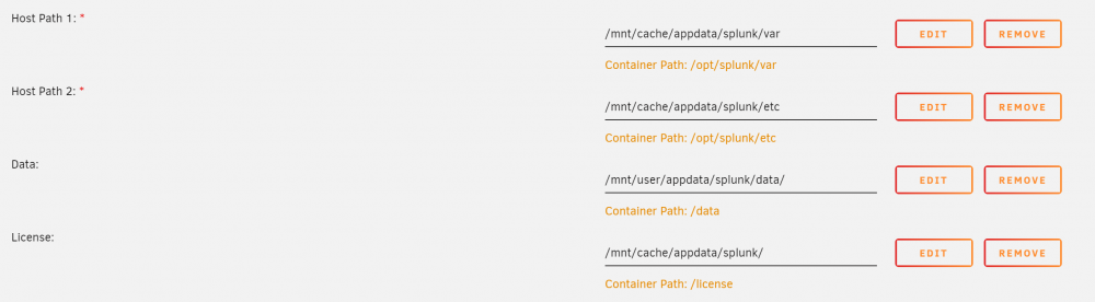

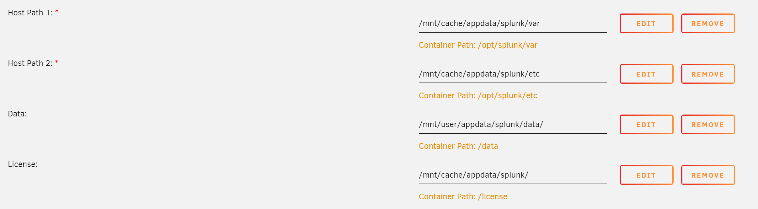

  10. This is probably a docker noob question, but I haven't run into this problem with other dockers yet. The container will start, but the log says : ERROR: Couldn't read "/opt/splunk/etc/splunk-launch.conf" -- maybe $SPLUNK_HOME or $SPLUNK_ETC is set wrong? I assume this is because I'm not mapping my volumes correctly. I've read through this thread and did some internet searching, but can't figure it out. Can anyone set me straight? Here are my volume mappings:
