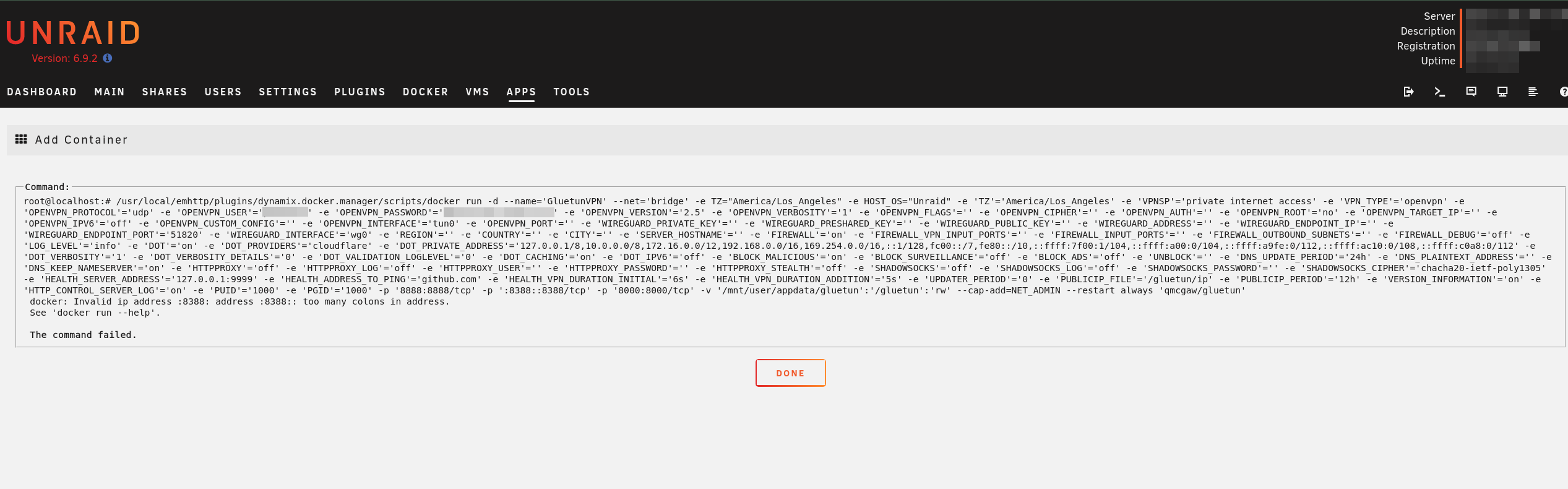

  9. Seconding the issue, however unlike darrenyorston I am completely unable to reinstall the GluetunVPN container. The container disappeared for me after an update this morning, and fails with an error on reinstall. I reported on github here but seems I should have reported here first instead. Clearing the old files from my appdata folder made no difference. This issue is urgent for me because I'm unable to reinstall the container, thus my dockers relying on GluetunVPN are down until then. vault-diagnostics-20220115-2338.zip
  10. EDIT: This was a Gluetun template issue which has now been fixed, please ignore. CA Auto Update broke my setup a bit today. I had a VPN docker (GluetunVPN) set up that a couple other dockers run through (--net=container:GluetunVPN) , and when the VPN was auto-updated this morning it broke/removed the Gluetun install, which left a few other dockers stuck in a perpetual "rebuilding" stage looking for the VPN to route through. This has never been an issue manually clicking update on Gluetun, but this was the first time it auto updated via the plugin. I've attached diagnostics file.
