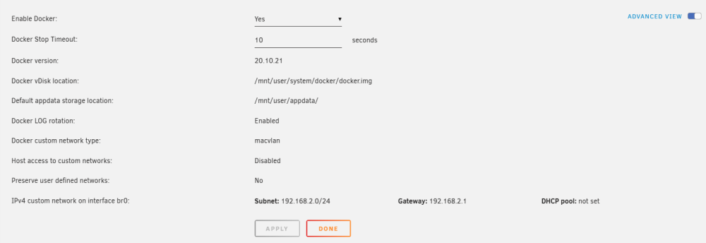

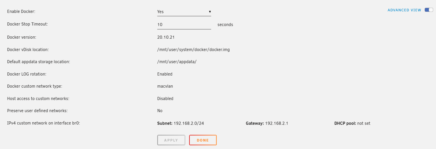

  11. diagnostics 901server-diagnostics-20230926-0021.zip
  12. Version: 6.11.5 2 Cache with raid 0 1 parity plugins didn't disappear also the setting for plugins are there.

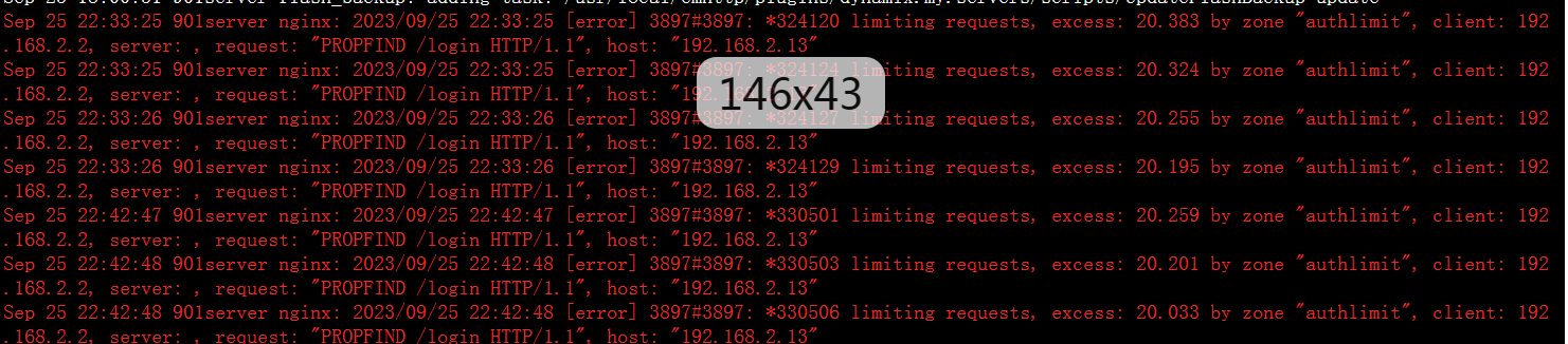

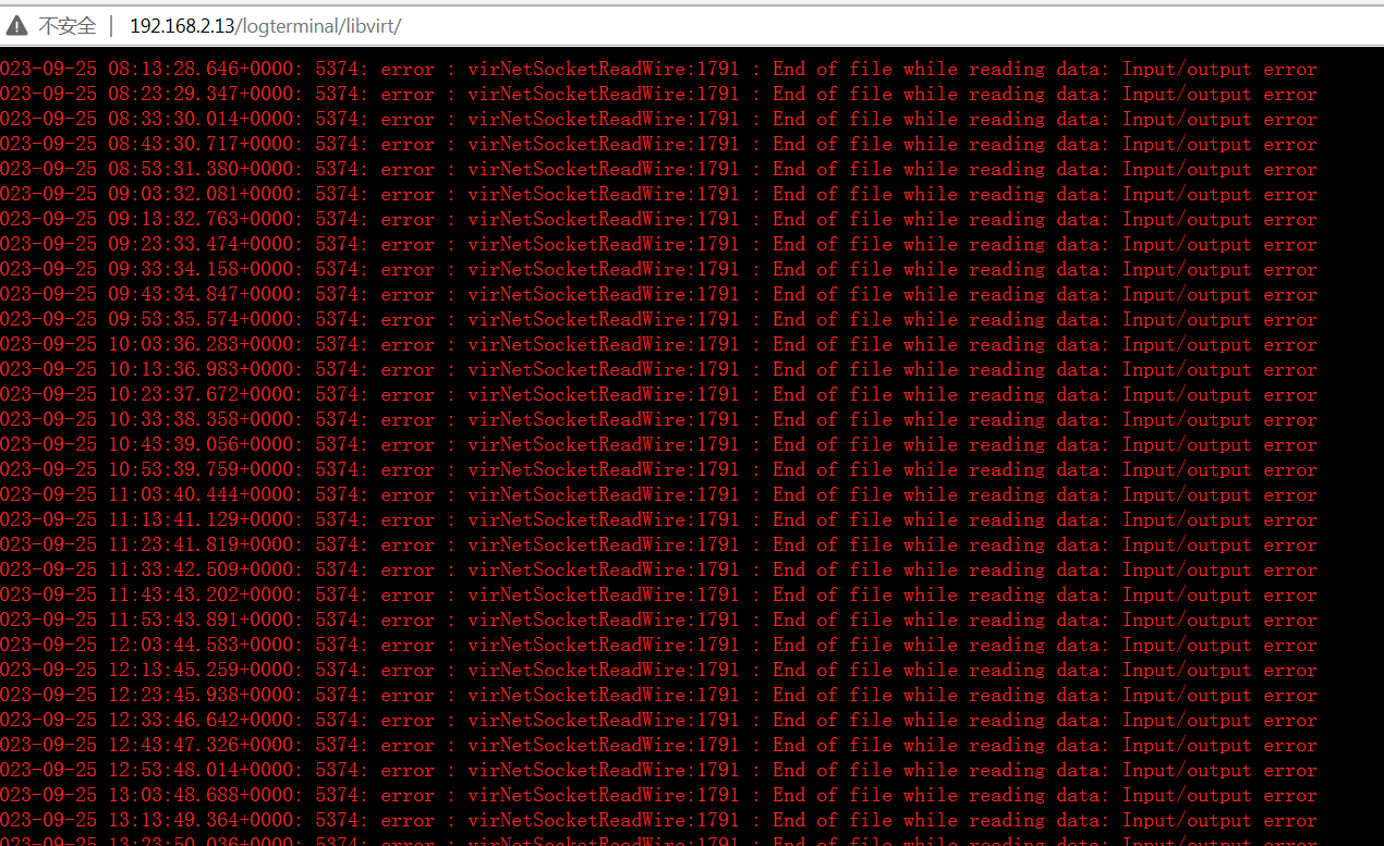

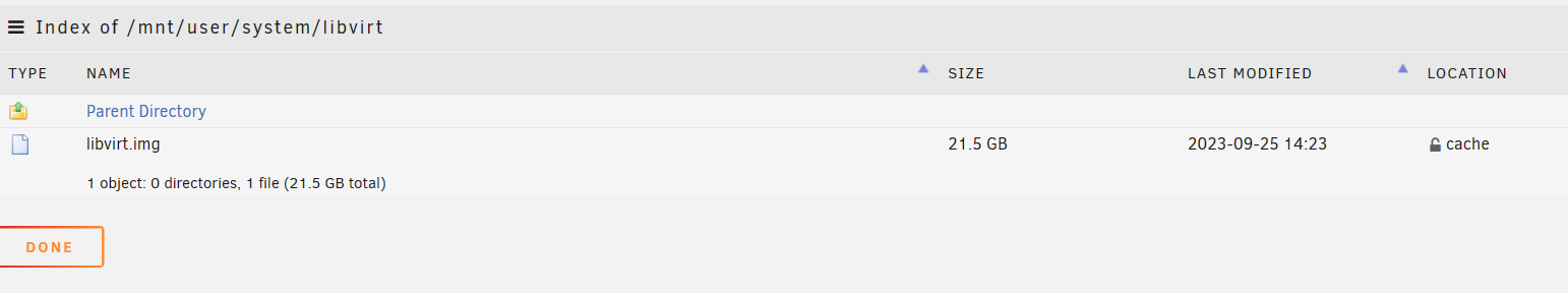

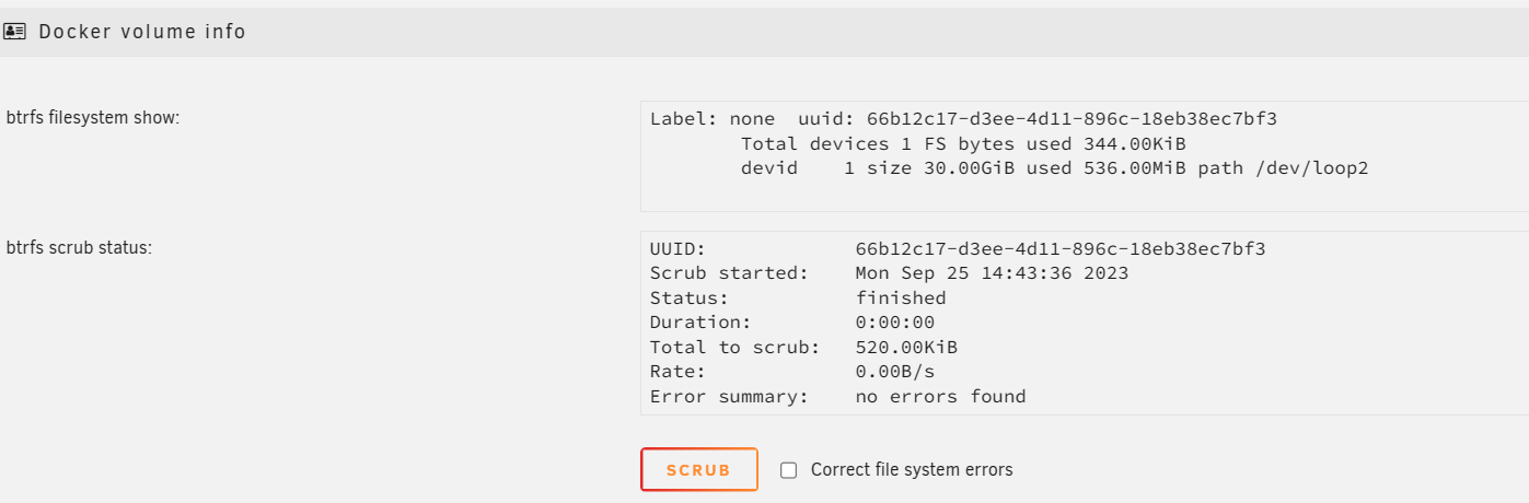

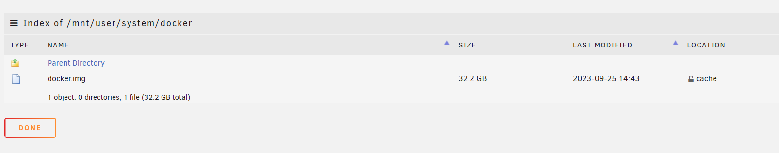

  13. as title, docker & vm all gone, but docker.img & libvirt.img are still there, no disk in error. just after a reboot, all the dockers & vm gone. location remain in default. syslog error Sep 25 22:42:59 901server nginx: 2023/09/25 22:42:59 [error] 3897#3897: *330650 limiting requests, excess: 20.651 by zone "authlimit", client: 192.168.2.2, server: , request: "PROPFIND /login HTTP/1.1", host: "192.168.2.13" libvirt log error 2023-09-25 11:23:41.819+0000: 5374: error : virNetSocketReadWire:1791 : End of file while reading data: Input/output error

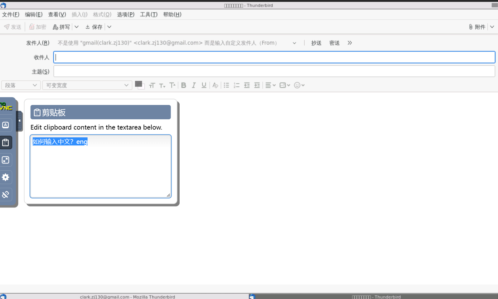

  15. Tried with Edge, Safari, still not work, when i type the Chinese characters, it didn't appear on the bar.
  16. Usually i use Edge, other browser i may try later also.

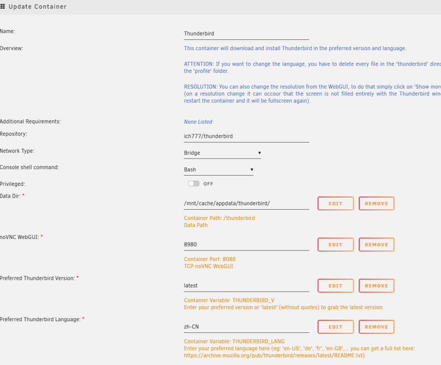

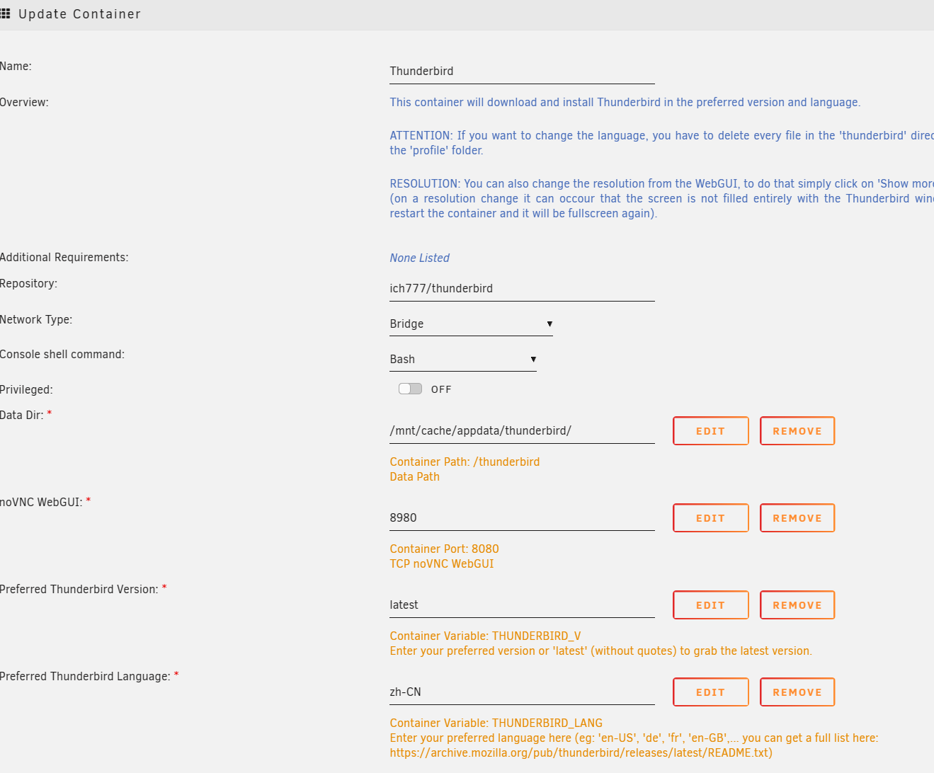

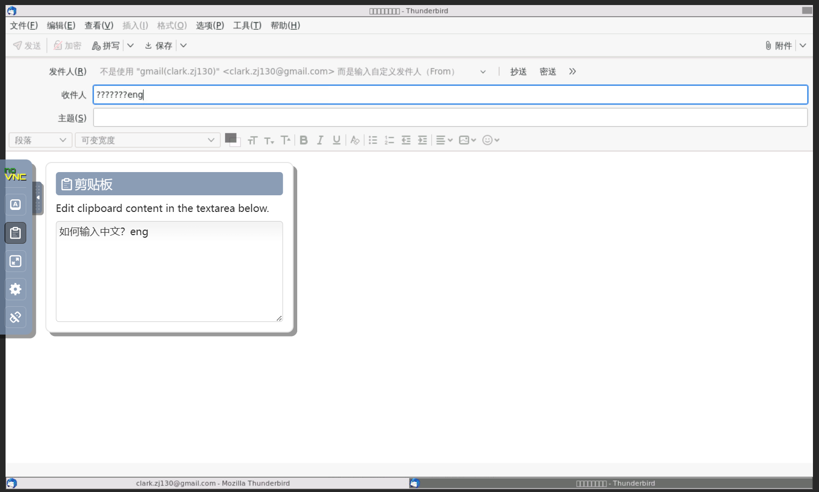

  17. @ich777 Also even i use the system's native Chinese input, i can't input Chinese characters in the VNC client. is there any solution to make that works or we still need to wait for an update to the VNC version? Secondaly, as you mentioned above, it seems this container(thunderbird) also has a WebUI version, could you give more information for that? I would like to try it, thanks.
  18. I use vnc client, by the way, i can't found this container built in webui. @ich777
  19. also the same problem with chrome.
  20. @ich777 i am using thunderbird to manage my emails, but i can't input chinese, how to solve that?
