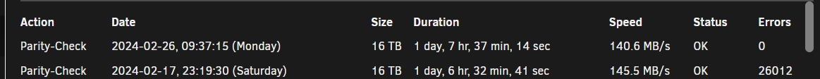

  7. After upgrading to 6.12.8 my server randomly shut down and triggered parity check where 26012 errors were found/corrected. I double checked all the drives and nothing appears to be reporting any error or failure. My scheduled parity check just completed with 0 errors (although for some reason the notification still said 26012. Is there anything else I should be checking?
