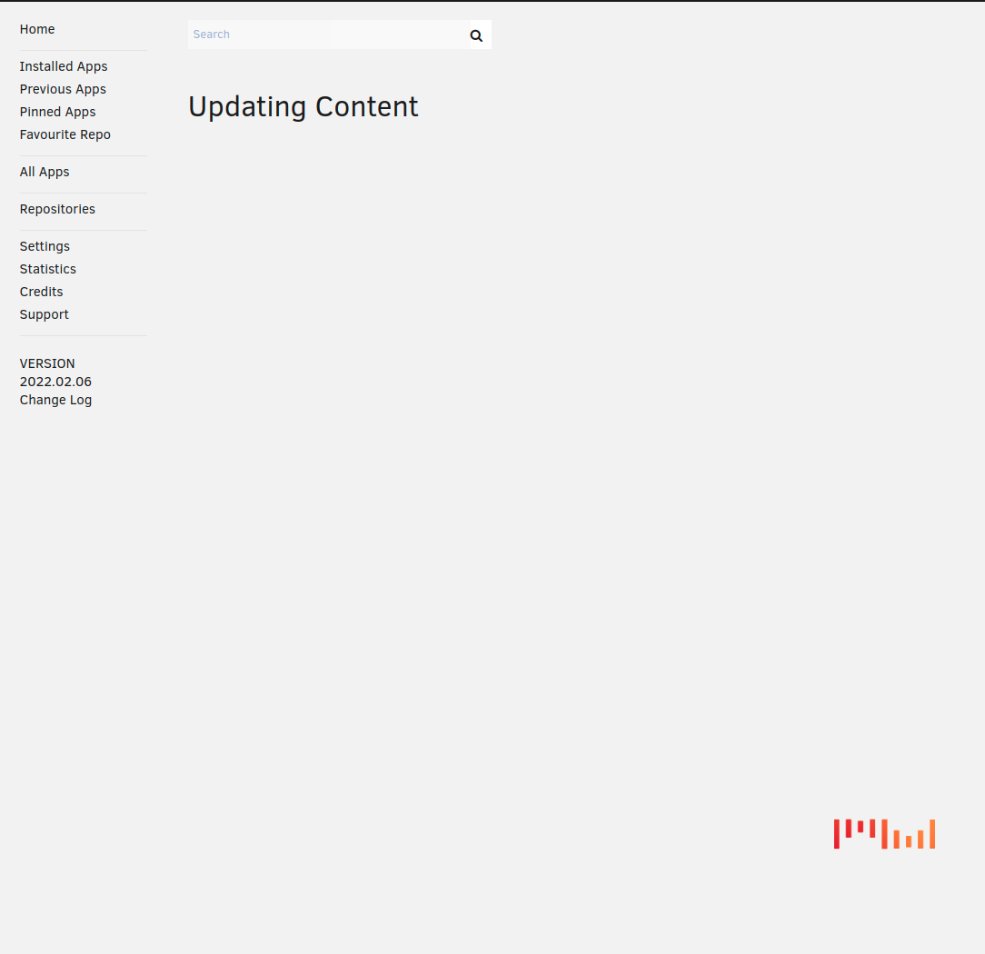

I found the issue as it looks. It works as long as the parity sync is not running. As soon as I start it, I'm running indeed out of memory if the community app tries to download the app catalog and get just killed by linux lacking memory. Now, the issue is: I cannot upgrade the RAM, I have already to failed tries in finding a SO-DIMM which is accepted by the board/bios. (2G/4G nothing works) Anyway, question is, if I can still make use of this otherwise working hardware by somehow enable swap. Right now I can't do this via the swap plugin: it requires the array to be online to have a space to store the file. If the array is online there is not even enough memory so the swap file can get created and written. The process simply gets killed again before finished. Any ideas how to still make use of that box with unraid? Background is also that I really wanna test it a bit, before considering switching my productive nas. Unfortunately it doesn't seem to be possible to checkout unraid in a vm, at least with a quick shot mapping an USB stick as device into an vmdk...
Ah, ok, thanks. That was the right hint. I was searching for the kernel panic error msg. which misled me a bit. I wonder why that parameter is necessary. To start an installation with that kind of hack right away is a bit surprising. I'm currently considering to also use unraid on my productive NAS, which is a brand new ts-364. But I'm already facing the next issue in unraid with loading the apps being stuck with "updating content". I've changed the DNS to google already, but then cannot not see why unraid shouldn't be able to work with the router like any other appliance here. The ts439 only has 1GB but then if then in htop that doesn't look like an issue, zero swap used so far.... Looks difficult.
