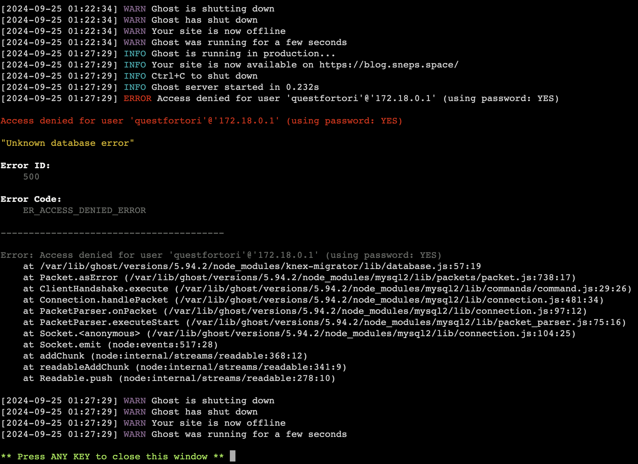

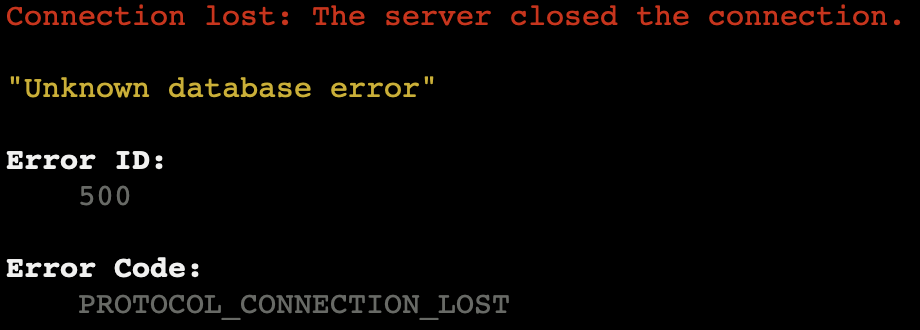

  2. Thanks! I put that variable in, but now I get a different error: (I'm sure that the database container is running and accepting connections, on the same virtual network as MySQL
  3. Having some trouble getting the Ghost docker container set up. I set up a MySQL8 docker to act as its database and set the username, password, and database name in the Ghost docker definition. The only thing I had to change is the port of the MySQL container since it uses the same port as my MariaDB container. I changed it, but the Ghost container doesn't have a place to specify a port for the database IP, and adding one seems to cause a connection error. When I use the raw IP and the correct login info, I get this error when starting the Ghost container:

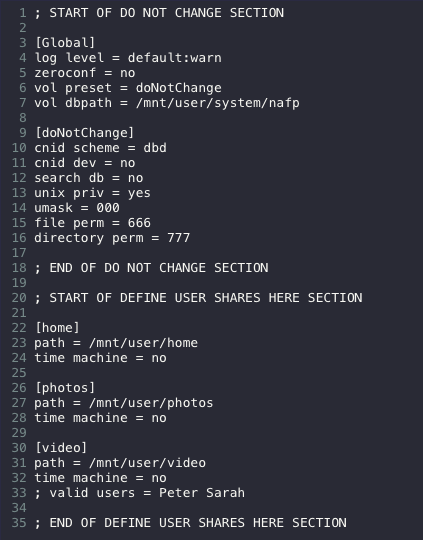

  5. Sure, thank you for the help! When looking in the Chooser, I don't see any servers appear.
  6. Has anyone successfully gotten this working with classic (Pre-OS X) versions of MacOS? I'm trying to get the share to appear on System 7.5.3 but the shares don't appear in Chooser.

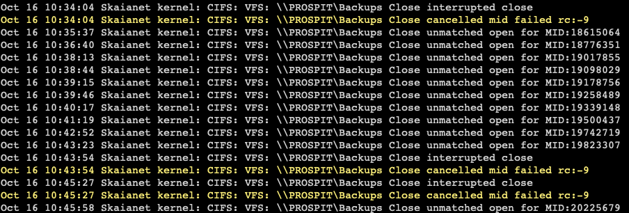

  8. Gotcha, here you go: skaianet-diagnostics-20231016-1051.zip
  9. Hmm, I'm still seeing these same errors in the logs after switching to ipvlan, should I still be worried?

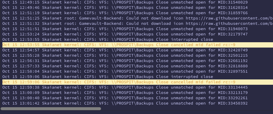

  13. Sure, here is the output zip from the diagnostics menu from my server (Though this is before has crashed yet on this power-on cycle). Also, the remote server is an x86 Synology NAS on the same network. skaianet-diagnostics-20231015-1838.zip

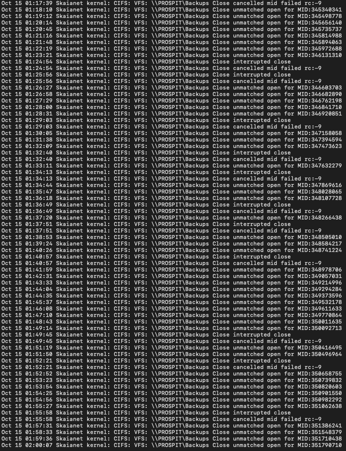

  14. After updating past Unraid 6.10, I get constant log errors regarding the network share I have mounted. I can't even unmount it because it says it's always busy. Can anyone offer help? This seems to keep crashing my whole server every day or two.
