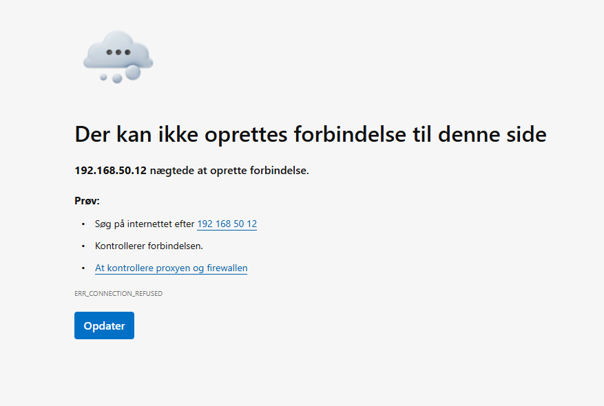

  6. I have received help from the Unraid feedback option in the bug report. So I rebooted and that solved it. I must have messed up. Thx to the unraid support
  7. Hallo After installing portainer and working on adminer not finding :3306 mariaDB... The changes that I made in portainer led to this mess: Warning: stream_socket_client(): unable to connect to unix:///var/run/docker.sock (Connection refused) in /usr/local/emhttp/plugins/dynamix.docker.manager/include/DockerClient.php on line 712 Couldn't create socket: [111] Connection refused Warning: Invalid argument supplied for foreach() in /usr/local/emhttp/plugins/dynamix.docker.manager/include/DockerClient.php on line 898 Warning: stream_socket_client(): unable to connect to unix:///var/run/docker.sock (Connection refused) in /usr/local/emhttp/plugins/dynamix.docker.manager/include/DockerClient.php on line 712 Couldn't create socket: [111] Connection refused Warning: Invalid argument supplied for foreach() in /usr/local/emhttp/plugins/dynamix.docker.manager/include/DockerClient.php on line 967 Do I have have to reinstall the USB device?

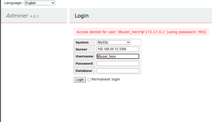

  8. Hi I get: Access denied for user 'root'@'172.18.0.1' (using password: YES). It is on its own network and I used docker create network ..., as i remember? I am using the maria DB with adminer from Linux mint on my UNRAID-system. I have no idea what to with this? Anyone? C.
  9. Thank you soo much that did the trick. So much worth it for someone new like me! many thanks you made my day.
