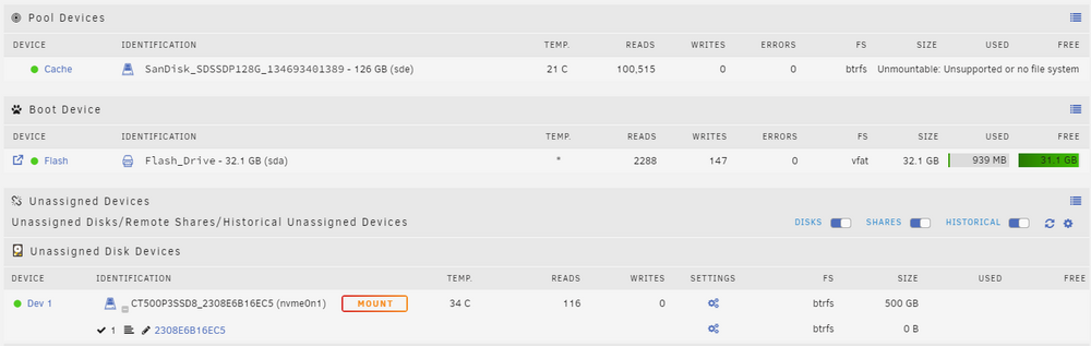

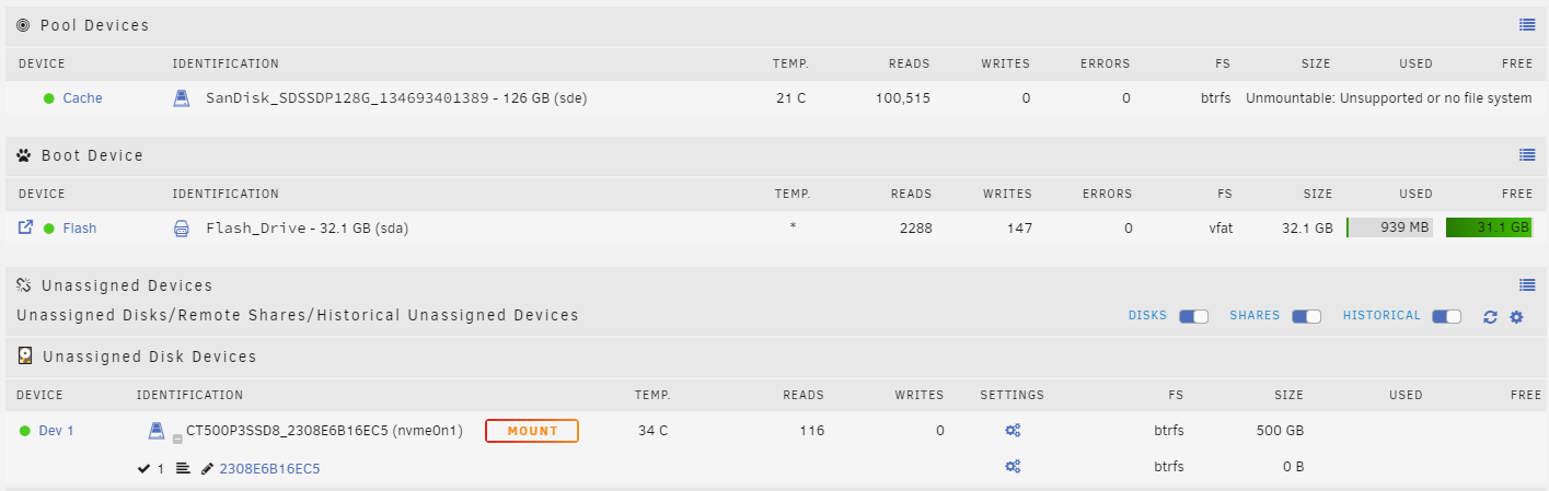

Cache drive showing as Unmountable: Unsupported or no file system
Perfect, thank you. Doing this has allowed me to add them back and then remove the one I don't want in there. Do you have a kofi or similar link you can share?
Hmm, ok. It seems that seeing as the disk I want to keep is in the 2nd slot, I can't quite do what I need to. When I try and just unassign the disk in slot 1, it says something about incorrect number. If I try and unassign the disk in slot 1 and reassign the disk in slot 2 to slot 1, I get an error about mismatch. Any thoughts?
Just to check, this seems to be for replacing a single drive with another, as opposed to removing one. Am I right in thinking it's essentially the same thing? So in essence it's a case of adding the array as secondary storage and running mover to duplicate the files, then stopping the array, unassigning the disk I no longer want and then changing the mover direction back from array to cache before then removing secondary storage again? Seeing as I've now rebalanced to be on Raid1, am I not able to just unassign? I thought Raid1 was mirrored. Thanks again.
Thank you very much, really appreciate your help. Do you have a kofi link or similar?
Ok, have done, thank you. Diagnostics attached. I guess at this point it's probably worth asking how I might go about removing the smaller of the 2 disks from the cache pool, and whether I need to do something with the balancer. I'm guessing that there is a wiki page for the former. rincewind-diagnostics-20250102-1125.zip
If I'm losing data, I may just add the nvme drive back to the cache and not worry about the smaller one, however if I need both to preserve data, if only at least initially, then I'm happy to do that.
(array is currently running too)
