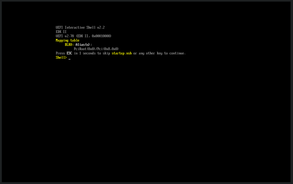

Press ESC in 1 seconds to skip startup.nsh or any other key to continue. when Windows VM starts
I have a pretty consistent problem where any VM I make after a few reboots stops working properly. More precisely they boot into UEFI and display the error: UEFI Interactive Shell v2.2 EDK 11 UEFI v2.70 (EDK II, 0x00010000) Mapping table BLK0: Alias(s): PCiRoot(0x0)/Pci(0x8,0x0) Press ESC in 1 seconds to skip startup.nsh or any other key to continue. Shell> In this case all I did was: 1. Make a VM and use a pre-existing image file 2. Start the VM 3. Rename the computer from inside Windows 4. Reboot 5. Add a VM share using the VM wizard in Unraid 6. Start the VM 7. I get this message: -device '{"driver":"virtio-net","netdev":"hostnet0","id":"net0","mac":"52:54:00:48:10:07","bus":"pci.0","addr":"0x5"}' \ -chardev pty,id=charserial0 \ -device '{"driver":"isa-serial","chardev":"charserial0","id":"serial0","index":0}' \ -chardev socket,id=charchannel0,fd=34,server=on,wait=off \ -device '{"driver":"virtserialport","bus":"virtio-serial0.0","nr":1,"chardev":"charchannel0","id":"channel0","name":"org.qemu.guest_agent.0"}' \ -device '{"driver":"usb-tablet","id":"input0","bus":"usb.0","port":"1"}' \ -audiodev '{"id":"audio1","driver":"none"}' \ -vnc 0.0.0.0:0,websocket=5700,audiodev=audio1 \ -k no \ -device '{"driver":"qxl-vga","id":"video0","max_outputs":1,"ram_size":67108864,"vram_size":67108864,"vram64_size_mb":0,"vgamem_mb":16,"bus":"pci.0","addr":"0x2"}' \ -device '{"driver":"virtio-balloon-pci","id":"balloon0","bus":"pci.0","addr":"0x6"}' \ -sandbox on,obsolete=deny,elevateprivileges=deny,spawn=deny,resourcecontrol=deny \ -msg timestamp=on char device redirected to /dev/pts/2 (label charserial0) qxl_send_events: spice-server bug: guest stopped, ignoring 2024-08-14T15:02:27.784739Z qemu-system-x86_64: terminating on signal 15 from pid 15275 (/usr/sbin/libvirtd) 2024-08-14 15:02:27.984+0000: shutting down, reason=destroyed 2024-08-14 18:56:08.787+0000: Starting external device: virtiofsd /usr/libexec/virtiofsd --fd=36 -o source=/mnt/user/DL-MACHINE,cache=always,sandbox=chroot,xattr 2024-08-14 18:56:08.878+0000: starting up libvirt version: 8.7.0, qemu version: 7.2.0, kernel: 6.1.79-Unraid, hostname: nova LC_ALL=C \ PATH=/bin:/sbin:/usr/bin:/usr/sbin \ HOME=/var/lib/libvirt/qemu/domain-15-DL-MACHINE \ XDG_DATA_HOME=/var/lib/libvirt/qemu/domain-15-DL-MACHINE/.local/share \ XDG_CACHE_HOME=/var/lib/libvirt/qemu/domain-15-DL-MACHINE/.cache \ XDG_CONFIG_HOME=/var/lib/libvirt/qemu/domain-15-DL-MACHINE/.config \ /usr/local/sbin/qemu \ -name guest=DL-MACHINE,debug-threads=on \ -S \ -object '{"qom-type":"secret","id":"masterKey0","format":"raw","file":"/var/lib/libvirt/qemu/domain-15-DL-MACHINE/master-key.aes"}' \ -blockdev '{"driver":"file","filename":"/usr/share/qemu/ovmf-x64/OVMF_CODE-pure-efi.fd","node-name":"libvirt-pflash0-storage","auto-read-only":true,"discard":"unmap"}' \ -blockdev '{"node-name":"libvirt-pflash0-format","read-only":true,"driver":"raw","file":"libvirt-pflash0-storage"}' \ -blockdev '{"driver":"file","filename":"/etc/libvirt/qemu/nvram/61f77654-9c6a-49aa-3422-cadd9947bc96_VARS-pure-efi.fd","node-name":"libvirt-pflash1-storage","auto-read-only":true,"discard":"unmap"}' \ -blockdev '{"node-name":"libvirt-pflash1-format","read-only":false,"driver":"raw","file":"libvirt-pflash1-storage"}' \ -machine pc-i440fx-7.2,usb=off,dump-guest-core=off,mem-merge=off,memory-backend=pc.ram,pflash0=libvirt-pflash0-format,pflash1=libvirt-pflash1-format \ -accel kvm \ -cpu host,migratable=on,hv-time=on,hv-relaxed=on,hv-vapic=on,hv-spinlocks=0x1fff,hv-vendor-id=none,host-cache-info=on,l3-cache=off \ -m 16384 \ -object '{"qom-type":"memory-backend-memfd","id":"pc.ram","share":true,"x-use-canonical-path-for-ramblock-id":false,"size":17179869184}' \ -overcommit mem-lock=off \ -smp 12,sockets=1,dies=1,cores=6,threads=2 \ -uuid 61f77654-9c6a-49aa-3422-cadd9947bc96 \ -no-user-config \ -nodefaults \ -chardev socket,id=charmonitor,fd=35,server=on,wait=off \ -mon chardev=charmonitor,id=monitor,mode=control \ -rtc base=localtime \ -no-hpet \ -no-shutdown \ -boot strict=on \ -device '{"driver":"qemu-xhci","p2":15,"p3":15,"id":"usb","bus":"pci.0","addr":"0x7"}' \ -device '{"driver":"virtio-serial-pci","id":"virtio-serial0","bus":"pci.0","addr":"0x4"}' \ -blockdev '{"driver":"file","filename":"/mnt/user/vm/vms/DL-MACHINE/vdisk1.img","node-name":"libvirt-2-storage","cache":{"direct":false,"no-flush":false},"auto-read-only":true,"discard":"unmap"}' \ -blockdev '{"node-name":"libvirt-2-format","read-only":false,"cache":{"direct":false,"no-flush":false},"driver":"raw","file":"libvirt-2-storage"}' \ -device '{"driver":"virtio-blk-pci","bus":"pci.0","addr":"0x8","drive":"libvirt-2-format","id":"virtio-disk2","bootindex":1,"write-cache":"on","serial":"vdisk1"}' \ -blockdev '{"driver":"file","filename":"/mnt/user/vm/iso/virtio-win-0.1.248-1.iso","node-name":"libvirt-1-storage","auto-read-only":true,"discard":"unmap"}' \ -blockdev '{"node-name":"libvirt-1-format","read-only":true,"driver":"raw","file":"libvirt-1-storage"}' \ -device '{"driver":"ide-cd","bus":"ide.0","unit":1,"drive":"libvirt-1-format","id":"ide0-0-1"}' \ -chardev socket,id=chr-vu-fs0,path=/var/lib/libvirt/qemu/domain-15-DL-MACHINE/fs0-fs.sock \ -device '{"driver":"vhost-user-fs-pci","id":"fs0","chardev":"chr-vu-fs0","queue-size":1024,"tag":"DL-MACHINE","bus":"pci.0","addr":"0x3"}' \ -netdev tap,fd=36,id=hostnet0 \ -device '{"driver":"virtio-net","netdev":"hostnet0","id":"net0","mac":"52:54:00:48:10:07","bus":"pci.0","addr":"0x5"}' \ -chardev pty,id=charserial0 \ -device '{"driver":"isa-serial","chardev":"charserial0","id":"serial0","index":0}' \ -chardev socket,id=charchannel0,fd=34,server=on,wait=off \ -device '{"driver":"virtserialport","bus":"virtio-serial0.0","nr":1,"chardev":"charchannel0","id":"channel0","name":"org.qemu.guest_agent.0"}' \ -device '{"driver":"usb-tablet","id":"input0","bus":"usb.0","port":"1"}' \ -audiodev '{"id":"audio1","driver":"none"}' \ -vnc 0.0.0.0:0,websocket=5700,audiodev=audio1 \ -k no \ -device '{"driver":"qxl-vga","id":"video0","max_outputs":1,"ram_size":67108864,"vram_size":67108864,"vram64_size_mb":0,"vgamem_mb":16,"bus":"pci.0","addr":"0x2"}' \ -device '{"driver":"virtio-balloon-pci","id":"balloon0","bus":"pci.0","addr":"0x6"}' \ -sandbox on,obsolete=deny,elevateprivileges=deny,spawn=deny,resourcecontrol=deny \ -msg timestamp=on char device redirected to /dev/pts/0 (label charserial0) qxl_send_events: spice-server bug: guest stopped, ignoring 2024-08-14T18:56:15.620295Z qemu-system-x86_64: warning: no scancode found for keysym 65297 2024-08-14T18:56:15.621805Z qemu-system-x86_64: warning: no scancode found for keysym 65297 2024-08-14T18:56:15.664735Z qemu-system-x86_64: warning: no scancode found for keysym 65297 2024-08-14T18:56:15.665338Z qemu-system-x86_64: warning: no scancode found for keysym 65297 2024-08-14T18:56:15.709394Z qemu-system-x86_64: warning: no scancode found for keysym 65297 2024-08-14T18:56:15.709630Z qemu-system-x86_64: warning: no scancode found for keysym 65297 2024-08-14T18:56:15.767766Z qemu-system-x86_64: warning: no scancode found for keysym 65297 2024-08-14T18:56:15.768046Z qemu-system-x86_64: warning: no scancode found for keysym 65297 2024-08-14T18:56:15.784530Z qemu-system-x86_64: warning: no scancode found for keysym 65297 2024-08-14T18:56:15.785636Z qemu-system-x86_64: warning: no scancode found for keysym 65297 2024-08-14T18:56:15.843981Z qemu-system-x86_64: warning: no scancode found for keysym 65297 2024-08-14T18:56:15.844207Z qemu-system-x86_64: warning: no scancode found for keysym 65297 2024-08-14T18:56:15.934611Z qemu-system-x86_64: warning: no scancode found for keysym 65297 2024-08-14T18:56:15.935131Z qemu-system-x86_64: warning: no scancode found for keysym 65297 XML: <?xml version='1.0' encoding='UTF-8'?> <domain type='kvm' id='15'> <name>DL-MACHINE</name> <uuid>61f77654-9c6a-49aa-3422-cadd9947bc96</uuid> <metadata> <vmtemplate xmlns="unraid" name="Windows 10" icon="windows.png" os="windows10"/> </metadata> <memory unit='KiB'>16777216</memory> <currentMemory unit='KiB'>16777216</currentMemory> <memoryBacking> <nosharepages/> <source type='memfd'/> <access mode='shared'/> </memoryBacking> <vcpu placement='static'>12</vcpu> <cputune> <vcpupin vcpu='0' cpuset='0'/> <vcpupin vcpu='1' cpuset='1'/> <vcpupin vcpu='2' cpuset='2'/> <vcpupin vcpu='3' cpuset='3'/> <vcpupin vcpu='4' cpuset='4'/> <vcpupin vcpu='5' cpuset='5'/> <vcpupin vcpu='6' cpuset='6'/> <vcpupin vcpu='7' cpuset='7'/> <vcpupin vcpu='8' cpuset='8'/> <vcpupin vcpu='9' cpuset='9'/> <vcpupin vcpu='10' cpuset='10'/> <vcpupin vcpu='11' cpuset='11'/> </cputune> <resource> <partition>/machine</partition> </resource> <os> <type arch='x86_64' machine='pc-i440fx-7.2'>hvm</type> <loader readonly='yes' type='pflash'>/usr/share/qemu/ovmf-x64/OVMF_CODE-pure-efi.fd</loader> <nvram>/etc/libvirt/qemu/nvram/61f77654-9c6a-49aa-3422-cadd9947bc96_VARS-pure-efi.fd</nvram> </os> <features> <acpi/> <apic/> <hyperv mode='custom'> <relaxed state='on'/> <vapic state='on'/> <spinlocks state='on' retries='8191'/> <vendor_id state='on' value='none'/> </hyperv> </features> <cpu mode='host-passthrough' check='none' migratable='on'> <topology sockets='1' dies='1' cores='6' threads='2'/> <cache mode='passthrough'/> </cpu> <clock offset='localtime'> <timer name='hypervclock' present='yes'/> <timer name='hpet' present='no'/> </clock> <on_poweroff>destroy</on_poweroff> <on_reboot>restart</on_reboot> <on_crash>restart</on_crash> <devices> <emulator>/usr/local/sbin/qemu</emulator> <disk type='file' device='disk'> <driver name='qemu' type='raw' cache='writeback'/> <source file='/mnt/user/vm/vms/DL-MACHINE/vdisk1.img' index='2'/> <backingStore/> <target dev='hdc' bus='virtio'/> <serial>vdisk1</serial> <boot order='1'/> <alias name='virtio-disk2'/> <address type='pci' domain='0x0000' bus='0x00' slot='0x08' function='0x0'/> </disk> <disk type='file' device='cdrom'> <driver name='qemu' type='raw'/> <source file='/mnt/user/vm/iso/virtio-win-0.1.248-1.iso' index='1'/> <backingStore/> <target dev='hdb' bus='ide'/> <readonly/> <alias name='ide0-0-1'/> <address type='drive' controller='0' bus='0' target='0' unit='1'/> </disk> <controller type='usb' index='0' model='qemu-xhci' ports='15'> <alias name='usb'/> <address type='pci' domain='0x0000' bus='0x00' slot='0x07' function='0x0'/> </controller> <controller type='virtio-serial' index='0'> <alias name='virtio-serial0'/> <address type='pci' domain='0x0000' bus='0x00' slot='0x04' function='0x0'/> </controller> <controller type='pci' index='0' model='pci-root'> <alias name='pci.0'/> </controller> <controller type='ide' index='0'> <alias name='ide'/> <address type='pci' domain='0x0000' bus='0x00' slot='0x01' function='0x1'/> </controller> <filesystem type='mount' accessmode='passthrough'> <driver type='virtiofs' queue='1024'/> <binary path='/usr/libexec/virtiofsd' xattr='on'> <cache mode='always'/> <sandbox mode='chroot'/> </binary> <source dir='/mnt/user/DL-MACHINE'/> <target dir='DL-MACHINE'/> <alias name='fs0'/> <address type='pci' domain='0x0000' bus='0x00' slot='0x03' function='0x0'/> </filesystem> <interface type='bridge'> <mac address='52:54:00:48:10:07'/> <source bridge='br0'/> <target dev='vnet12'/> <model type='virtio-net'/> <alias name='net0'/> <address type='pci' domain='0x0000' bus='0x00' slot='0x05' function='0x0'/> </interface> <serial type='pty'> <source path='/dev/pts/0'/> <target type='isa-serial' port='0'> <model name='isa-serial'/> </target> <alias name='serial0'/> </serial> <console type='pty' tty='/dev/pts/0'> <source path='/dev/pts/0'/> <target type='serial' port='0'/> <alias name='serial0'/> </console> <channel type='unix'> <source mode='bind' path='/var/lib/libvirt/qemu/channel/target/domain-15-DL-MACHINE/org.qemu.guest_agent.0'/> <target type='virtio' name='org.qemu.guest_agent.0' state='disconnected'/> <alias name='channel0'/> <address type='virtio-serial' controller='0' bus='0' port='1'/> </channel> <input type='tablet' bus='usb'> <alias name='input0'/> <address type='usb' bus='0' port='1'/> </input> <input type='mouse' bus='ps2'> <alias name='input1'/> </input> <input type='keyboard' bus='ps2'> <alias name='input2'/> </input> <graphics type='vnc' port='5900' autoport='yes' websocket='5700' listen='0.0.0.0' keymap='no'> <listen type='address' address='0.0.0.0'/> </graphics> <audio id='1' type='none'/> <video> <model type='qxl' ram='65536' vram='65536' vgamem='16384' heads='1' primary='yes'/> <alias name='video0'/> <address type='pci' domain='0x0000' bus='0x00' slot='0x02' function='0x0'/> </video> <memballoon model='virtio'> <alias name='balloon0'/> <address type='pci' domain='0x0000' bus='0x00' slot='0x06' function='0x0'/> </memballoon> </devices> <seclabel type='dynamic' model='dac' relabel='yes'> <label>+0:+100</label> <imagelabel>+0:+100</imagelabel> </seclabel> </domain> Please help me out. I have two VMs doing this now and I have no idea why. Boot manager shows this but I can't boot from any of them.
