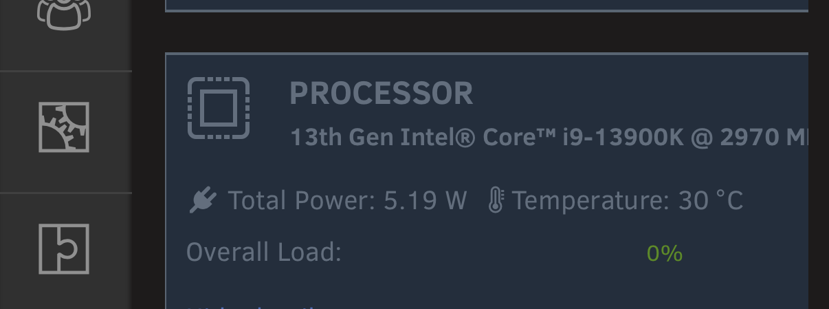

For info. That firmware update I just did, dropped CPU temps from 60-70 down to 35-40. vCore from 1.4 to 1, power draw I screenshot because otherwise you wouldn’t believe me!!!!!!!! needless to say I’m going to try and do a warranty claim!

Hadn't even considered that, before having this server as headless I was keeping it updated, current version is BIOS dated: Thu 26 Sep 2024 12:00 AM but there is an update available. IK'm going to have to gran Keyboard Mouse and monitor and update as there is a new version available. Can you confirm then you can't see any software cause for the issue?
