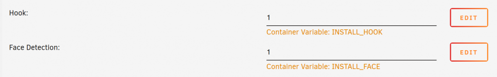

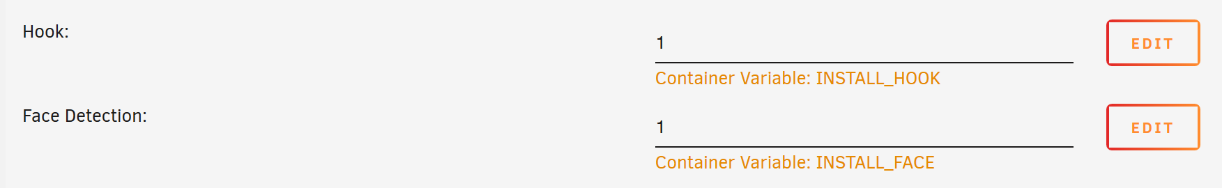

Hi I have been running ZM for ages and decided to try get the hooks going so I can have object notifications and not a whole lot from lighting changes. The steps I have followed are: I have the notifications running fine. I edited the zmeventnotification.ini to uncomment hook_script = '/usr/bin/detect_wrapper.sh' I have then added the hooks and face detection variables as per attached image. I then downloaded the hook folder from "https://github.com/pliablepixels/zmeventnotification" I put this in my /appdata/Zoneminder/hook folder I edited the general section of objectconfig.ini with my server IP and user name and password Then rebooted ZM docker hoping it would all fire into life. So far nothing. Notifications come in but no object identifications Im guessing there is something simple I have missed? **Update, I am seeing the error below coming up in the logs Traceback (most recent call last): File "/usr/bin/detect.py", line 8, in <module> import cv2 ImportError: No module named 'cv2' Tried re running the command - sudo pip install -r /config/hook/requirements.txt but still no luck
