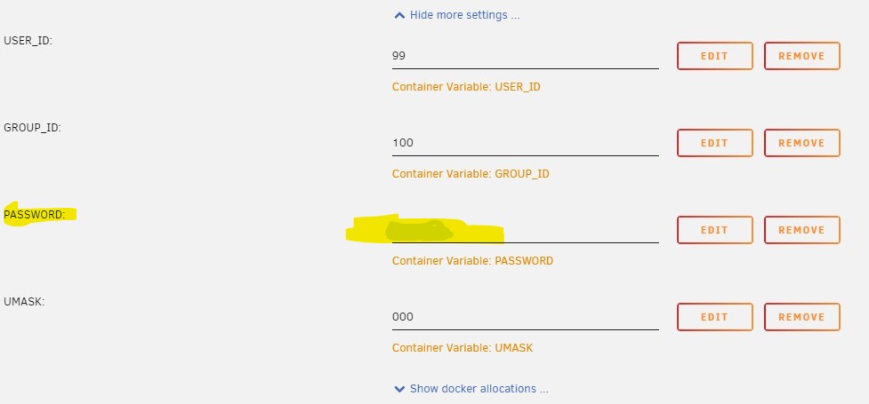

  10. It is in the "show more settings" section of the docker setup.

  14. In the Docker settings for TMM, what are your USER_ID and GROUP_ID settings? I think for user "nobody" and group "users" they should be set to USER_ID 99 and GROUP_ID 100.
