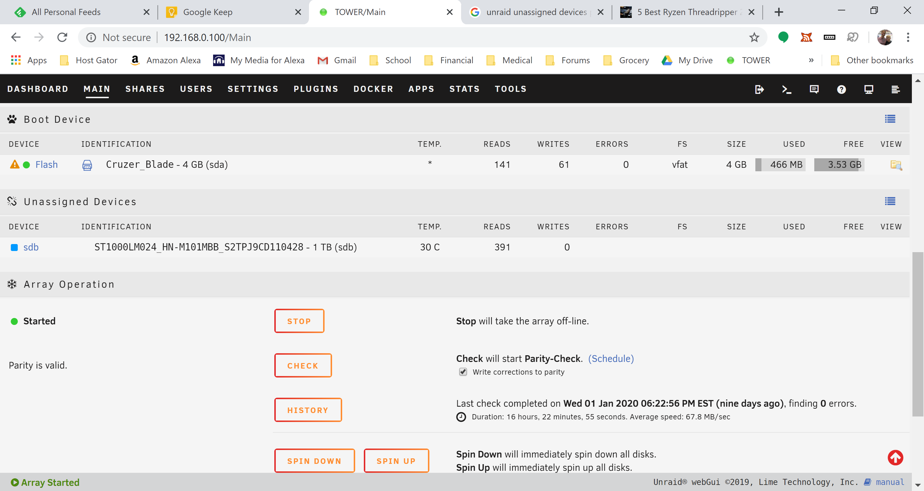

I just installed UD plus in Unraid 6.8.0 and I am a little confused. I my WebUI it looks different than before. I don't see the mount buttons and it just all looks different. I'm trying to get things setup so in Krusader I can copy files from a USB drive to the RAID, but I can't even seem to find where the disk is mounted as I no longer have a /mnt/disks location. I've probably skipped or looked over something. Any pointers?
Blank Web UI
I did read the notes, but maybe I was in one rum too many. I guess I shouldn't drink and post đ„șI think Squid hit the issue. I am digging into it properly now. Edit: And that was indeed the issue. Sorry!
