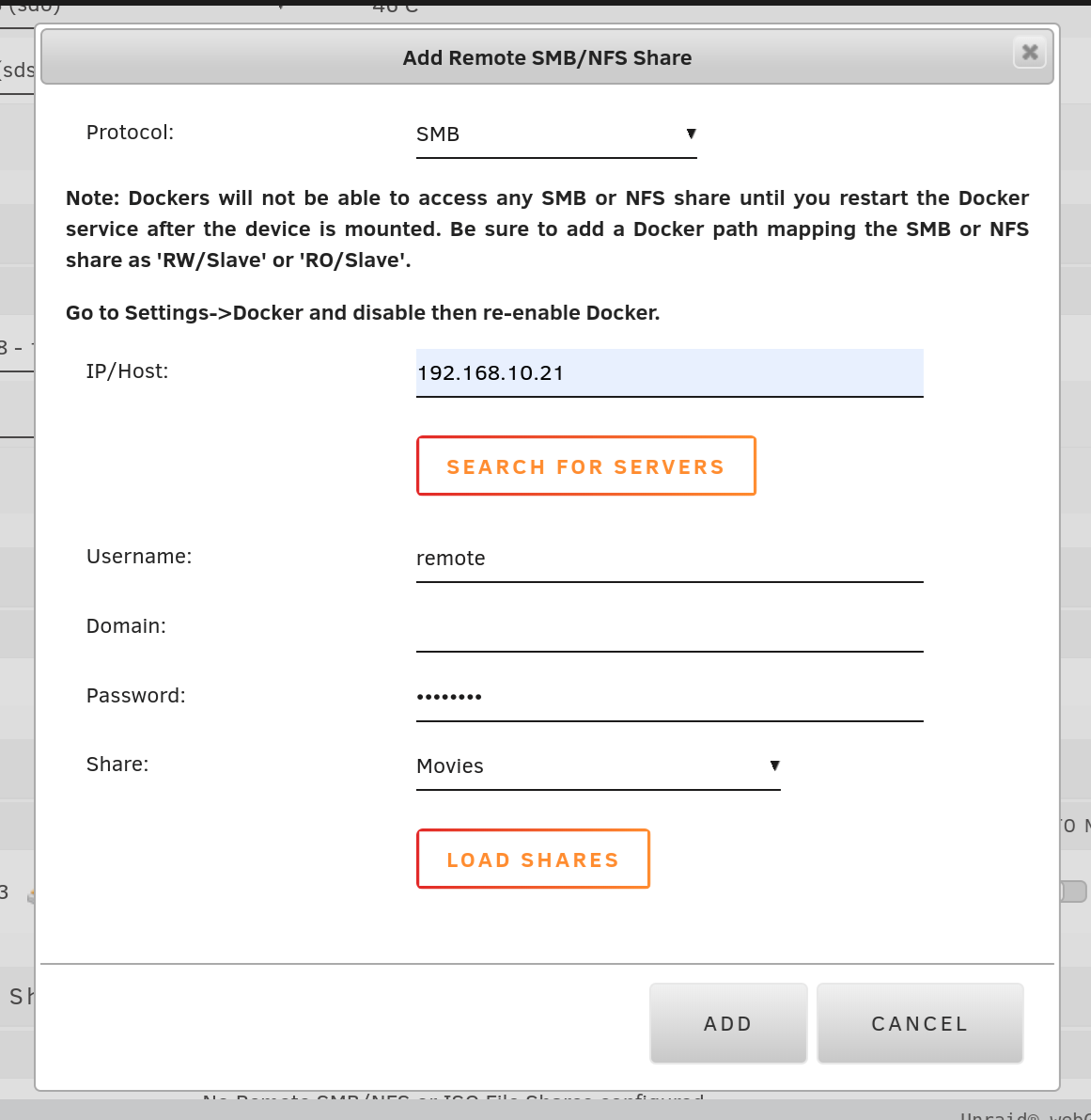

Well my "Media - TV Shows" was the share I wanted to bring in and that wasn't working, but I tried my "Audio" share and that worked fine. The "Audio" share and the "Media - TV Shows" share had different SMB Security Settings so I made the "Media - TV Shows" settings match the "Audio" share settings but it still wouldn't connect, so I ended up changing the share name from "Media - TV Shows" to "TV" and now it connects just fine - so I think that it was the dash in the share name that might have been giving me the problems. This second server was a mishmash of old drives that are really not in great condition but it's got a dual parity and for what it's being used for it's really not a big deal if I lose anything. I'm still going to remove drive 6 though because it's really at the very end of its life. Thanks Squid and dlandon for looking into my diagnostics and giving me some suggestions.
Here is the zip file. I really appreciate you two taking the time to respond and check it out vault-diagnostics-20191012-1652.zip
Where can I find those? The "Remote SMB/NFS Script Log" is empty and I'm not seeing anything in the main log about the SMB stuff. Is there somewhere else to look?\
I have a second Unraid server that I'm trying to let my first Unraid server access using a SMB share through unassigned devices but I can't get the share to mount. I searched through this forum but if this has been addressed already I didn't see it. Please let me know if you need more info, I'm attaching a screen shot of the settings I'm trying to use. If there's another way to let my docker images on my first server see shares on my second server that makes more sense then please let me know about that too.
