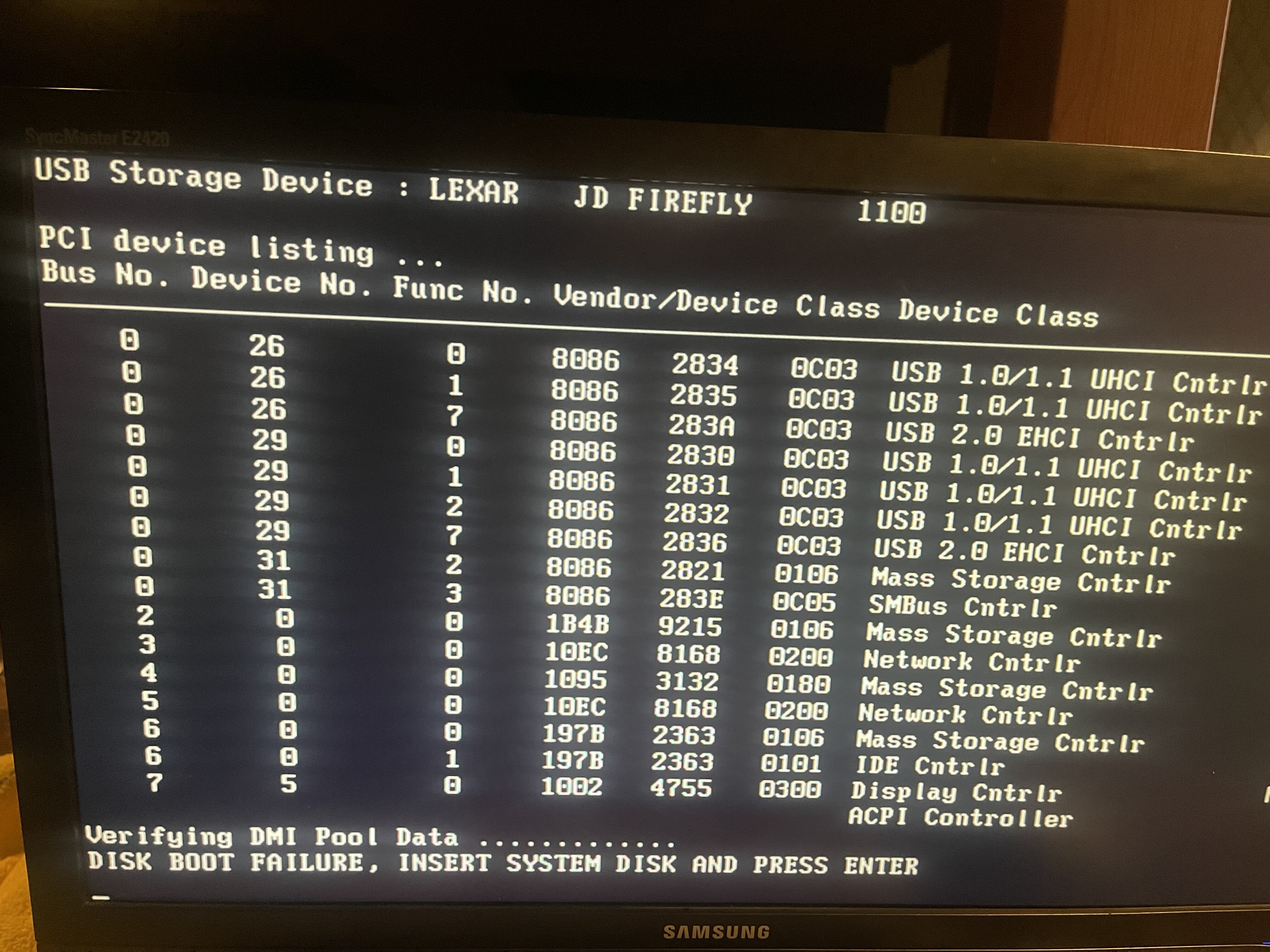

  6. I'm seeking direction on my next move to restore my old server. I was able to upgrade to the very latest release 6.12. Before doing this I was getting frequent lockup and automatic reboots. Server would run for a few minutes - Hours. Following the upgrade, I got immediate lockups when i started the server, then the current state where I now get a Disk Boot Failure before i get to the UnRaid Boot menu. Could this be a MB or other Hardware issue? I'm open to just building a new server and need to retain my array. Thought? Thanks in advance!
  7. Yes it did. Trying to figure out if its the flash or PC hardware. This box has been together for about 15 years and may need a refresh. I just dont want to lose any data.

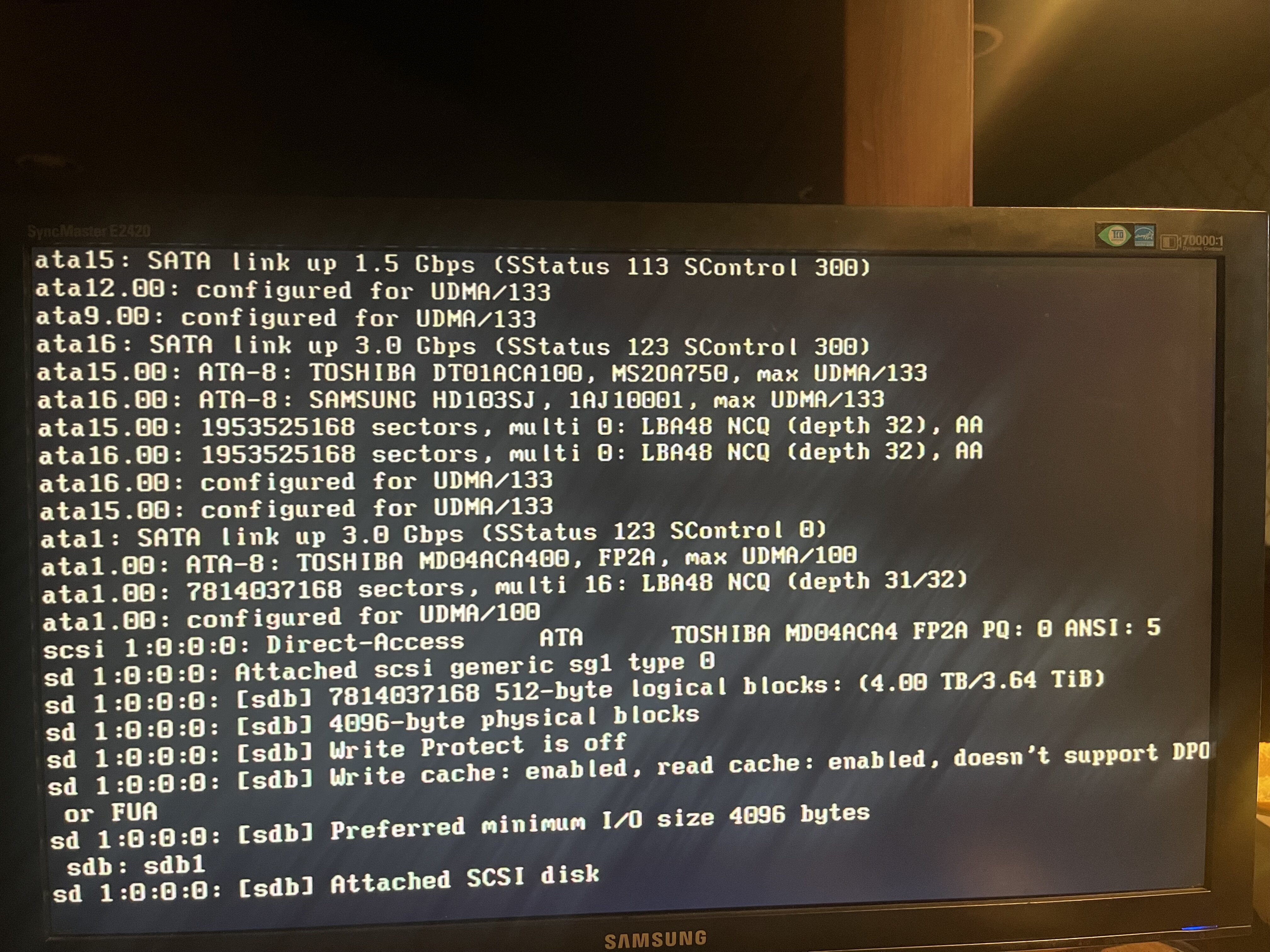

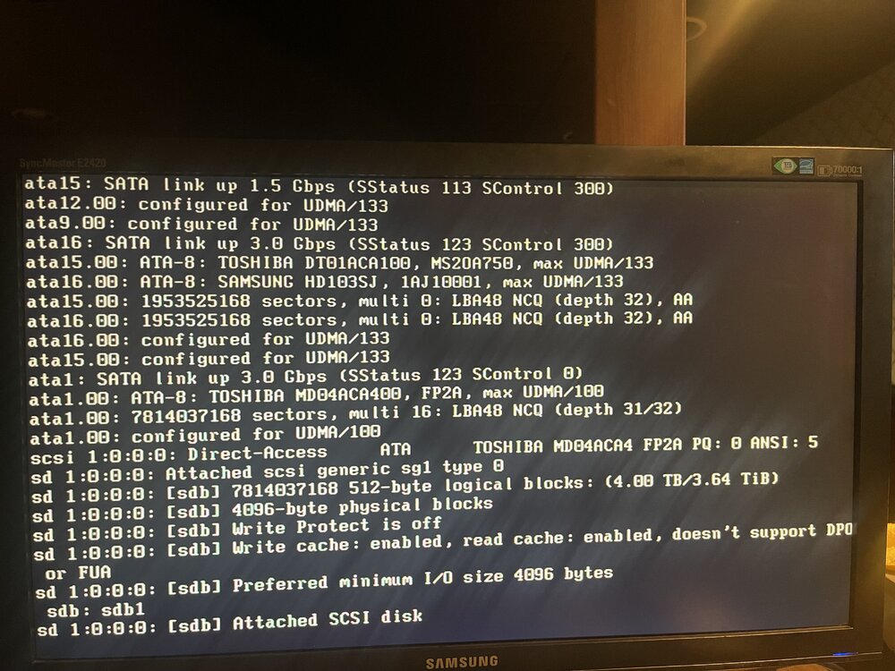

  11. I moved and copied BZ* files as instructed. Upon reboot I only got as far as the attached image. Any advice is welcome.
  12. I have those files already. I thought I had to do incremental upgrades before going to the current release. Please confirm.
