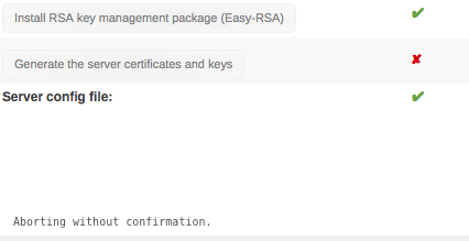

  14. Hi Peter, I saved the server config file and have a green arrow next to that. As soon as I press the generate certificates and keys button the text Aborting without confirmation appears on the bottom.
  15. I'm probably missing something basic here but I've tried a couple times and cannot get it to work. Can anyone tell me what I'm doing wrong? Running Unraid v 6.1.7 1. Installed the Server plugin 2. Defined the path to store config files 3. Installed Easy-RSA 4. Click on the Generate keys and certificates -- after this point the Dynamix GUI hangs for a few seconds, reloads and the red X remains. Log shows nothing happens after this point. Jan 18 19:17:51 Aegir emhttp: cmd: /usr/local/emhttp/plugins/dynamix.plugin.manager/scripts/plugin install https://raw.githubusercontent.com/petersm1/openvpnserver/master/openvpn_server_x64.plg Jan 18 19:17:52 Aegir logger: plugin: skipping: /boot/packages/tcl-8.6.2-x86_64-2.txz already exists Jan 18 19:17:52 Aegir logger: plugin: running: /boot/packages/tcl-8.6.2-x86_64-2.txz Jan 18 19:17:52 Aegir logger: plugin: skipping: /boot/packages/expect-5.44.1.15-x86_64-2.txz already exists Jan 18 19:17:52 Aegir logger: plugin: running: /boot/packages/expect-5.44.1.15-x86_64-2.txz Jan 18 19:17:52 Aegir logger: plugin: creating: /boot/packages/openvpn-2.3.9-x86_64-1.txz - downloading from URL http://mirrors.slackware.com/slackware/slackware64-current/slackware64/n/openvpn-2.3.9-x86_64-1.txz Jan 18 19:17:53 Aegir logger: plugin: checking: /boot/packages/openvpn-2.3.9-x86_64-1.txz - MD5 Jan 18 19:17:53 Aegir logger: plugin: running: /boot/packages/openvpn-2.3.9-x86_64-1.txz Jan 18 19:17:53 Aegir logger: plugin: creating: /boot/config/plugins/openvpnserver/openvpnserver-2015.12.23.tar.gz - downloading from URL https://github.com/petersm1/openvpnserver/archive/2015.12.23.tar.gz Jan 18 19:17:55 Aegir logger: plugin: running: anonymous Jan 18 19:17:55 Aegir logger: plugin: creating: /var/local/emhttp/plugins/openvpnserver/check-my-ip.sh - from INLINE content Jan 18 19:17:55 Aegir logger: plugin: setting: /var/local/emhttp/plugins/openvpnserver/check-my-ip.sh - mode to 0770 Jan 18 19:17:55 Aegir logger: plugin: creating: /var/log/plugins/openvpnserver - from INLINE content Jan 18 19:18:39 Aegir rc.openvpnserver[21632]: Plugin configuration for certs written Jan 18 19:18:44 Aegir php: /usr/local/emhttp/plugins/openvpnserver/scripts/rc.openvpnserver 'download_easy-rsa' Jan 18 19:18:50 Aegir php: /usr/local/emhttp/plugins/openvpnserver/scripts/rc.openvpnserver 'create_server_cert' Thanks in advance!
