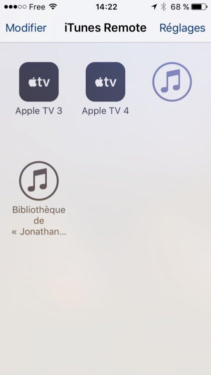

Thanks for this. Is anybody able to explain the process of getting remote to work? The FAQ: http://ejurgensen.github.io/forked-daapd/#using-remote i have tried, but i believe i need to use the part about "libraries on a network mount": http://ejurgensen.github.io/forked-daapd/#libraries-on-network-mounts but that makes no sense to me.
thanks
thanks
That's the same link i posted :)
I did get a little further though...
1) Launch remote app on iDevice
2) Settings -> Add an iTunes Library
3) Make sure this is left open at all times
4) Browse to your docker log location, in my example /mnt/cache/dockerapps/daapd/dbase_and_logs/forked-daapd.log
5) Launch Docker
6) Check log for:
remote: Discovered remote 'iPad' (id F2BB4AC0....) at 192.168.0.251:57629......
7) Create a plain text file with 2 lines. First line being the name that's been discovered. In my case iPad (no quote marks). Second line is the code that is displayed on the iDevice.
8 ) Name the file as iPad.remote (what you call it doesn't matter, but the extension has to be .remote)
9) Save that file to the folder that holds all your music. In my case /mnt/user/music
10) Restart Docker
11) ..... and this is where i'm now stuck. i get error:
remote: Read Remote pairing data (name 'iPad', pin '9709') from /music/ipad.remote
[2015-12-12 11:19:16] [  LOG]   remote: Remote 'iPad' not known from mDNS, ignoring
Then I found this post: https://github.com/jasonmc/forked-daapd/issues/41
Here is how I have been successful.
1. Try pairing with a very small library or wait until the daemon scans everything. I have 40,000+ songs and that initial scan takes a while.
2. Start the daemon with no .remote and let it finish scanning.
3. Start the iPhone remote app, choose add library and then get the code. If you are running avahi-browse you should see it show up.
4. Prepare a .remote file in your home directory and move it into the library... I think that the temp file when editing directly in the library may confuse things...
Should go ahead and pair.  I have been successful consistently like this.
Then delete the .remote file in the library...
So i got it working by pointing my /music mapping to a folder that was empty -> copied .remote file into there and it picked it up straight away

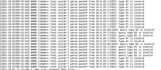

Hi i just tried to switch from Sparklyballs daapd to the ls.io dappd but i wont come up sayin it could not bind to Port 3689.
These are the Log File entries which keep repeating. Any Idea?
[2016-01-03 19:26:55] [  LOG]     main: Forked Media Server Version 23.3 taking off
[2016-01-03 19:26:55] [  LOG]     main: mDNS init
[2016-01-03 19:26:55] [  LOG]     mdns: Avahi state change: Client running
[2016-01-03 19:26:55] [  LOG]       db: Now vacuuming database, this may take some time...
[2016-01-03 19:26:56] [  LOG]       db: Database OK with 403 active files and 6 active playlists
[2016-01-03 19:26:57] [  LOG]     raop: Couldn't make timing socket: Address family not supported by protocol
[2016-01-03 19:26:57] [  LOG]     raop: Couldn't make control socket: Address family not supported by protocol
[2016-01-03 19:26:57] [FATAL]    httpd: Could not bind :::3689
[2016-01-03 19:26:57] [FATAL]     main: HTTPd thread failed to start
[2016-01-03 19:26:57] [  LOG]     main: Player deinit
[2016-01-03 19:26:57] [  LOG]     scan: Scanned 200 files...
[2016-01-03 19:26:58] [  LOG]     main: Spotify deinit
[2016-01-03 19:26:58] [  LOG]     main: File scanner deinit
[2016-01-03 19:26:58] [  LOG]     main: Cache deinit
[2016-01-03 19:26:58] [  LOG]     main: Worker deinit
[2016-01-03 19:26:58] [  LOG]     main: Database deinit
[2016-01-03 19:26:58] [  LOG]     main: mDNS deinit
[2016-01-03 19:26:58] [  LOG]     main: Exiting.
Okay solved it by myself.
On unRaid you have to set ipv6=no in the forked-daapd.conf because unRaid does not support ipv6.
Maybe it would be a good idea to take that setting as default, because it is easier for most to enable it than to have a not working forked-daapd and have to search for that failure.
only sometime between 18 days ago and today is that the case, they changed something in that period.
had it running myself on unraid with the settings out the box so to speak when i made the last update to the image 18 days ago.
testing changing it by default to no.
they've definitely changed something.
disabling it and running on my test system which has ipv6 support, it still registers an ipv6 address.

Hi, I have read this thread but I still cannot get paired properly.
I created a 2  line text file called iPad.Remote. The first line is the name of the iPad, and the second line is the 4 digit pin given by the app.
My music directory is currently empty.
I followed this procedure:
