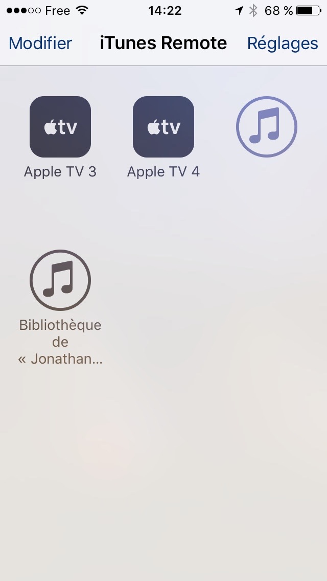

Sorry for my bad english, I'm french.
I install daapd, I see shared library on mac iTunes but, when I pair daapd with iPhone remote, I got library on iPhone without name (just iTunes logo) and I can't select it.
Can you help me ?
Thank you
Joanthan
If you're not using Unraid, then we don't support it here.  If you are can you post how you're running this container?
I use unraid 6.3.5.
I installed daapd with community applications.
I created file.remote (with advice name and 4 digit pin) and copied it to music folder.
log says :
[ LOG] remote: Read Remote pairing data (name 'ttt', pin '8817') from /music/tiphone.remote
[ LOG] remote: Pairing succeeded with Remote 'ttt' (id EAD31632-BA3C-4D2A-AC23-0559AD9B26C3), GUID: 2304A2D27F40B5B4
(ttt is iPhone name, only for test)
iPhone remote add only a logo without name and i can't select it (at the top right)

That's strange. I can actually load that link and I get a user/password login window, so something is loaded there. Strange that it's there if it's deprecated :(. And sad, because not everybody likes the console :(.
1 hour ago, almarma said:
Actually, to setup the Remote app, the web interface is required, so this container is pretty useless right now
Have you tried the regular pairing method? It should still work fine.
It now needs the code to go first, otherwise still works, synced a new remote last weekend.
Please, where is that "Regular method" and please, tell me where is it explained? I've been looking for that simple information for several days now and I'm missing that simple step.
