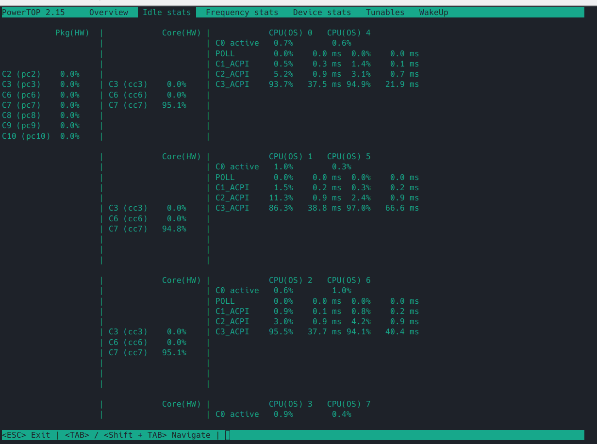

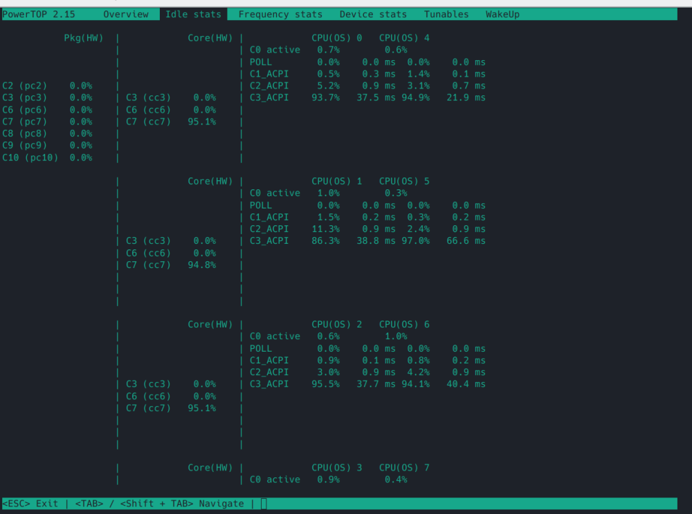

  18. Yes i did and according to the drop of used power after setting all this it is working, only Powertop does not show anything. I mean obviously that is only a cosmetic issue for me, because i can see the positive results that my unRaid now needs less energy ideling
  19. Hmm Powertop 2.15 shows nothing unter Pkg(HW). Is the Core i3-10100 to new for that? I mean that CPU is a couple of years old.
