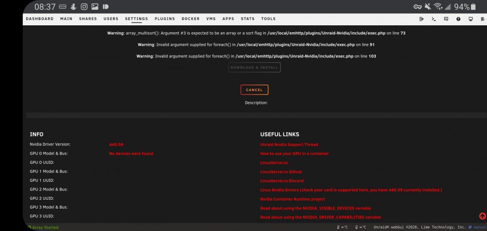

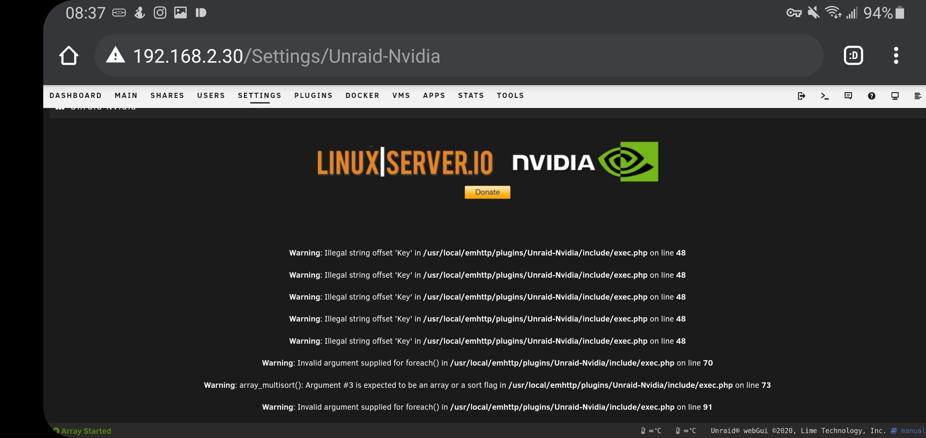

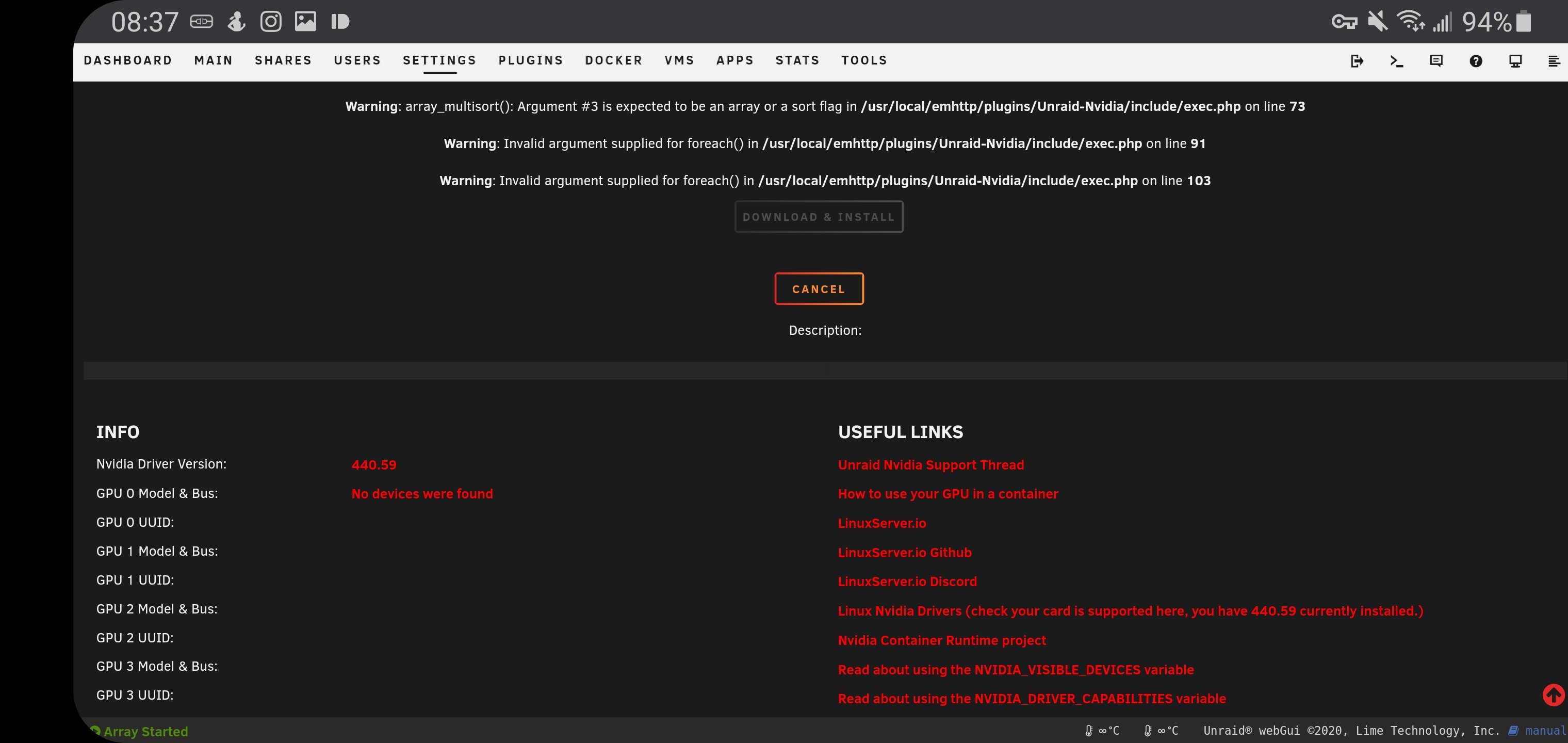

  15. I have subsequently upgraded my unraid to 6.9.0rc1 and grabbed the new proper Nvidia plugin and did all that and my issue remains the same. No devices found on Nvidia plugin page but lspci command lists my card. At a loss as to what I should do or try next

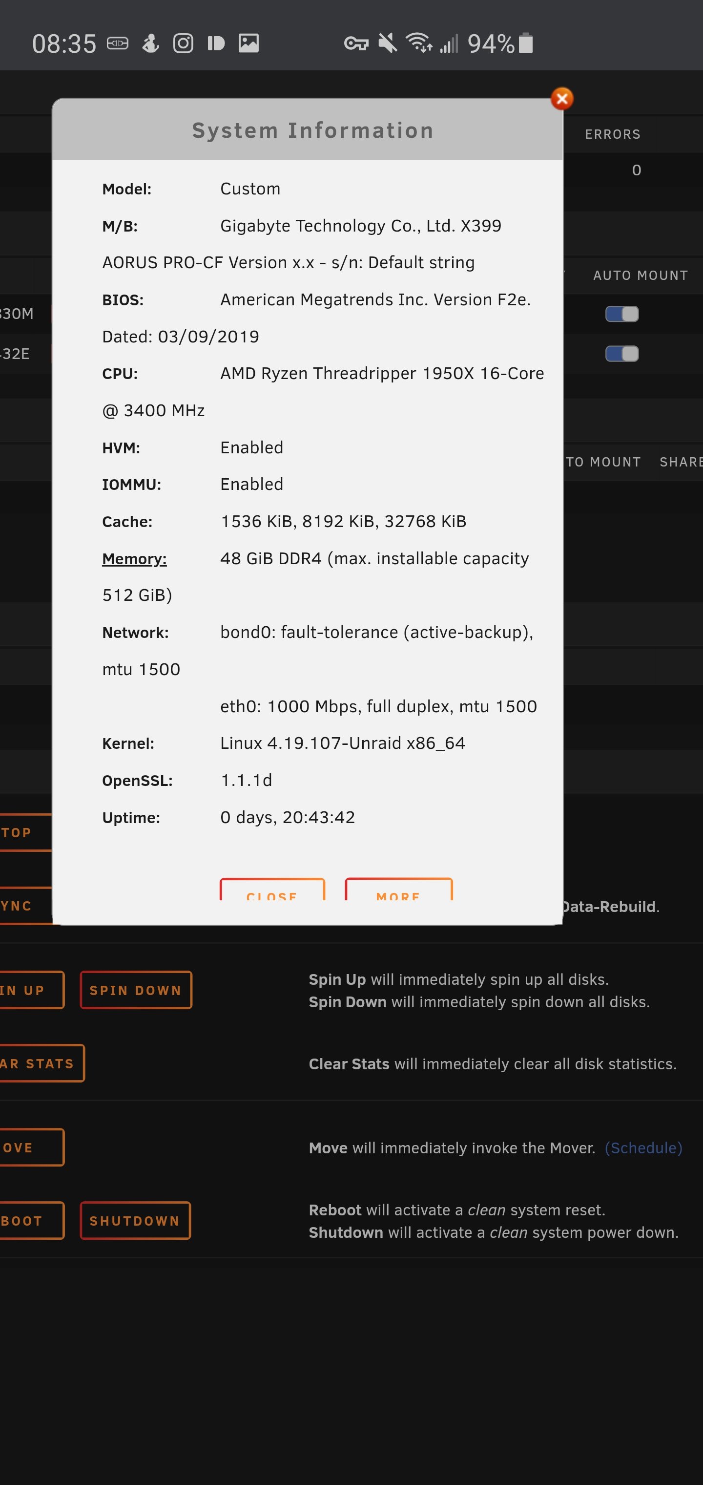

  17. Sorry guys if this is the wrong area but unsure of exactly where to plant this. I am and have been using unraid 6.8.3, I have a Nvidia 1070 on this system I use for transcoding. I recently needed to do some reboots etc to add some new drives and seemingly during these reboots I've lost access to my Nvidia gpu. Checking the Nvidia plugin shows no devices found. If I run lspci in terminal I see my 1070 listed. The gpu is on in my system, lights on, fans spinning. No vms running so I'm unsure of the path I should take to try and figure this out. I never changed anything with this and has been working no problem until I've done my new drives. Also all the sudden my plex is randomly crashing and I see nothing in docker logs at all and docker never stops but I have to costantly be rebooting the plex docker to get it back online if anyone has any ideas there? Plex version - Version 1.21.1.3795 Thanks for your time godzilla-diagnostics-20201215-1459.zip
