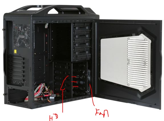

sda is now at 40c on the zeroing disk process, 25% it IS a bit warm - right now, the room is 80F or 26.6C. Is there a way for me to get case temp from unraid or this linux distro? Cpu is at: +56.0 C, +55.0 C, +54.0 C, +52.0 C. perhaps first I can try throw two fans on the side? Or maybe just get a 5in3 and put 1 or two HDs in there?
Preclear.sh results - Questions about your results? Post them here.
i've been thinking of a 5in3 for when I "release" the 1TB drives. After your first reply, i moved them so that they are in front- and on the pre-read cycles, i'm getting 39, 38, and 36 (top to bottom). Going to go dig for a decent 5in3. my machine sits in Living Room so need something not so funky on the look.
it's the Cooler master Storm scout: http://www.newegg.com/Product/Product.aspx?Item=N82E16811119196 I know it's not ideal, but didn't think drives would get this HOT. Pic below is from NE's stock photo. Sorry it's a bad scribble using win7 snipping tool. I can't get good photo of the actual unit w.o. moving it a good amount. wit the HD light solid, prolly shouldn't. Thanks for lookin @ it.
Okay so stackin' em didn't help much. more airflow, but temps are still same (perhaps a bit higher when it goes over to the write stage). SOO... the drive that is getting the highest (over 40C).. should I make that my parity drive, or keep it as a data drive? I saw a posting on here, about two types of drives - ones that have failed already, and ones that will fail. And high temps lead to failure... so is it better for a parity drive to fail or a data drive? right now it's on stock case fan. I can add two more to the side as exhaust and perhaps swap out the front one with a noctua or something. OH BTW, the reallocated sectors are at 0 so far. thanks for everyone's help still learning the ropes around here.
thanks - going to fire off another 2 rounds. the 40c has me concerned also. it was the 1 drive that's at the top of the drive rack. and coincidentally is "missed" by the intake fan on the bottom of the case (Cooler master storm scout). I have the drives spaced out so that there's a gap between them. before i fire off the next round, i'm going to put them closer together so they all get hit with the intake air. bad thing is i think I'm going to need to get a sata backplane or something when i decide to add more drives. I have 3x 1TB drives that would be in here by about december or so. Scout can hold 6x 3.5" but it would be too tight and would probably melt if i ran a pre-clear. Oh - I was also hoping that the temp wouldn't be too bad during regular non-stress use. thanks BRiT and Superorb. I planned on finishing up the ESXi + UnRaid build this weekend. I guess it's just pre-clears. :-)
