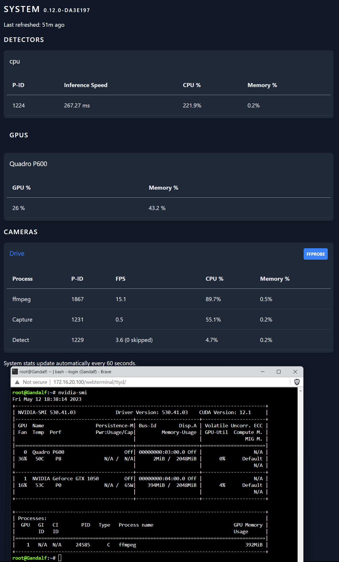

  17. Just a minor one. I have 2 GPUs in my system, a Quadro P600, and a GeForce GTX 1050. I have the 1050 successfully working with Frigate. 'Nvidia-SMI' shows that the 1050 is being used by ffmpeg, but the GUI in Frigate has the P600 listed... Any ideas?
  18. Think I found the issue. There was a missing underscore in the "NVIDIA_VISIBLE_DEVICES" key. Not sure if this is default on the container or if it's something I've accidently done, probably the latter
