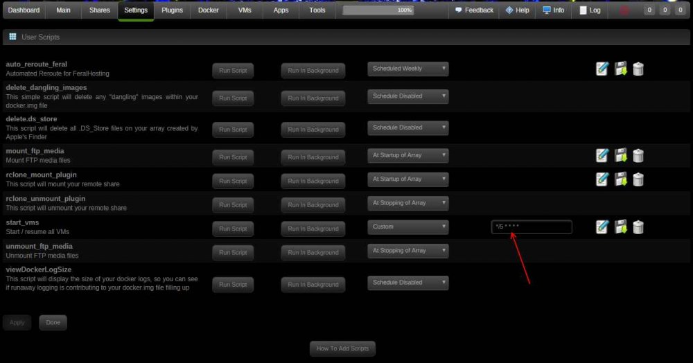

  12. One could also use the cron expression feature of user.plugins for more customization options.
