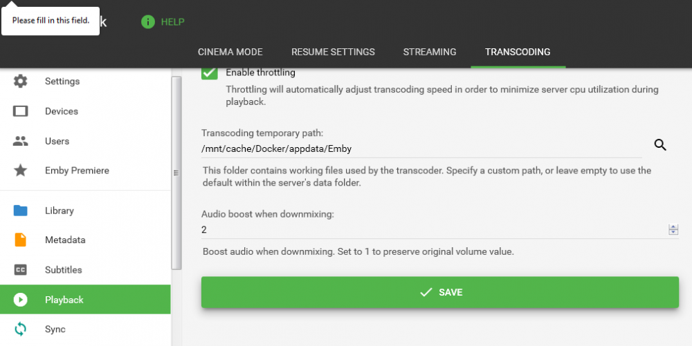

  9. I have a strange issue. When I'm in the manage section, under playback, then transcode. If i try to make any changes and click save. it says "Please fill in this field" but it's pointing to the top left of the screen. i don't see any section that isn't filled out. It won't save, if i move to a different tab and go back it forgets all of my inputs. Anyone else experiencing that? i've tried restarting emby to no avail. I'm on the latest version (3.0.5986.0)
