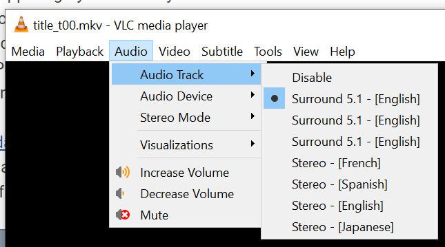

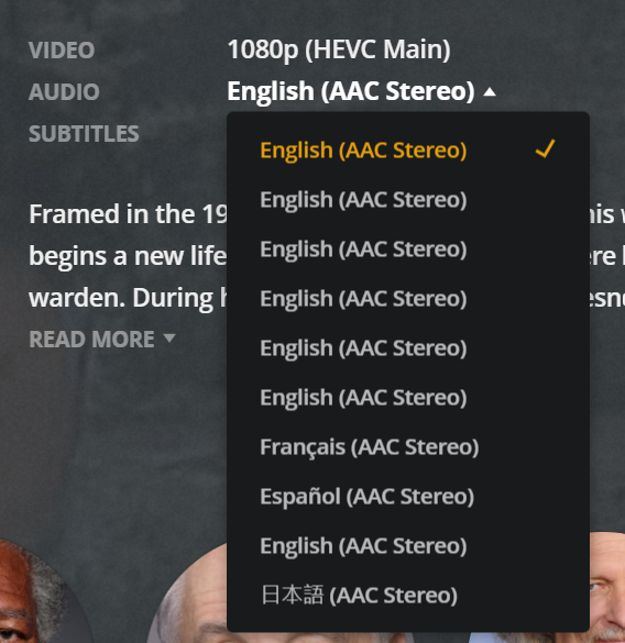

  3. Hey all, I'm back to try to figure out my Unmanic audio weirdness. I'm not sure what's happening, but the screenshots attached show my audio tracks before transcoding (blu-ray rip in VLC) and after Unmanic. You can see that one shows the 5.1 channels as expected (rip), whereas the Unmanic encode shows everything as AAC Stereo. I have Unmanic set to process audio files, but it says it's supposed to keep all the audio channels, re-encoding as AAC, and only create a 2 channel track if one doesn't already exist, so I'm not sure why all my audio tracks are being converted to stereo. I can't imagine I'm the only one running into this. Is everyone else just turning off audio transcoding? Thanks

  7. So after my Unmanic vs Tdarr testing, I've decided to use Tdarr for now. I like the simplicity of Unmanic, but Tdarr supports NVENC, so my encodes there are much faster. Initially I was using Unmanic because the resulting files were significantly smaller than Tdarr's output, but that was until I realized Unmanic was clobbering my audio. Once I disabled the audio transcoding in Unmanic the file sizes between the two were about the same. Besides the faster GPU encoding, I like the control Tdarr gives me through the use of plugins. It was more difficult to get set up and figure out the workflow and what plugins I wanted to use, but now that I've gone through that it seems to be working pretty well.
