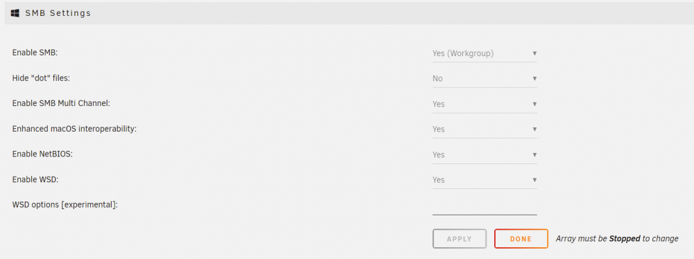

  2. Ok so now it's working! Rolling back by itself didn't fix it, carried on with the same problem. A mixture of NAS firmware changes, disabling WSB in SMB settings - I don't actually know how if this used to be disabled prior but it was currently enabled, maybe this changed with 6.10? I then cycled the array down and a server and NAS reboot or two and we were able to successfully mount again. For tonight I'm going to leave it working, when I have time I'll go through the upgrade to 6.10 again and properly track any changes to SMB settings etc. Thanks very much for your help on it today, much appreciated!

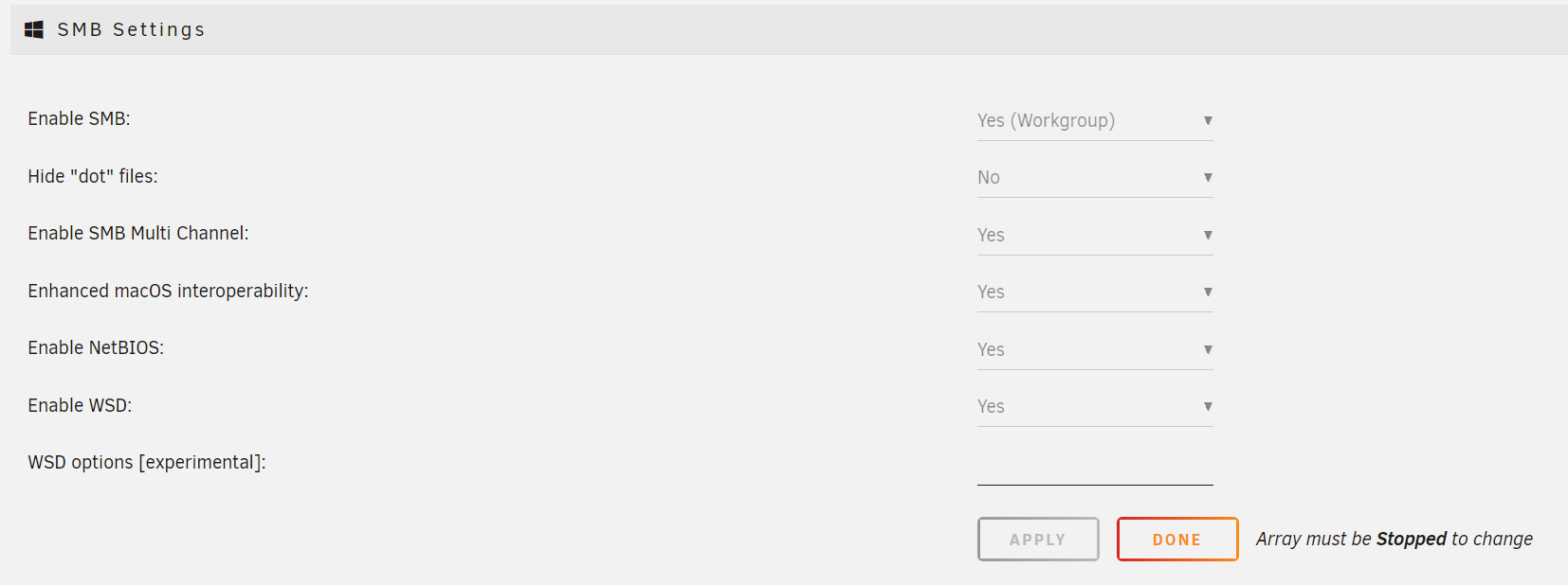

  6. Thanks for the swift reply, unfortunately I already have that option enabled within SMB settings, I've also just restarted the array and saved these settings again and tried again and still no luck.
